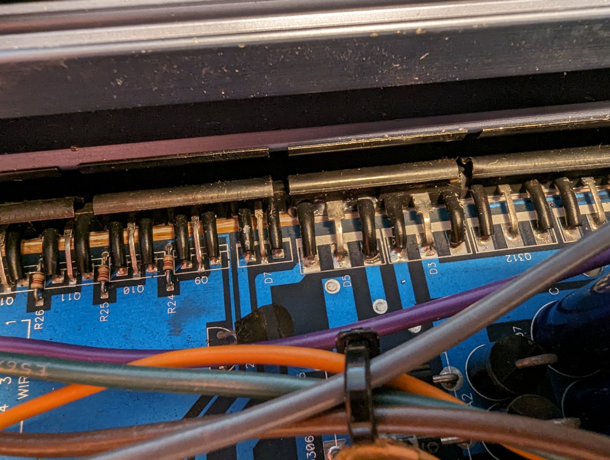

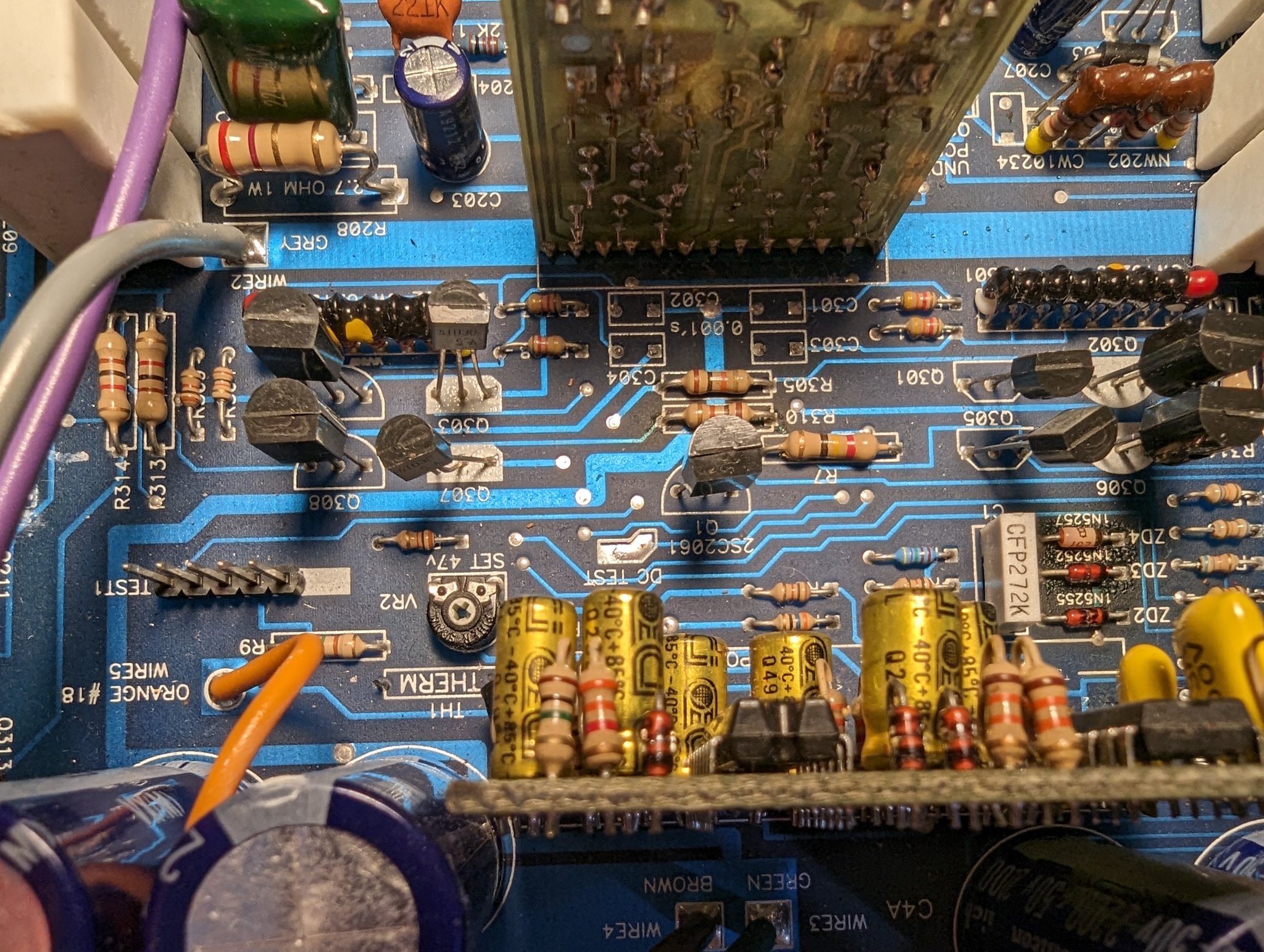

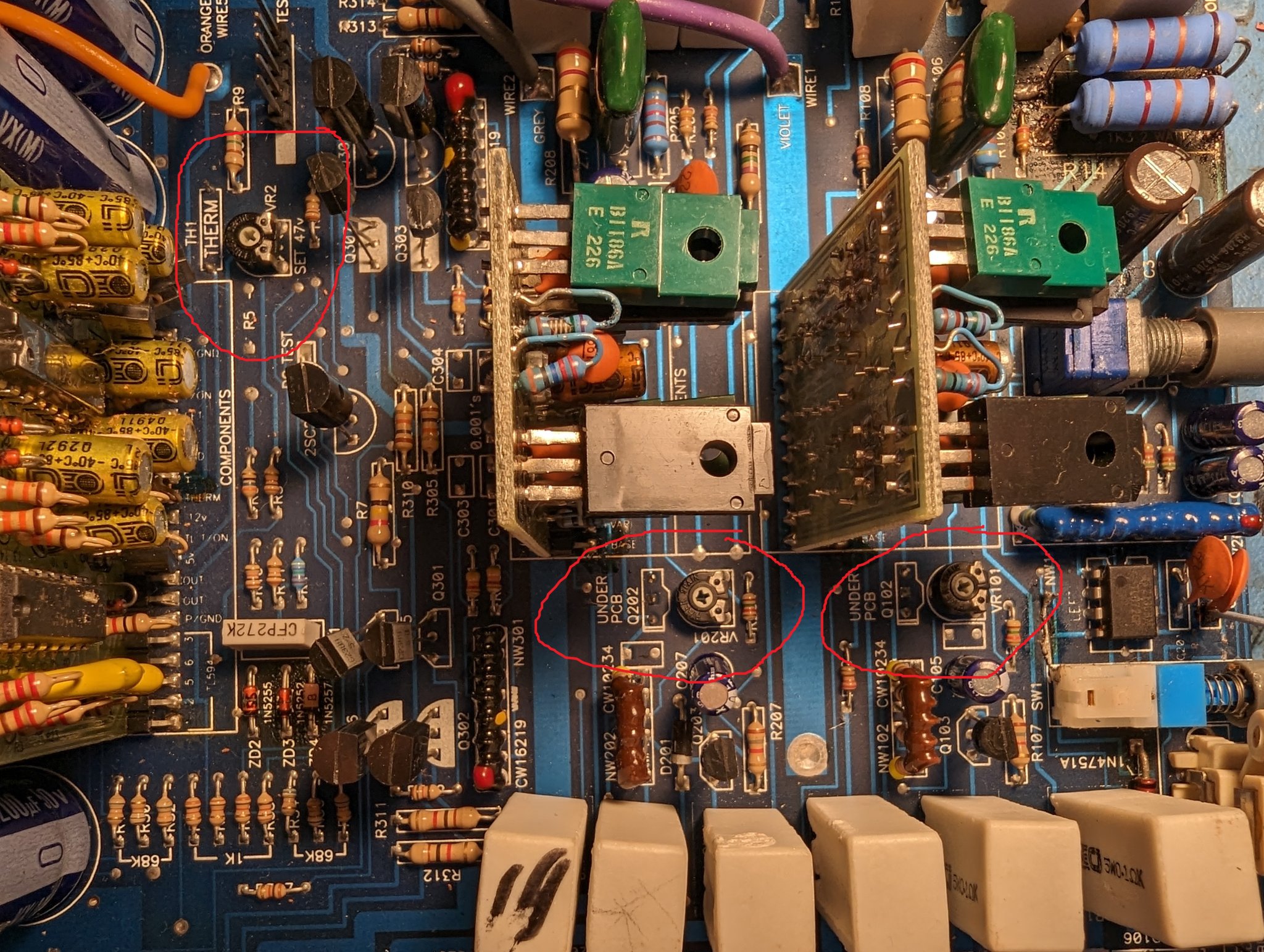

Photo of the board below. Note, VR101, VR201 and VR2. I am still wondering if they need to be adjusted based on all of the parts I changed out 2 yrs ago (at the start of this thread). I read your paragraph above, and not clear/confident on the steps. I am wondering if there is an service manual explination on how to set those 3 pots?

VR2 appears to be the rail voltage target voltage. What's the rail voltage measured from the secondary center-tap to the positive rectifier output?

VR2 says "Set 4.7V" and the test point next to is measures 4.78V

It does say 47V. Not sure why I thought it said 4.7 Either way, the "DC test" (see photo) point next to it measures 4.78V Maybe a different test?

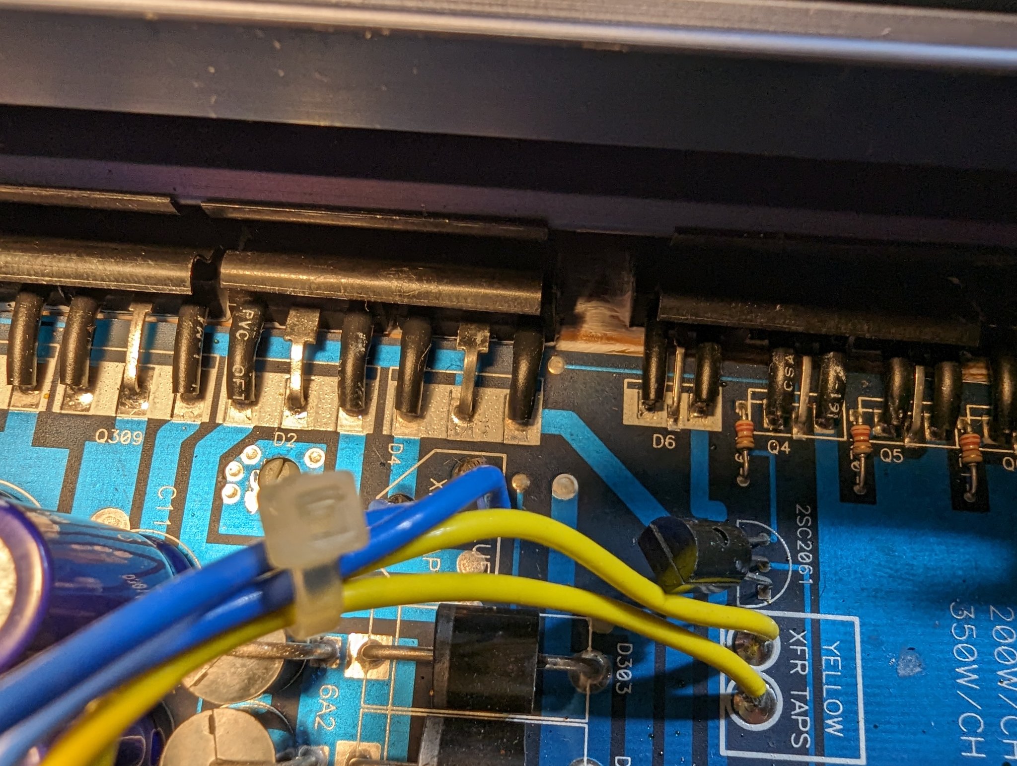

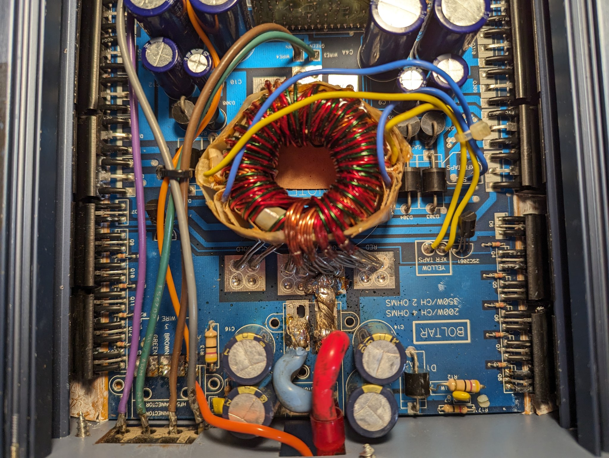

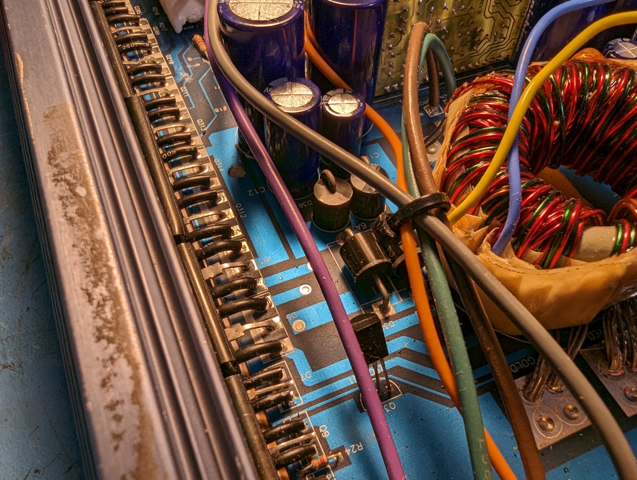

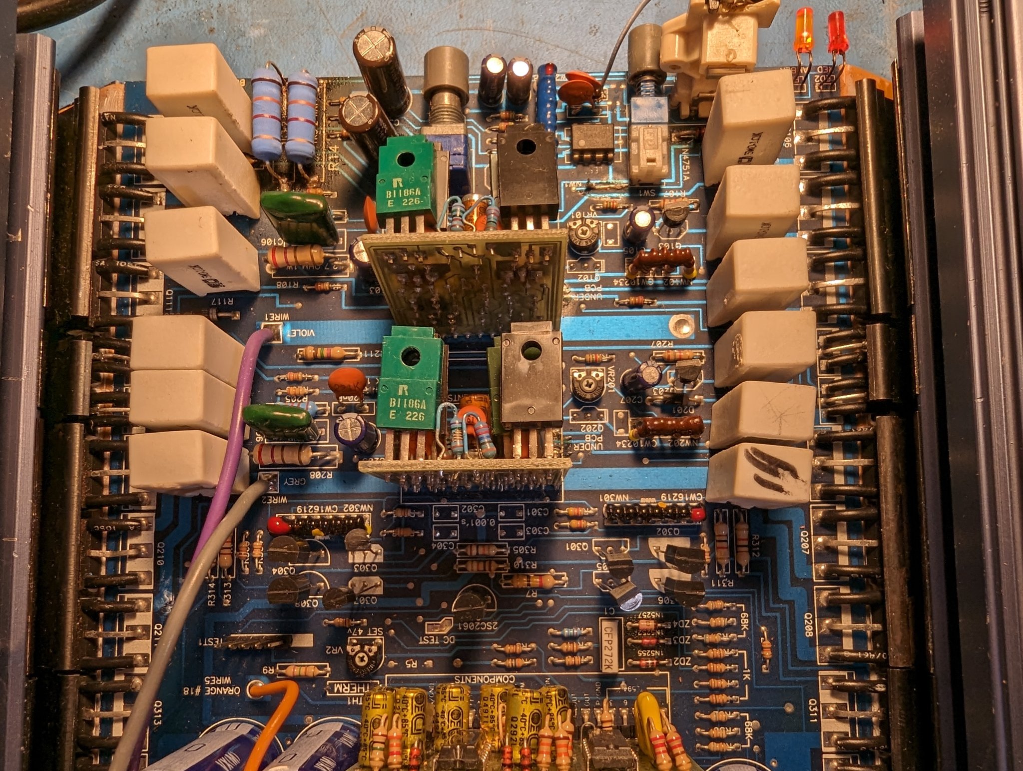

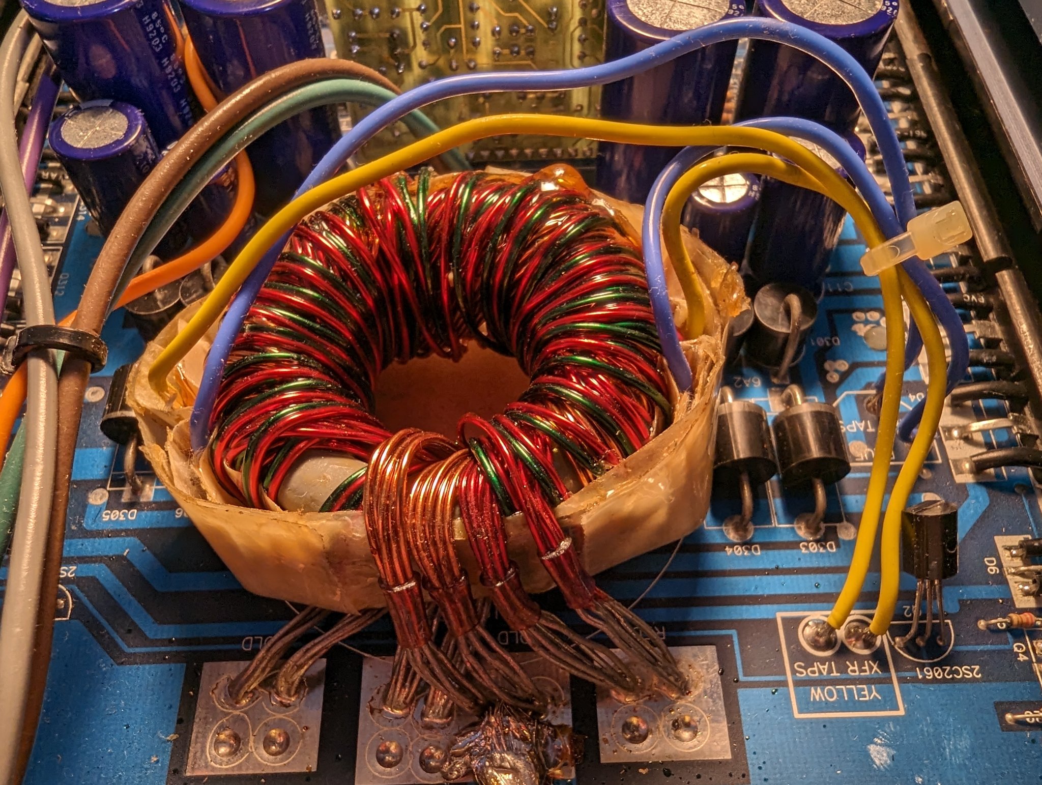

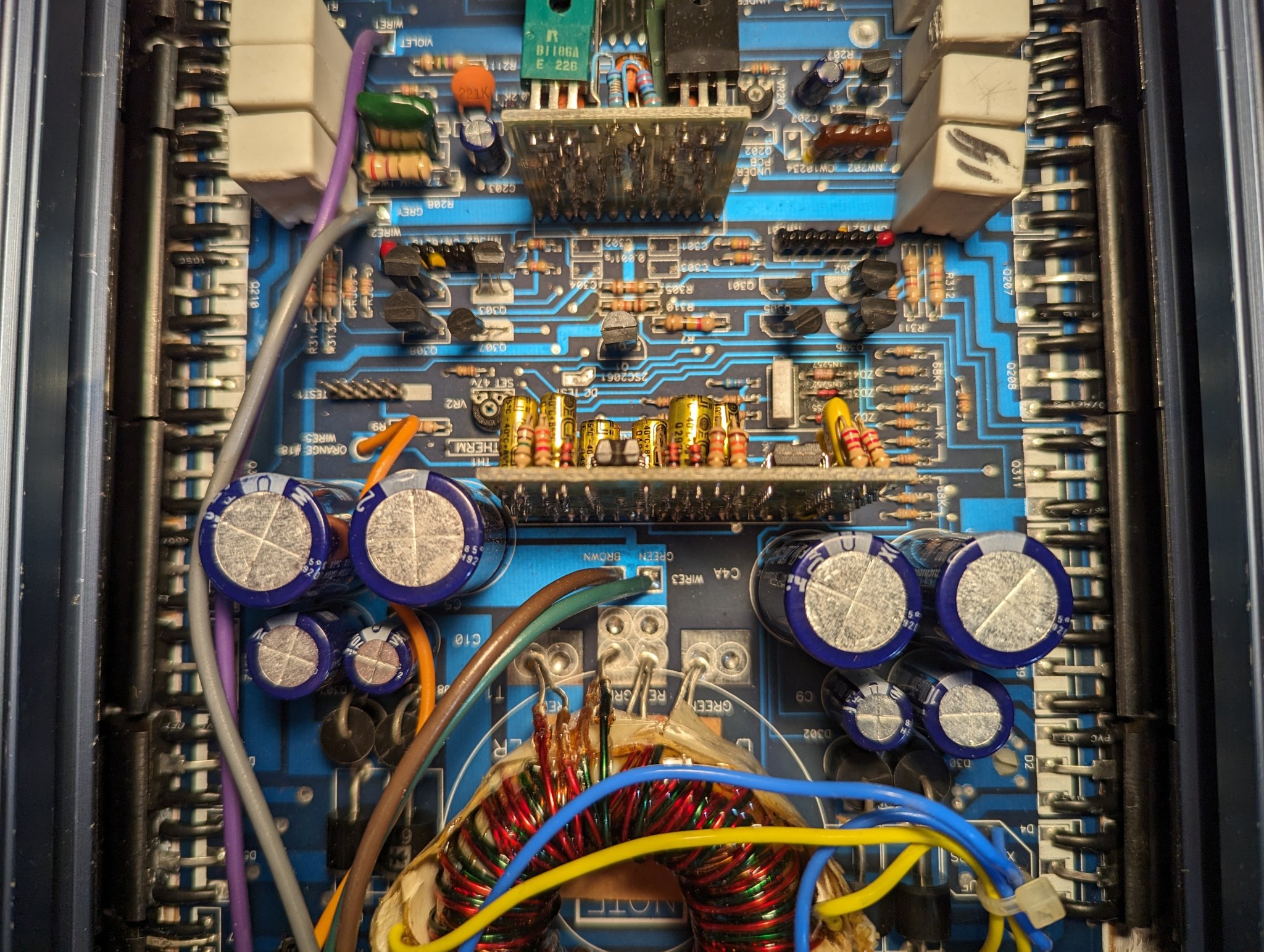

Adding some more photos for clarity.
The DC test is to test the protection circuit.
Measure the rail at the center leg of the large D designated rectifiers clamped to the heatsink. Which one has the highest voltage. Place the black meter probe on the center-tap of the secondary on the transformer.

Typically, the pot is used to set the highest rail voltage (this amp may have 3 rails like the attached photo). 47v seems a bit high for the rails for an amp rated for 100w into 4 ohms.

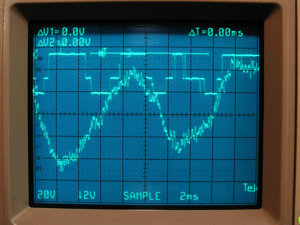

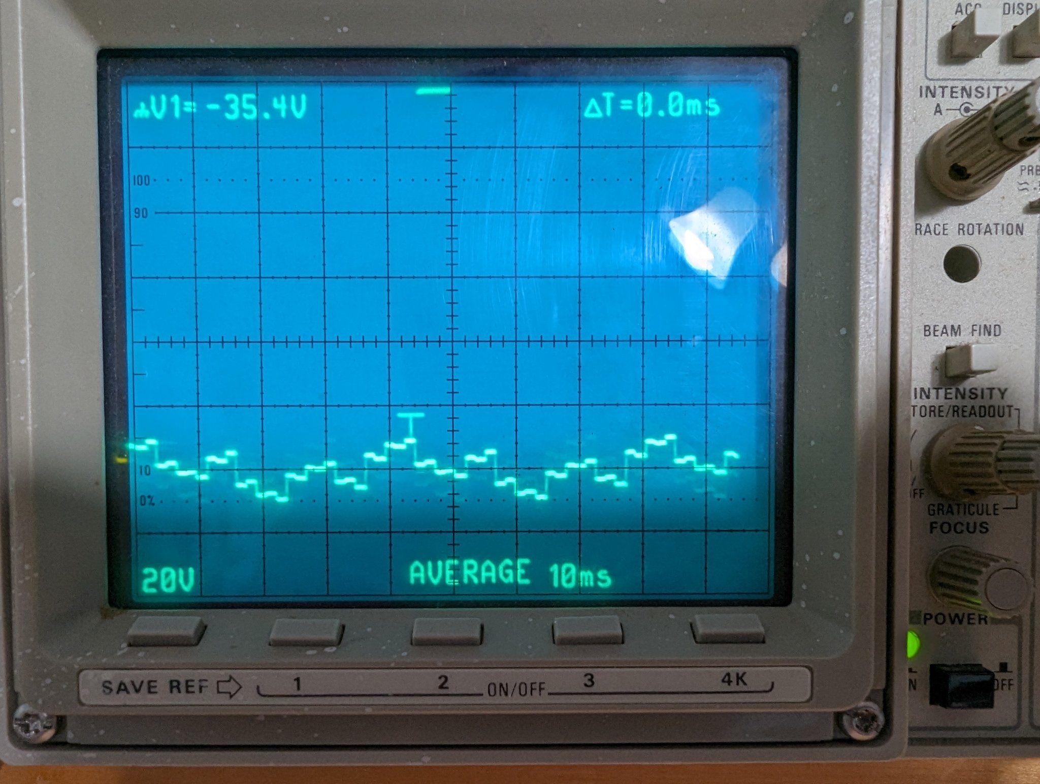

Look at the center leg of the output transistors and drive the amp to clipping (no load required). The rail voltage will likely step up as required when the amp goes to clipping. What's the highest rail voltage?
Ground the scope to the secondary CT.

The center pin on all of the output transistors are common on each side of the board, so I don't think this is a 3 rail system.

It appears to have a rail voltage of about 50v (assuming that the scope is generally in calibration and the trace was aligned with the reference before the image was taken). You don't show where the signal clips so I can't know how much loss there is in the rail switching circuit and drive circuits.
Unless otherwise told, I'd leave the rail set point as is.
