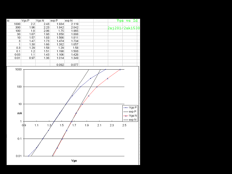

weak inversion
Hi Andrew,
As I said already, I don't have the raw data of the Philips IRF640, but maybe you (and others) are interested in my measurement on the 2SJ201/2SK1530 (see below). Up to 30mA the figures are almost perfect exponential. From 100mA and higher they clearly deviate from the exponential relationship.
Cheers, Edmond.
PS: Maybe somebody else is willing to make a nice graph from these data (using splines) together with a true exponential curve and a quadratic one, as I'm not the mood to fiddle around with MatLab.

still not getting Irfanview to give the output I need, but hopefully this is legible.
Note the Pch drop away from exp @ 10uA. but just a hint for the Nch.
and that the Nchannel move away from exp much earlier @ >3mA.
Is there any significance in the difference in slope, 0.092 vs 0.077?

estuart said:Hi Andy,
Thank you very much for these links. Very informative and useful. Probably I'll also switch to EKV. Far less parameters that make you mad.
Are you extracting the parameters for the 2SJ201/2SK1530 pair as well?
Anyhow, keep us informed about your progress, please.
Cheers, Edmond.
