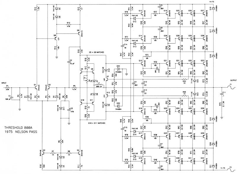

Hav'nt seen this kind of "mosfet" (hex i my case irfp somethng) stage anywhere..

Is it because it's cräp or did I not search enough or did I do a useful thing for a change?..
I'm using it and I'm pleased with the sound hmm there's a bunch of theories that made me connect them in that way a while ago.. something with current and linearity in the component.. hmm or I might have misunderstood the datasheet hmm

that looks like a cascode that swings with output voltage.
It reduces the voltage across any device by about 50% compared to the non-cascoded version.
See Leach super amp or Nelson's own circuit for BJT versions.

It is called usually "totem pole" and was used before, especially when higher voltage transistors were not available. My Creek 5350 design (and A52 before that) also used a similar configuration in the output stage, thought it was N-channel only. It is an alternative to paralleling devices to dissipate more power and I found it is better than a parallel connection for MOSFETs as it keeps only one pair of devices in control of the output.

This kind of arrangement is also used in Class-G amps, in that case SOA safety is much more extended also......

Class G makes use of switching between different rail voltages and that makes it much more efficient. Here we deal with a usual class AB and a dual rail arrangement.

I haven't seen this with MOSFETs either, but it is a useful configuration, as others here have mentioned. I believe that Bryston still uses it to this day in their hi-powered amps. It originated in earlier times when SOA of output transistors was not as good as it is today. By halving the voltage across the output transistors, it helps SOA a lot. It also has a partial cascode benefit AND it also has a partial benefit of shielding the inner output transistors (that really do the audio work) from garbage on the power supply rails by a factor of about two.

It has been used with some enthusiasm:
www.passlabs.com/np/800a_schem.tif

Bryston use something different which is a combination of emitter
follower and CFP in the same OP stage. Their config is quite unique.
I'm thinking the cascoded OP stage isn't very popular probably due
to the fact that it really eats into headroom which is precious in the
OP stage.

If the supply voltage is that high then the loss of an extra couple of volts is hardly noticed.Terry Demol said:
I'm thinking the cascoded OP stage isn't very popular probably due to the fact that it really eats into headroom which is precious in the OP stage.
Compare that to the same two transistors in parallel operating from half the supply voltage. The losses here will be higher and the result will be less overhead.

Yes and no. In their lower power amplifiers they use a single level of output transistors, but they are arranged in a rather unique composite emitter-follower/CFP configuration. However, when they go to their higher power amplifiers, they insert another layer of output transistors in series. That's what I was referring to. You are right in that what is in those layers is not just a simple emitter follower structure.

So they still use the CFP+EF but insert a cascoded ollower 'above'
this whole OP structure.
To me it does seem like added complexity for relatively small gain.
I would think that the current modulation due to OP load causes
way more non linearity than voltage modulation across OP
devices.
One thing it would do is give much higher PSRR for OP stage
(sans FB), maybe that is a design motivation.
