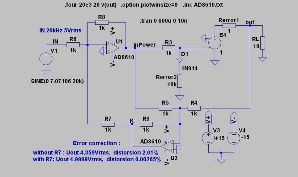

powerbecker said:Hello,
a bit tiresome the theoretical reflection, here a try bare any mathematics...worked though![]()
Regards
Heinz!
Thanks Heinz
Elegantly simple demonstration of the need for unity loop gain across the summers if error cancellation is to occur.
Excellent!

Just post the zipped schematic and op amp models. Cheers

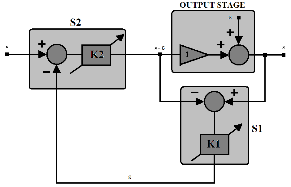

mikeks said:The following, with non-ideal summers included, is my preferred understanding of error correction as described by Robert Cordell:
Could not K2 be omitted inside the S2 box since the S2 summing point is actually only a resistor which is perfectly linear?
Cheers Michael
A positive feedback loop is equivalent mathmatically to a gain. There is no argument possible. So why debate it? Why add all this noise, Mike?
Wouldn't it be more useful to discuss the pros and cons of implementing a gain block using a positive feedback loop instead of an amplifing device?
mikeks said:On reflection, Heinz, i think your results are not reproducible, unless i am doing something wrong, or using an inferior model?
Check it out:
Sorry to all, Mike , you are right!
Distorsion go down from 2% to only 0.026%!
That is "only" about 75 times less.
My mistake was wrong reading
![dead :dead: :dead:](https://files.diyaudio.com/forums/images/smilies/dead.gif)
Regards
Heinz!
