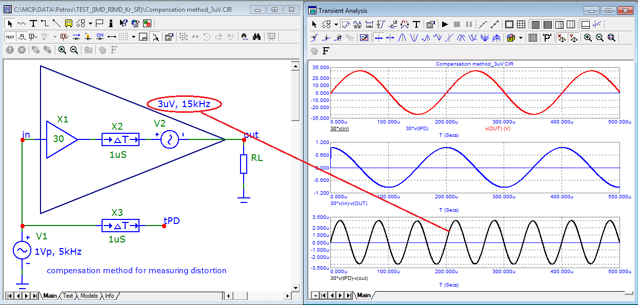

Nice write up. I sort of understand what you are driving at. Its the same as looking a settling time. Settling time is a complex function of low level and large signal performance and is not easily predicted in simulations. Measuring settling time to low levels is difficult. The basic circuit is straightforward but the dynamic range of the measuring system is a limit. Clamp diodes and other tricks are necessary if you don't have a Tektronix 7a13 for signal conditioning.
You don't need to predict anything, you just need to measure.
There are no restrictions in the simulator, it can be used as a magnifying glass of any resolution, up to the resolution of a microscope.
best regards
Petr
here is the microscope mode

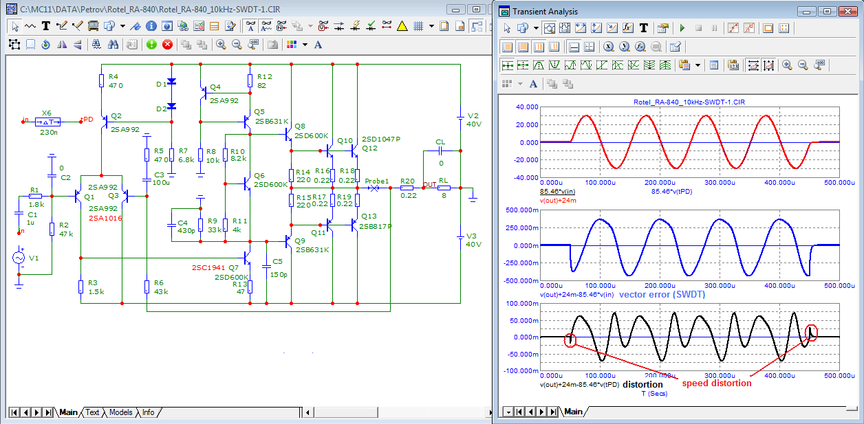

Vector errors are inherent in all amplifiers without exception, the magnitude of vector errors depends only on the signal propagation delay from input to output (Group Delay).
In the first period and at the end of the last period in the burst, in addition to vector errors in most amplifiers, additional distortion occurs, which I called "speed" distortion.
In the generally accepted classification of distortions, this type of distortion does not exist, since no one has tried to detect and classify them. I understand that this is not quite a suitable name, but they are to a certain extent related to the speed parameter time Propagation Delay (tPD).

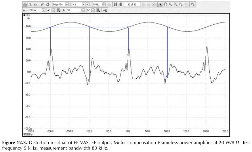

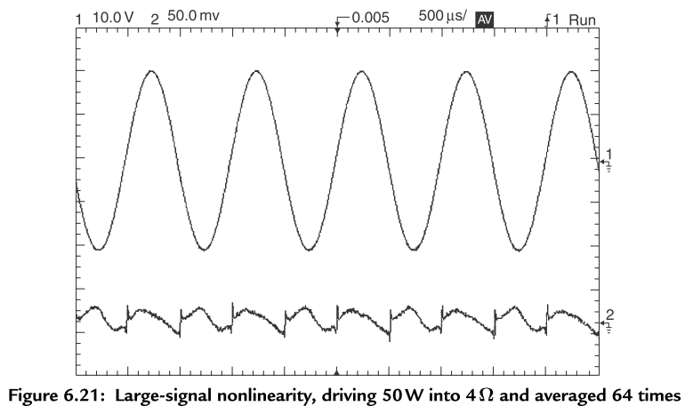

There are many examples of crossover distortion in Douglas Self's books, here are some of them.

Here is the work of the amp model that was mentioned in the 10 year old thread.
It also has a Loop Gain at a frequency of 20 kHz of only 30 dB, does not require an inductance at the output to ensure stable operation.
The signal propagation delay time is relatively large, 2 times higher than required by calculation. Nevertheless, high-speed distortions are small compared to non-linear distortions (the peak value does not exceed 25 mV) and are of a short-term nature.
Best regards
Petr

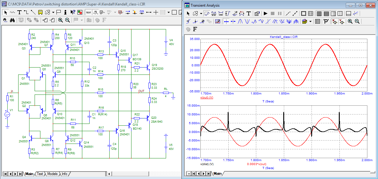

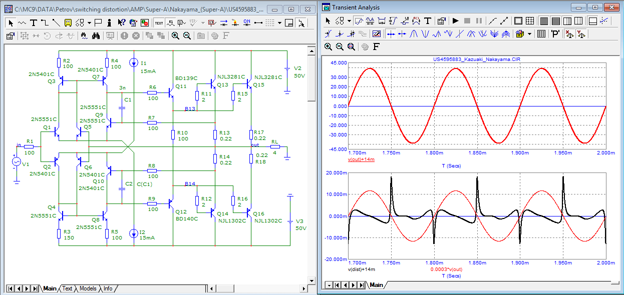

bonsai, here are a couple of attempts to combat switching distortion. As you can see the problem is not solved.
Settling time and signal voltage are completely different concepts.

Further, in your diagrams you’re subtracting a stimulus signal from an output signal starting at zero time, seeing a differential and then calling it speed distortion. This is plain wrong. As pointed out earlier, integrators show this same behavior but it’s quite well understood and not treated as a fundamental flaw of integrators- it’s just good old fashioned physics That in the end, will deter how things work.
Bonsai, I do not do anything contrary to the physics of the ongoing processes and use only two simple mathematical operations: multiplication and subtraction. The rest is done by the mathematical apparatus of the simulator.
Those who try to refute what I'm doing without presenting me with any arguments are the same as trying to prove to me that 4-2 = 3 or 2x2 = 5
