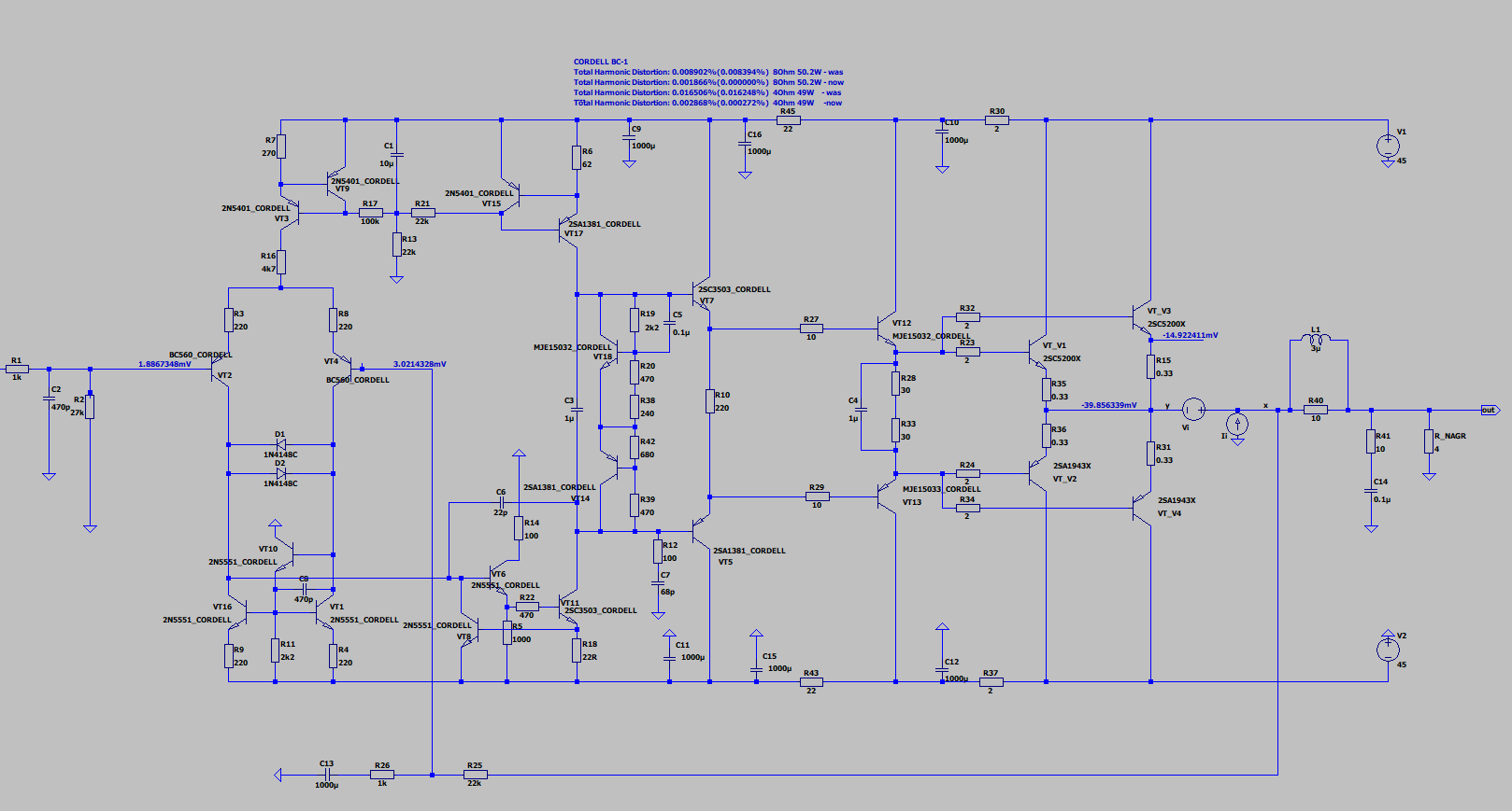

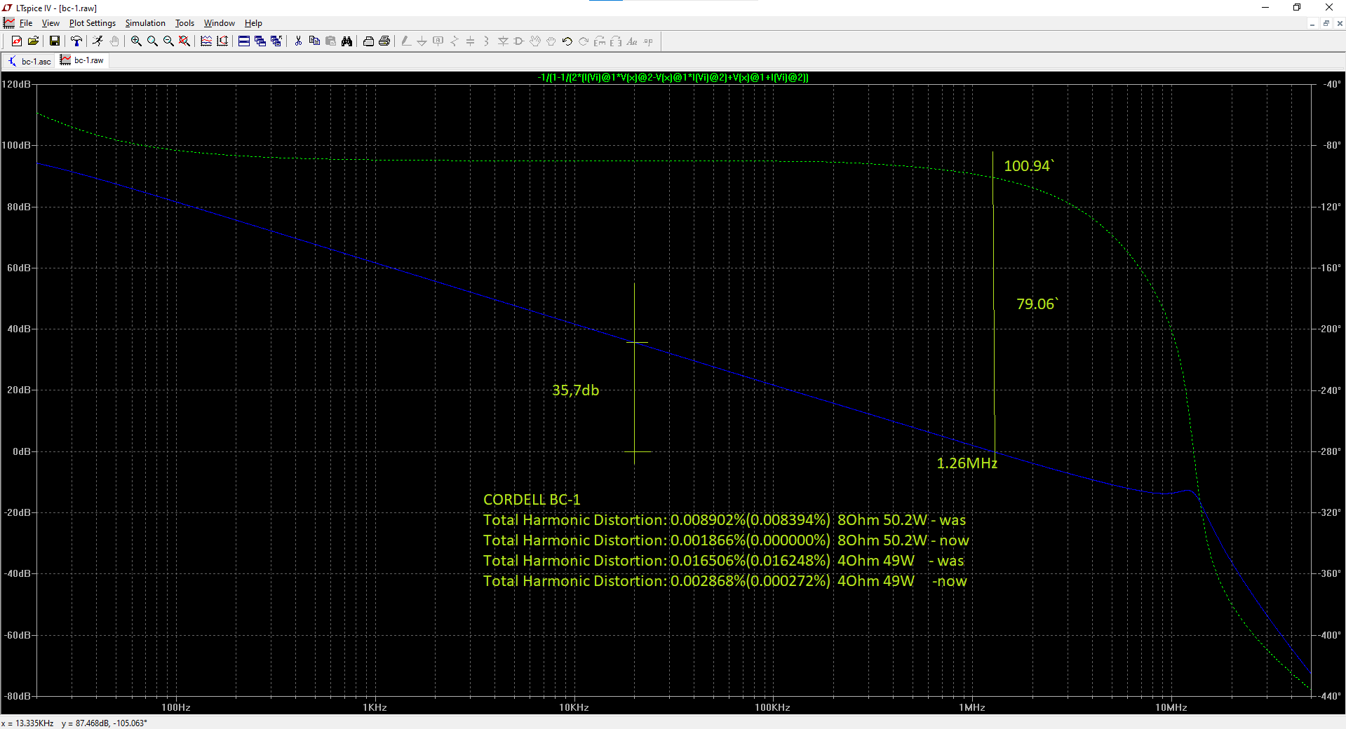

I posted my sim file in the first postso the last normal modification of the working circuit will not be here?))

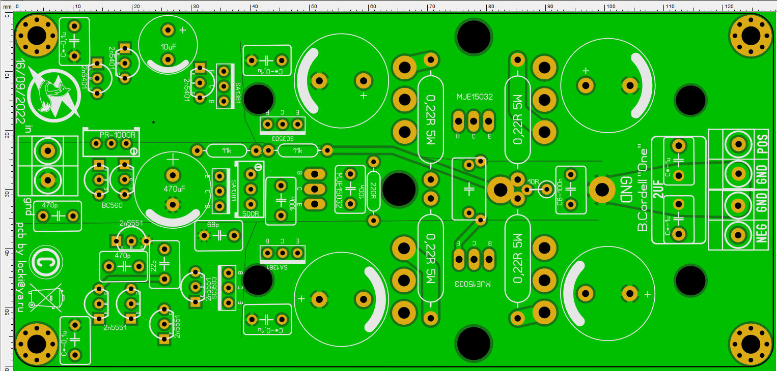

Snubbers in the PS card. Is it correct that only on of the set snubbers; c7.8, c13,14 ( over rectifiers ) or c1,c2, r1 and c18, c19, r6 ( parallel with secondaries ) are used. and not both?
If any of previous builders has used the snubbers parallel with secondaries, what was the component values? I plan to measure myself and understands it depends on the chosen transformer.
