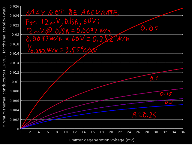

I made a graph to show how degeneration affects thermal stability. It works for any package, insulator, heatsink, voltage, current, Re or Vdegen scenario. You'll have to look at it a bit to figure out how to use it. The thermal resistance you get from this chart is the minimum stable value for Rjh (junction to heatsink), or if you are not using thermal compensation, Rja (junction to room/ambient temp). It is based on the threshold of instability for the thermal circuit. And it may be wrong so it would be nice if someone would check it.
The result given by this chart is the absolute minimum for stability. Even if it's stable, circuits close to the threshold will experience significant thermal drift during operation. So the margin should not be just +20% for instance, but rather a multiple of five or so depending on how much drift is acceptable while the thermal compensation is catching up, and that may be the subject for another chart).
There are exceptions to this behavior. One is an EF stage without paralleled outputs and a Vbe multiplier feedback loop. The Vbe multiplier cancels the tempco of the output bias. However within the feedback delay window, the crossover bias will experience more fluctuation if there is less degeneration. Transistors with built-in thermal diodes for compensation are ideal for this since they reduce the thermal feedback lag.
When temperature feedback such as a thermally coupled Vbe multiplier is used, overall thermal runaway is usually not the main problem. The problem is when multiple outputs are in parallel, because the Vbe multiplier doesn't pay attention to differences between individual transistors. So one transistor will turn off as another one turns on.
Another exception is an output stage with paralleled outputs where each complimentary output pair has it's own thermal compensation loop. This will prevent both thermal runaway and current hogging depending on how well-matched the sensing transistor tempco is to the power transistor tempco.
