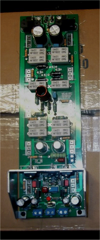

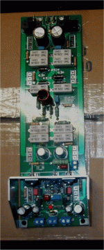

You hit the nail right on the head.
DIY'ers will build a TH project .... very few , if any will attempt SMD.
(below) NO SMD , just 6 resistor types / 6 semi types . Designed for
fat fingers.
Even designs with more than 16 semi's for the input stage are not
as popular. The parts count has to be where the builder can do it
in hours (not days). Attention span is key here.
I would consider a pre-assembled SMD input stage ,
but never a whole amp! No one would build it.

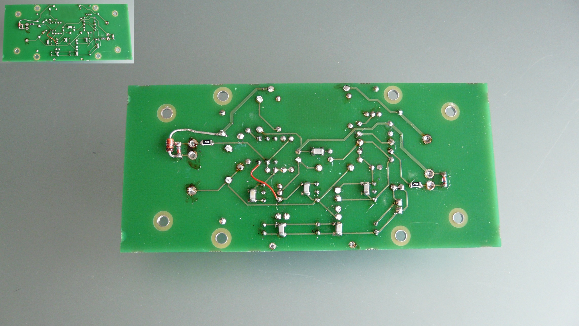

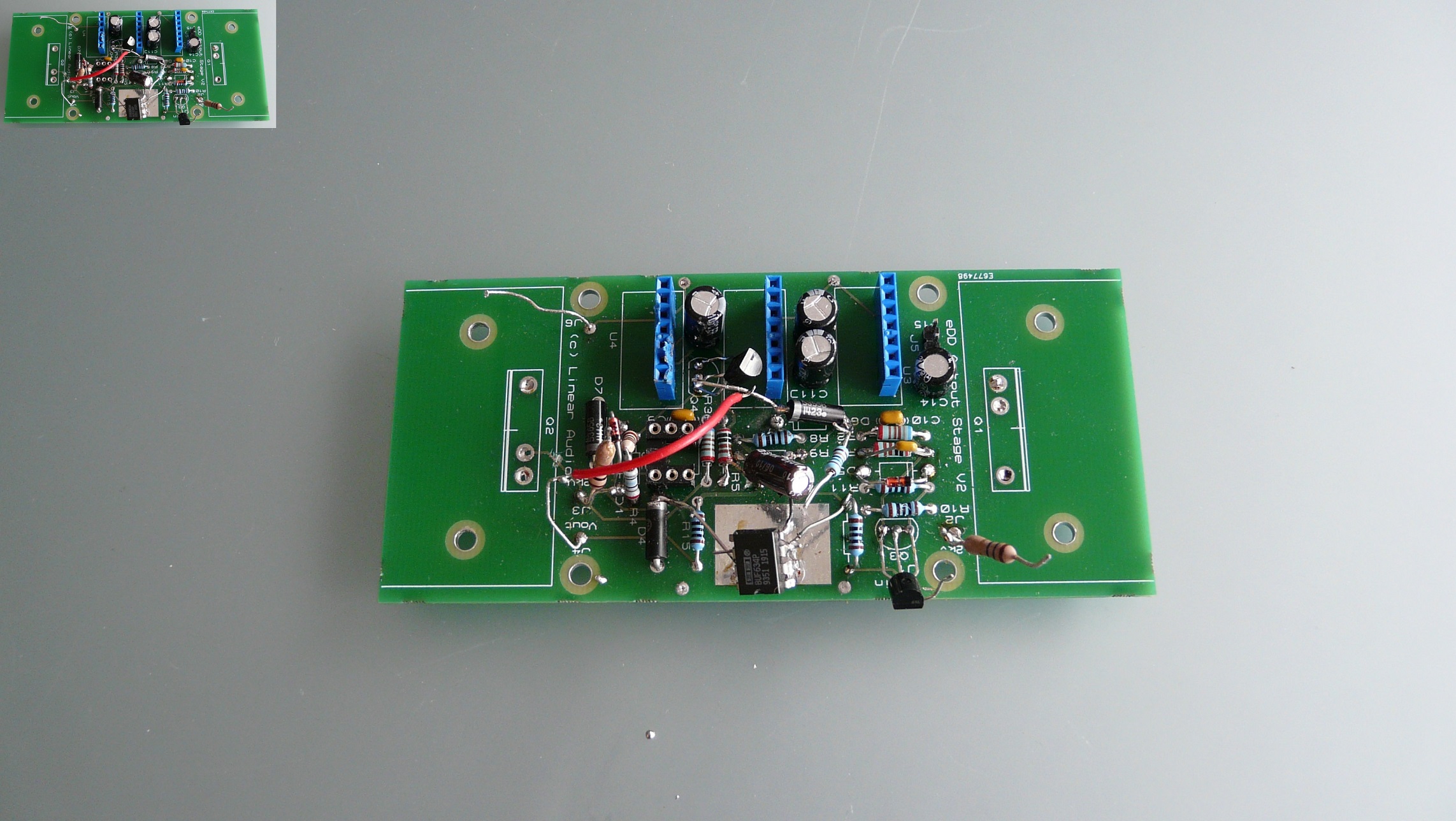

I am using SMD decoupling caps (1u, 50V, 1206 size) on the back of a board right at the pins of pamps, also SMD R's right at the gate pin of FETs. That sort of thing. In my view those are cases where SMD can actually improve performance. But I agree Richard, there's no general solution, you have to pick and chose the best technology for a specific case. SMD adds another choice to the palette.
I doubt SMD will make a difference in performance in audio electronics where you barely hit 1MHz and low gain. In the 80s, I designed discrete transimpedance amp and RF amp of 300MHz BW using TH transistors, resistors and capacitors. It's all on the layout, how much knowledge and care one puts in. SMD does not make up sloppy layout.
It's only above 300MHz into UHF that's when it get dicey with TH components. I doubt 1206 size has much advantage over a TH component. It's too big and has enough parasitic. If I go into SMD, it's going to be 0603 or 0402 for capacitors and 0603 for resistors. that's when SMD shines.
Luckily, the kind of circuit we work on in this forum are all low impedance circuits, nothing over 50K or so. Or else you need to be careful about surface contamination that cause leakage. SMD can trap dirt under the components and create a leakage path. I just designed a 100MV/A 3uS settling to 0.1% transimpedance circuit that the feed back resistor is 2512. I actually had to put a crater under the resistor so the resistor would not touch the surface of the pcb and trap dirt. If I have enough clearance, I would definitely use TH resistor.
In audio circuits like this, we don't push the high impedance and high frequency by any stretch, I really don't think component size has much to do with performance.
Well the SMD is on the bottom side and right up the pins, saving space on top, makes for a much or compact PCB, better all around. Once you go that way you'll see more an more advantages accrueing.
