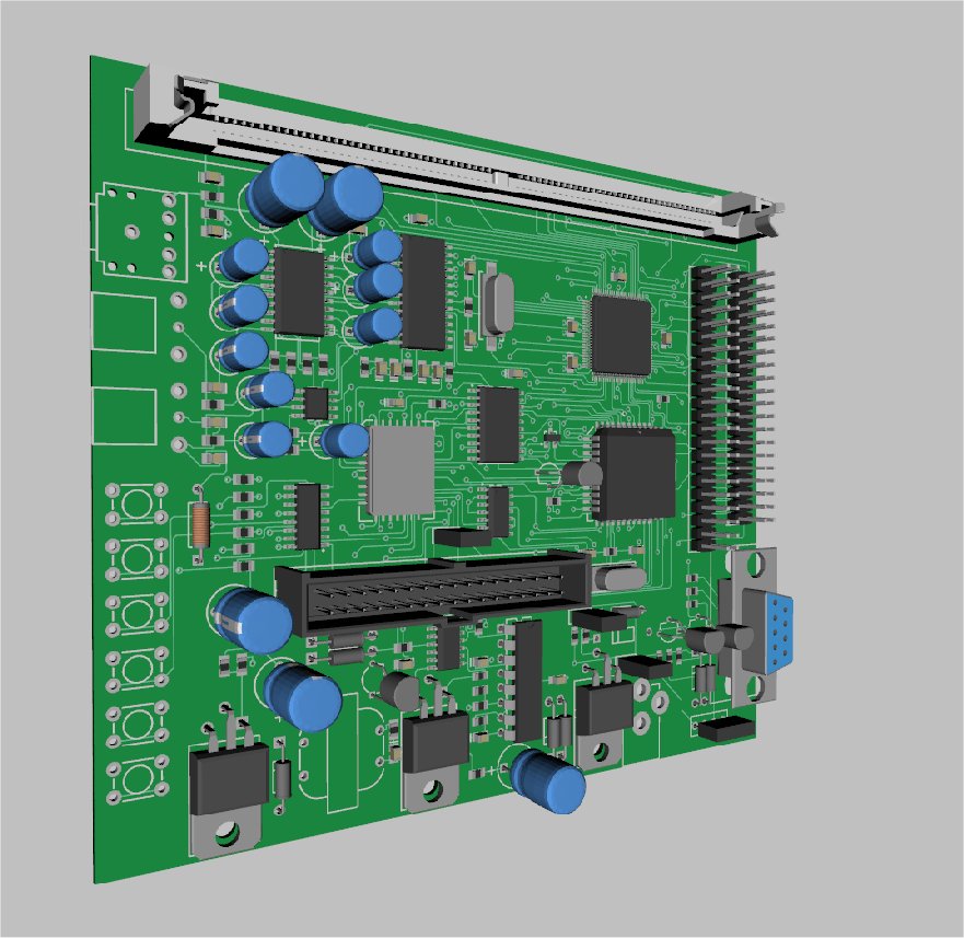

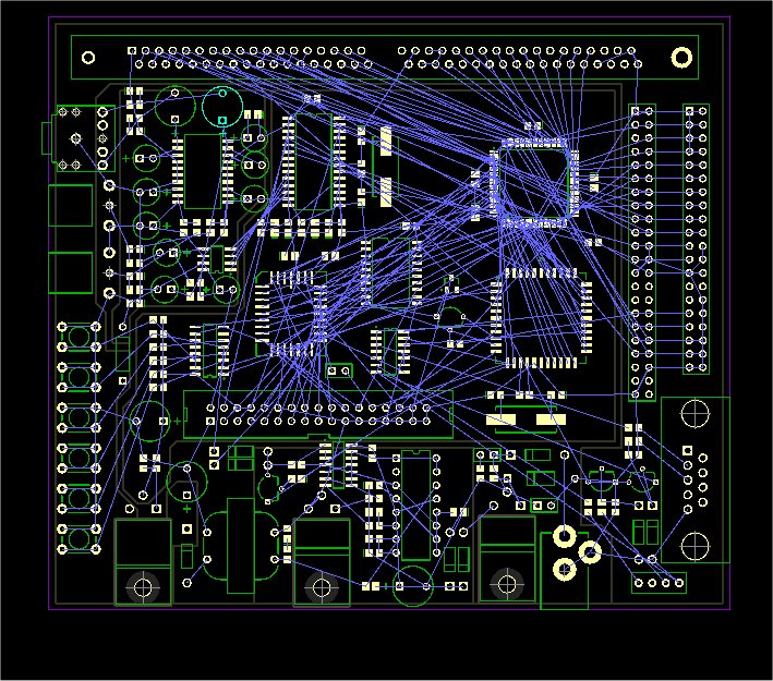

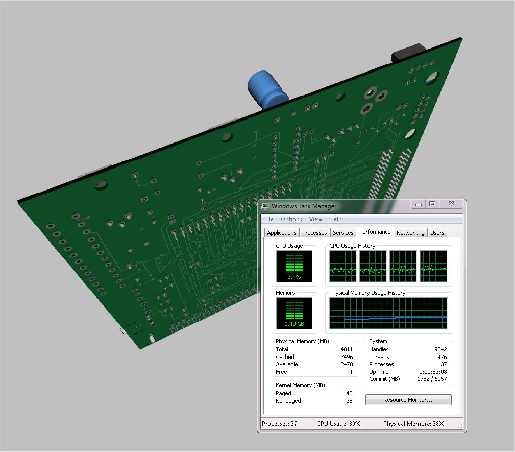

(Below 1-3) ran it through its paces.
- you need 2gig for everything.
-autorouting would use just one processor.
-3d rendering really likes a "real video card" (not onboard) and
a quad core processor. 39-45% of all 4 cores. (pix 3)
Yes , anything mixed digital/analog , like an amp with protection circuits ...
or a complex line stage// filter - Diptrace is the CAD !!
OS
