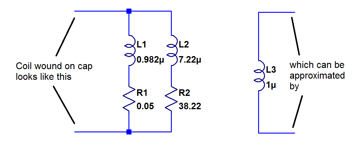

A bit about output inductors wound around caps
The Dynaco Stereo 120 made its output inductor by winding wire around C7, the output coupling capacitor. It was a single rail design.
The original inductor is 74 inches of 16 AWG insulated solid wire wrapped around C7, a 2" diameter capacitor. Using the Wheeler formula, that calculates out to about 5 uH or so. Actual measurements show a lot closer to 1.0 uH. What's going on?
Recall that the coil is wrapped around the cap. The cap consists of two rolled up conductive sheets separated by a dielectric. It looks like a loosely coupled one turn secondary to the primary of the speaker inductor wrapped around the cap. That reflected impedance drops the inductance, making it much less than you'd expect. I took network analyzer measurements and fitted a model in the region from 1kHz to 10 MHz. The model looked like the enclosed picture.

using the capacitor as a temporary bobbin has the big advantage that it gives a large diamter coil and this will require fewer Turns. This will get closer to that 4:1 ratio and will result in lower resistance................I think Dan Meyer's approach to winding the output coil on the electrolytics has been pretty much considered to have been a really bad idea.
The aluminum capacitor body probably shields the cap internals quite well while providing a solid shorted turn to the windings.

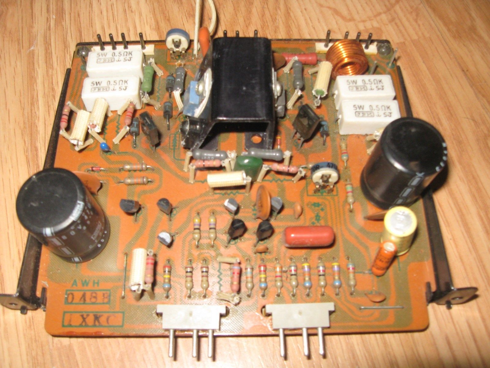

now that the topic is being discussed here, i think it is a good idea to put it in your book....
to be honest, i never followed Dan Meyer's coil suggestion, i installed them right at the speaker binding posts....
In H/K integrated amps there is clear brownish stuff melted onto the coils that seems to be rosin. I actually melted some of it off to use it on another coil! Easy to do with a lighter.
i used shrinkable tubing in some of my coils....
![IMG_3466a_zps83982157.jpg](https://i5.photobucket.com/albums/y155/leoman53/hone%20badger/IMG_3466a_zps83982157.jpg)
