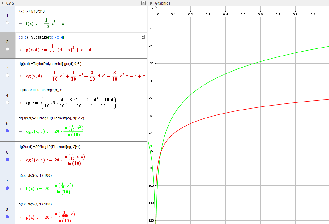

every now and then I try to use a Computer Algebra System - GeoGebra here has a weak Symbolic Algebra SW, but its free - its more aimed at middle/high school than EE
assume a centered VC with 10% full scale 3rd order distortion
add a d_x and expand as a Taylor Series, plot for d= 1/100
(note that the power of each x is dropped by 1 to normalize the distortion number)
see that very low 2nd does dominate, but that the intercept for 3rd crossing 2nd is way down -80dB

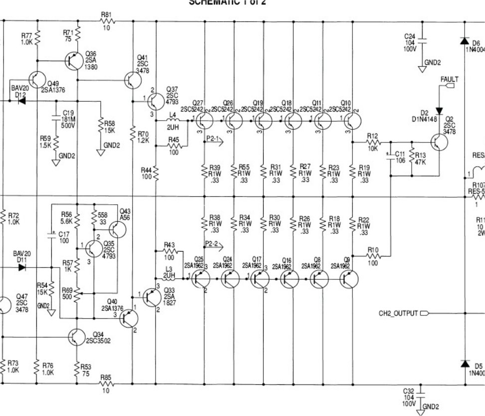

HK uses a paralleled R/L to drive it's outputs - NO basestoppers.
(below) ... HK1.5 signature EF3.
I don't think they match the OP's (according to the manual).
Is the R/L acting as a basestopper at audio frequencies ?
OS
That's a base stopper exactly where it should be: at HF. HF in terms of around the ULGF, not at audio frequencies. An OPS without base stoppers won't oscillate in the audio band. The LC technique may also improve the thermal stability, since there's no base stopper to reflect (divided by beta) in the emitter, at DC.
