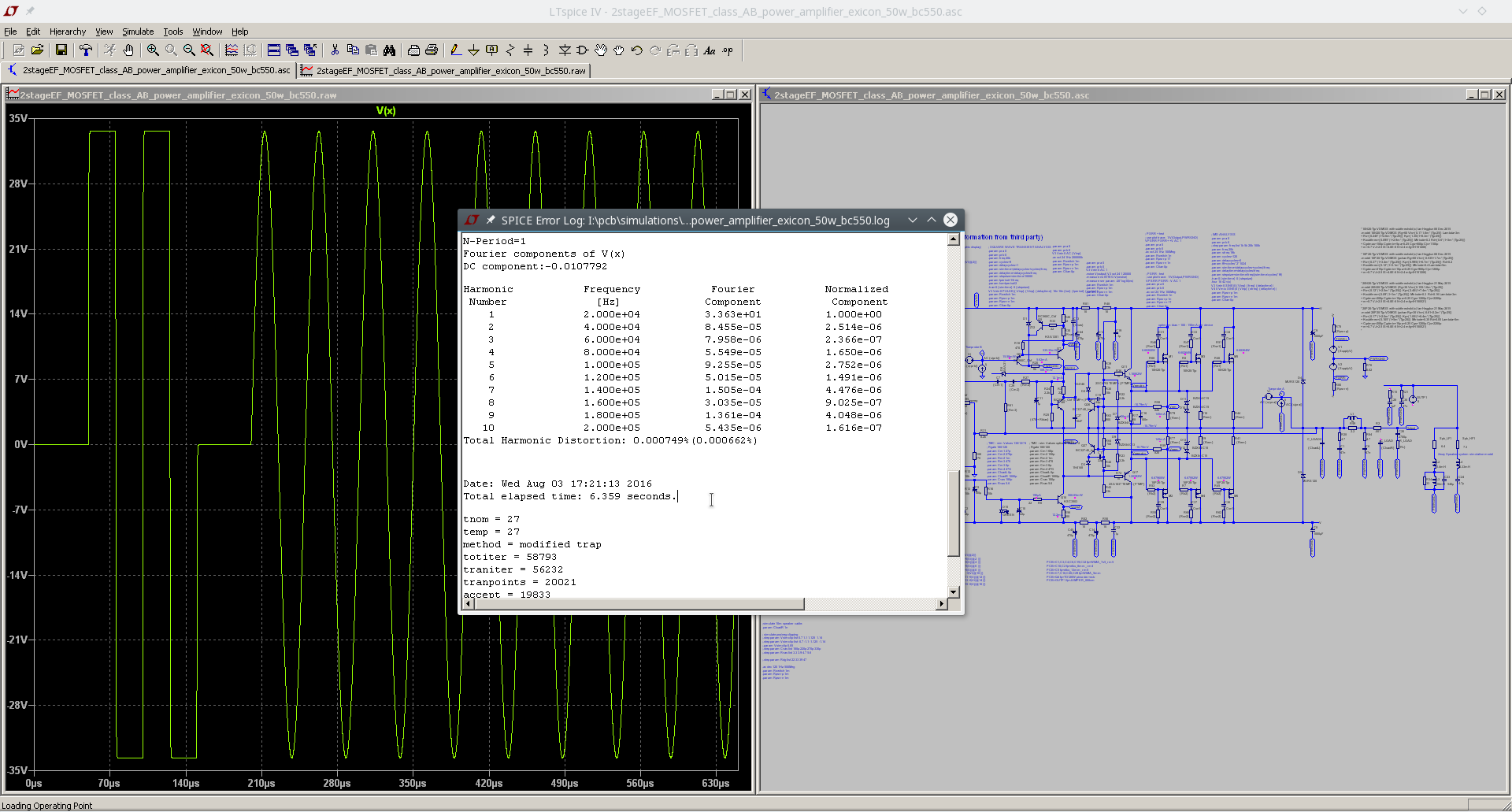

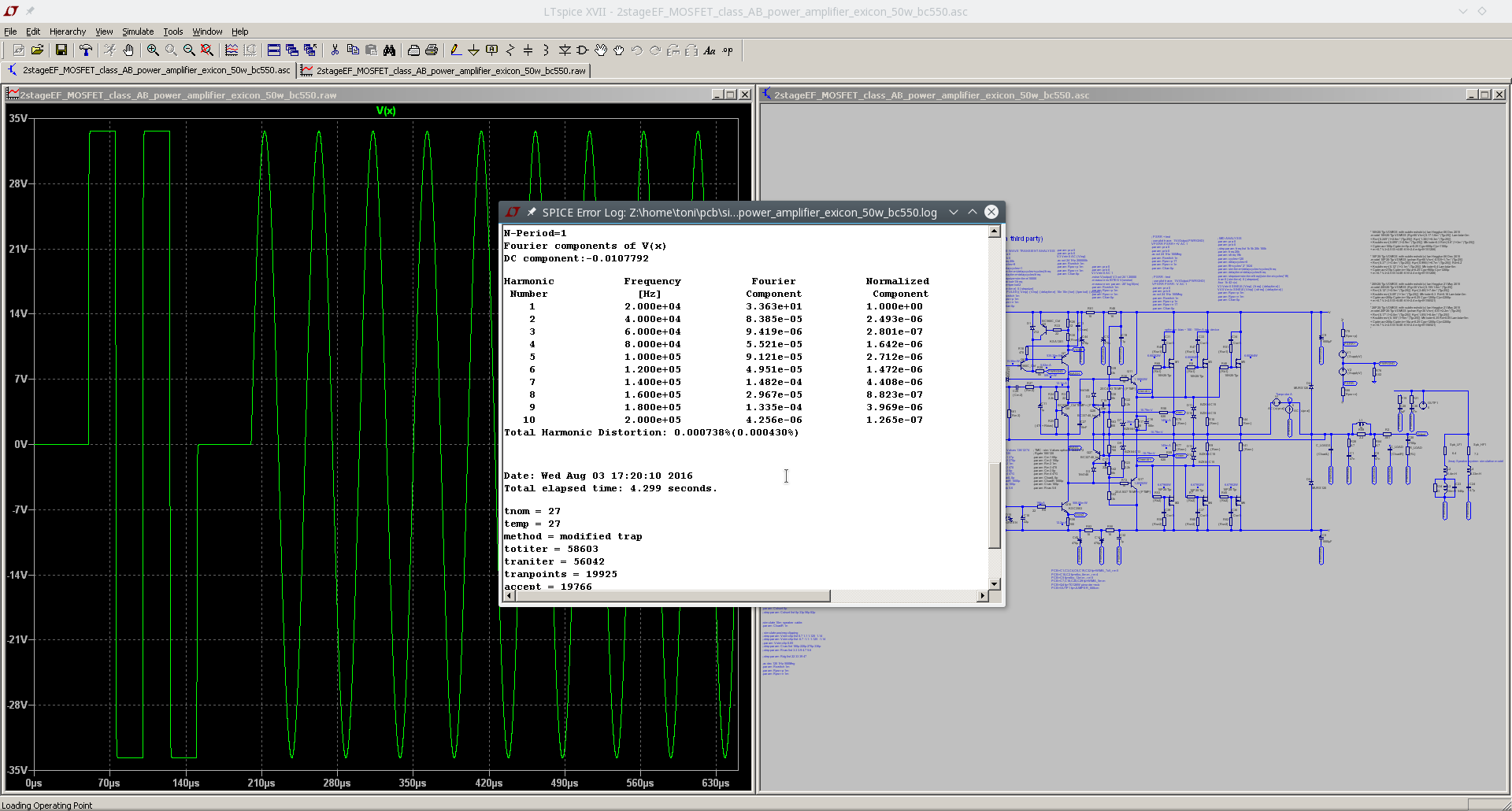

32bit software versus 64 bit software ...
Same default settings (only compression unchecked)
results very similar ... but not equal.
Simulation speed is higher using the new 64 bit LTSpice17
6.359 versus 4.299 seconds.
We are able to design more new amplifiers in a shorter period of time!
BR, Toni

I'm of course not talking about speed differences. A new PC will also fix this.
I would be worried if the actual sim results would differ.
Jan
at least the fft results differ ...I'm of course not talking about speed differences. A new PC will also fix this.
Jan
