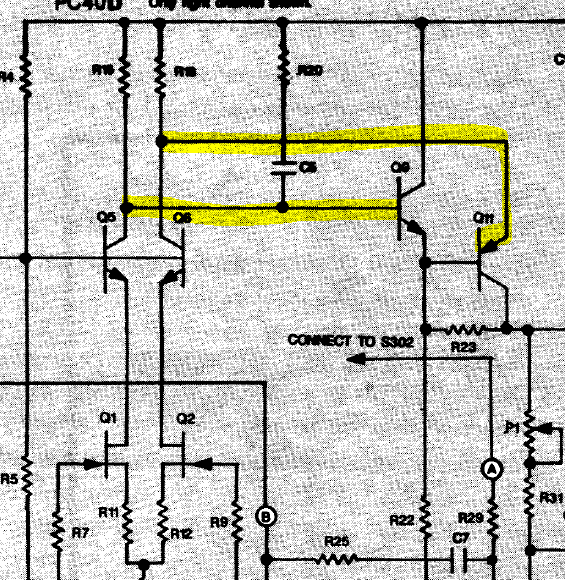

By pseudo folded, I assume you are referring to the IPS/VAS topology where the main collector of the IPS is connected to the base of the VAS and thence to the rail through a load resistor, and the other collector is connected to the emitter of the VAS transistor...
yep, got it in one
... I should probably take a closer look at this connection and touch on it in the second edition...
That would be most appreciated, thanks!

Pseudo folded
I do not think this circuit can refer to a folded or cascode configuration at all.
It has been seen without the buffering transistor on John Curl's schematics.
The VAS transistor simply works in differential mode, just as a differential circuit but with very dissimilar input impedances.
Boberly attibutes the circuit with emitter follower buffering to Lender :
http://www.diyaudio.com/forums/soli...age-large-voltage-swings-lenders-circuit.html
The signal path for one half of the output of the IPS is that of a folded cascode, so that is where the reference comes from. Other than that, the whole circuit has little to do with a folded cascode or, for that matter, differential operation, since the contributions from the two outputs of the IPS, though opposite in phase, do not have any where near similar effect on the output current of the VAS transistor.
To the best of my knowledge, the first publication and implementation of an amplifier with an LTP IPS, a current mirror load, and a 2EF VAS was by Bob Widlar back in the 1960's in an early IC op amp.

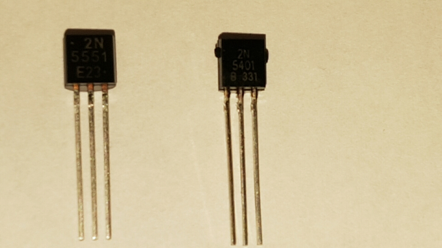

I didn't get any response from them at all. The part I ordered was a "Fairchild" 2N5401 shortly after Fairchild stocks disappeared at the major vendors, hoping they had original stock left. What I received wasn't the same shape, size, writing font, lead diameter, or even colour of my remaining stock. The one on the left is an original Fairchild part.
Hi Jeff,
It certainly does look like a poor fake. There is a Chinese factory making discontinued part numbers, and they are supposed to be the same. They seem to be making North American parts. I don't trust them one little bit.
That should have been disclosed to you before the sale. No response from them looks like further deals are a no-go.
-Chris
-Chris

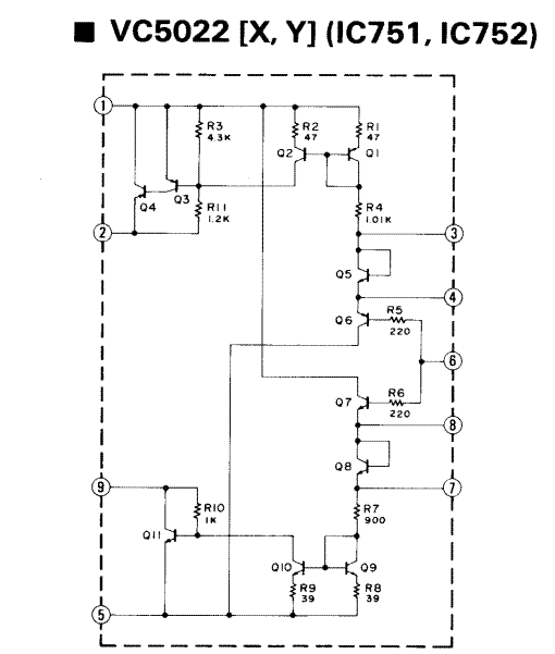

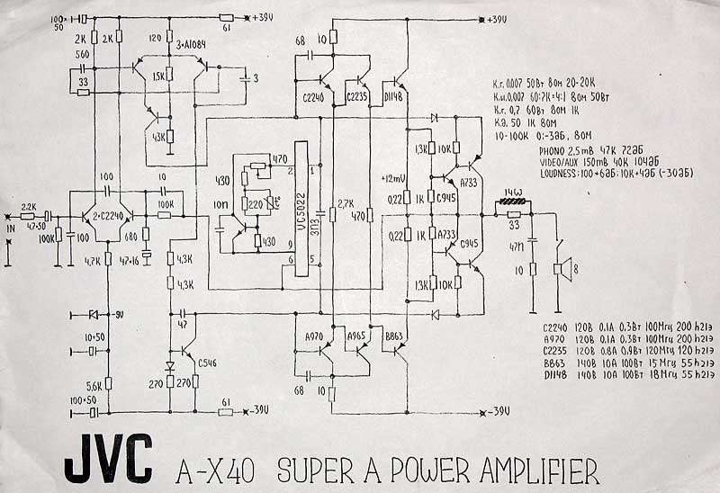

Hi.Sliding bias is an interesting candidate for discussion.
Firm JVC used these chips in poweramps JVC AX-50. The idea is to give passive shoulder additional bias equal to the voltage increment of the active of the shoulder. It works.
With your permission, I will add my two cents. A differential stage without the tracking circuit (boot-strap?) greatly distorts, operating from a signal source with a large output impedance. I solved this problem just two jfet.Bob,

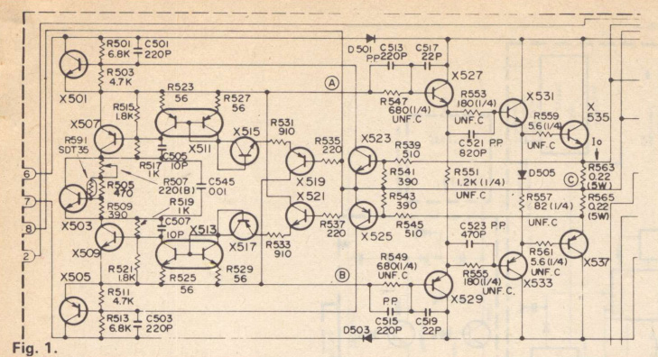

Did you cover Error Correcting circuits?
Like this one in Electronics World by William de Bruyn June 1997
If not, would you like to comment on the approach?
This thing can be useful. I would be grateful for any advice.but I'll also look to see if there are a few things that can be added that would be helpful in the earlier chapter on NFB.
