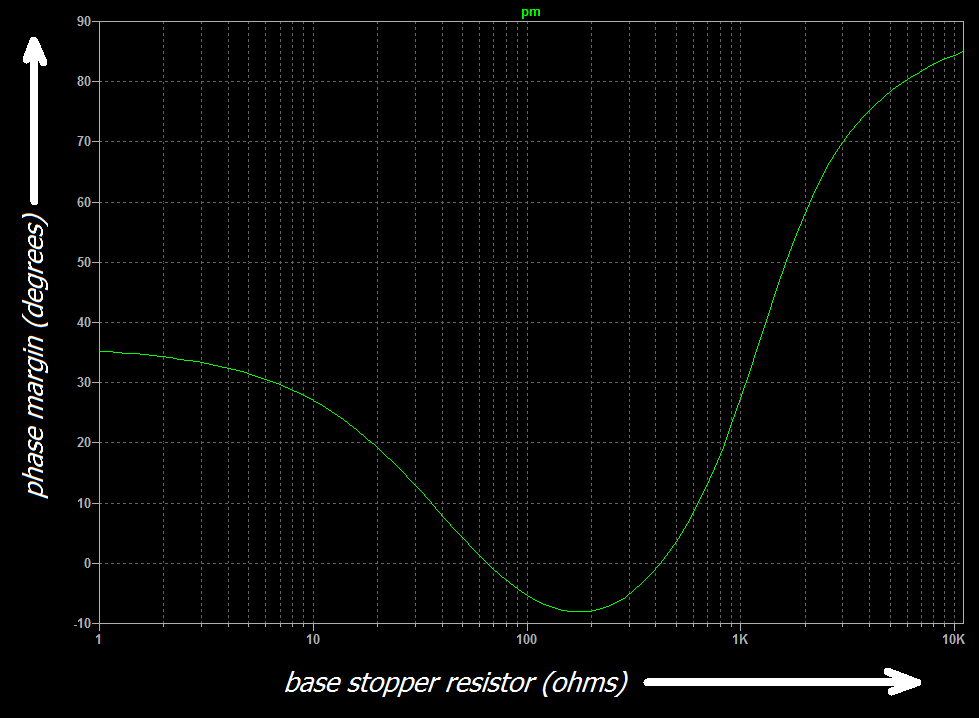

Bob, I took to heart the advice in post #7526 and started simulating the 2T shunt feedback current source in the frequency domain, studying gain and phase. The simulation results seem to be telling meI made a plot of simulated phase margin vs. stray capacitance, image #3 below. As you can see, phase margin crosses zero when Cstray is above 8 picofarads. That's scary!
- Self inductance of the transistor pins (up to 15 nH) doesn't make much difference. I didn't study mutual inductance however.
- The impedance of the load driven by the current source is critical. Lower impedance loads (such as the emitters of an LTP) result in MUCH worse phase margin.
- The ratio of currents between the two transistors doesn't make much difference. I froze it at ten to one so you wouldn't gripe.
- Stray capacitance across the current sense resistor ("R1" in the schematic below) can destroy phase margin.
- Different transistor part#s (i.e. different SPICE model parameters) gave different amounts of phase margin. The Fairchild KSA992 (model supplied by Linear Technology) was worst among the PNPs I tried. The BC560C (model supplied by Cordell Audio) was second worst; it needed 30pF of stray cap to begin oscillating.
To get the transient simulation results in image #2, I used the LTSPICE directive ".IC" (Initial Conditions) to nudge the simulated circuit away from its metastable state. The LTSPICE deck (.asc file) is attached if anybody wants to horse around with it.
I myself have decided to stop using this particular topology to implement a current source; I've gone to (VREF-VBE)/R circuits, with and without cascode. Mostly, with cascode.

Thanks for doing this. I'll try some of the sims when I get a chance. You make some good points. Your use of a 13-ohm load is pretty low, but you could argue that the load looking into the emitters of an un-degenerated LTP might be that low if each transistor was running at 1mA, and perhaps even somewhat inductive, depending on what the bases are connected to.
Out of concern for HF EMI effects in the common mode, I almost always in practice put a 1k resistor between the tail of the LTP and the current source, so that may be helping me as well.
What method did you use to evaluate loop gain?
As stated earlier, placing a 100 ohm resistor in the base of the reference transistor should clean all of this up (no capacitor need be added). Putting in such a stopper resistor is no big deal. I would keep using this current source where it seems like a good solution. I will definitely address this stability issue in the second edition.
I predict that when you simulate this 2T circuit using the BC560C SPICE model from Cordell Audio's website, you will find that 100R in series with the base makes the phase margin worse instead of better. I predict you will find yourself in agreement with Douglas Self, that sometimes this resistor needs to be as large as 2.7K to be effective. LTSPICE's feature that allows you to make a plot of stepped parameter (X axis) vs .MEASured quantity (Y axis), will give you a graph of Rseries versus PhaseMargin ... same as my image#3 that graphs Cstray versus PhaseMargin. Phase Margin gets worse before it gets better. Really.
Perhaps you might agree with the claim that some audio DIYers employ the "Monkey See, Monkey Do" approach to circuit design. So it would be nice if an influential book like your 2nd edition, contains schematics with current sources that don't oscillate. Then mindless copiers will have a better chance of success.

I assure you, I will definitely discuss this issue in the second edition.
Where did you find that statement from Doug about the base resistor value? Can you give me the page number and what edition of his power amp book it is in?
How did you measure the phase margin?
Bob

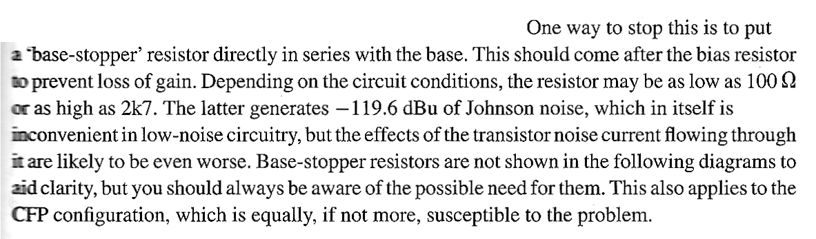

Bob, I just used the bog standard procedure for making open loop Bode plots. I am sure you did exact same thing when you simulated Figure 9.7 (p.181) in the first edition of your book.I've attached a representative plot of phase margin versus 2T current source "base stopper" resistance. Not all transistor types (i.e. SPICE models) display this behavior in simulation, but many do. Phase margin gets worse before it gets better. 100 ohms is a particularly disastrous choice.
D. Self mentions 2.7Kohm base stoppers on page 72 of the 1st edition of his Small Signal Audio Design book, excerpt below.
- Identify the complete loop
- Find a convenient place to break the loop
- Drive an AC test signal at the "input" of the broken loop
- Observe the signal at the "output" of the broken loop
- Plot magnitude and phase of V(out)/V(in)
- Use LTSPICE ".MEAS" statements to read Phase Margin off the plots
