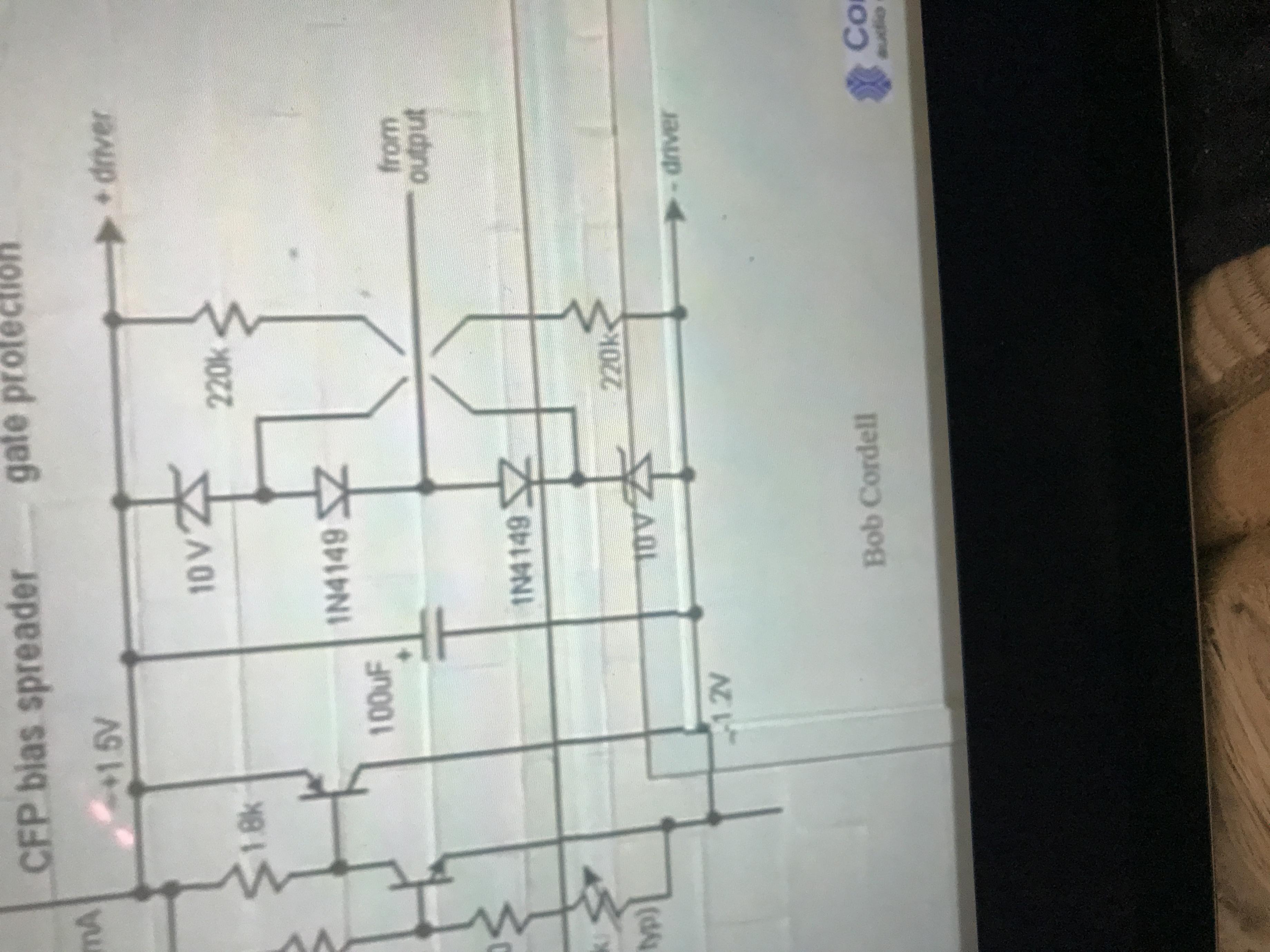

Bob,
Your Hafler update uses a different diode configuration in the positive part of the clamp circuit than Hafler used, could you confirm it’s OK before I connect my output stage back up, the outputs are very hard to replace if I lost them
Bob,
I'm pretty sure its OK, since the amplifier was actually built and tested, including driving it into clipping.
Bob

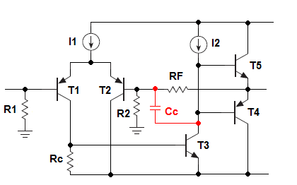

THX Bob for your last answer.
But I have one more question.
What do you think about placing the compensation capacitor as I show here:
675114d1523717486-bob-cordells-power-amplifier-book-bjt_12-png
This is Miller Input Compensation (MIC), as described in my book. I used it in my MOSFET power amplifier with error correction (see JAES article on my website). This compensation is very effective, and allows very high slew rate. The 50 W MOSFET amplifier I used it on did 300 V/us.
However, the Miller compensation loop formed with MIC encloses 2 stages, and the compensation loop itself must be compensated, usually with a ULGF around perhaps 10 MHz. In the case I used, this was done with some lag-lead compensation. So the complete compensation can be a bit trickier than simple conventional Miller compensation.
Bob
