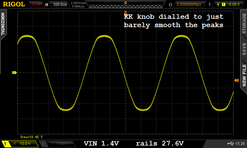

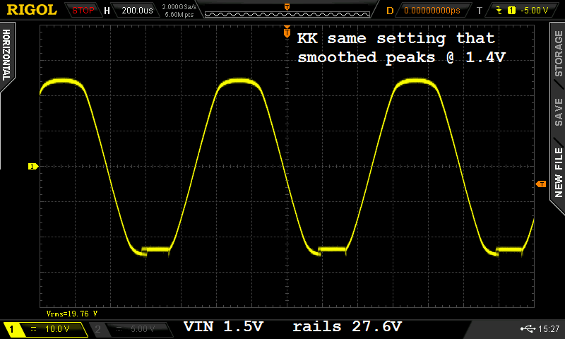

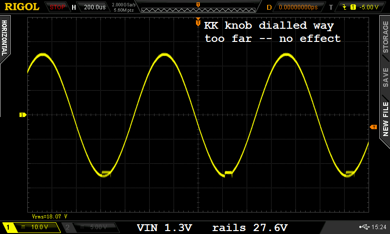

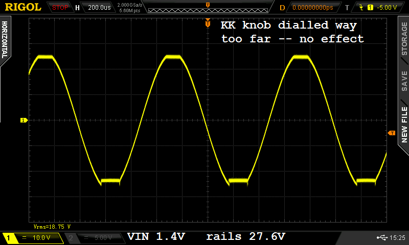

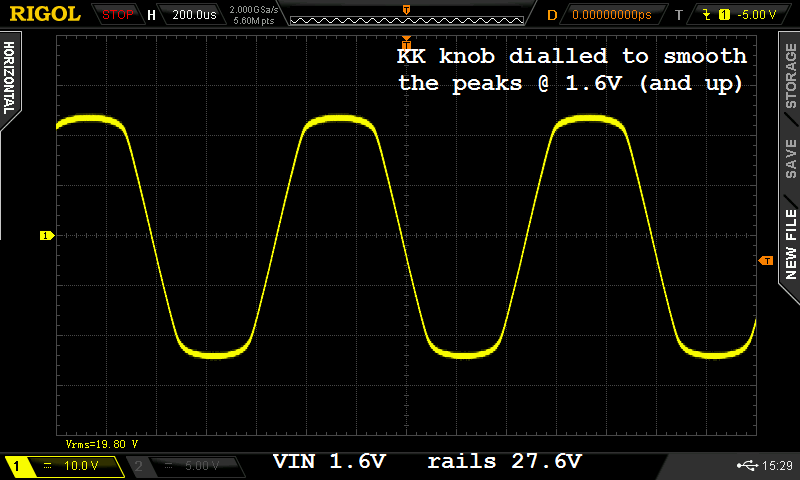

Adjusting the Klever Klipper from Bob's book
Bob, I wasn't sure whether to create a brand new discussion thread for your Klever Klipper, or to leave it in here with the other things in your book. If you wish, we can ask Moderators to split this off into a new thread, all its own.
I'm working on the user manual for Bob's Super Gain Clone (found in his chapter on Integrated Circuit Power Amplifiers) and, today, on the section about setting up and dialling in the correct potentiometer setting for the Klever Klipper.
I came across a bit of a surprise: If you set the Klever Klipper to smooth out and round off the amp waveform when it's just barely clipping, increasing the input signal some more (i.e. driving the amp harder into clipping) brings back the icky ugly P.U. unpleasant flatline clipped wave. I found that I had to set the input amplitude to 1.25X the input that juuuuust barely clips, and then adjust the Klever Klipper at that signal level, to get rid of all flatline non-smooth clipping at any and every input signal level.
Here's my data.
Figure 1 shows the amp with the KK threshold set waaaaay far away so that KK is doing absolutely nothing. An input signal level of 1.3V rms {don't imagine that my signal generator's rms amplitude readout is very precise!} gives a wee tad bit of clipping on the negative going peaks.
Figure 2 shows the amp with KK doing nothing, and input amplitude increased to 1.4V rms. Now there's clipping on both halves of the waveform.
Figure 3 shows what the Klever Klipper does, at 1.4V input level. I've dialled the KK potentiometer to just barely get rid of the flatline clipping and to make nice smooth rounded waveforms instead.
Figure 4 is where the fun starts. I left the KK pot at the same setting, but increased the input signal level from 1.4V to 1.5V. Alas, unwanted flatline clipping has returned on the negative peaks.
Figure 5 increases the input signal level to 1.6V, and dials the Klever Klipper to eliminate all flatline clipping at 1.6V. Peaks are smoothly rounded once again. I observed that with this pot setting, the KK successfully keeps the output smooth at all input signal levels, including 1.8V, 2.0V, 2.2V, and 1.3V.
I am struggling with this decision: Do I recommend that people should strive for smoothness at the onset of clipping (Figure 3), knowing that further increases in signal level will result in non-smoothness (Figure 5)?
Or do I recommend that people should (a) find the input signal amplitude that just barely clips; (b) set the input signal amplitude 1.25X higher; (c) dial the Klever Klipper to remove all non-smoothness at that level (Figure 5).
Math note: 1.6V (Figure 5) divided by 1.3V (Figure 1) equals 1.231.
Thanks for any critique or insights!
Mark
edit- in all photos, both channels are driven with the same 1 kHz input sinewave. Both channels are loaded with 8 ohm 150 watt resitors

> An input signal level of 1.3V rms ...gives a wee tad bit of clipping...
> dials the Klever Klipper to eliminate all flatline clipping at 1.6V. ...keeps the output smooth at all input signal levels, including 1.8V, 2.0V, 2.2V, and 1.3V.
1.3V vs 1.6V is <2dB. If you are working within a few dB of clipping, you really need a bigger amp. I'd trim for 1.6dB. And I suspect for many users it would be best to design this in (make clip level a set fraction of supply, allowing for nominal diode drop).

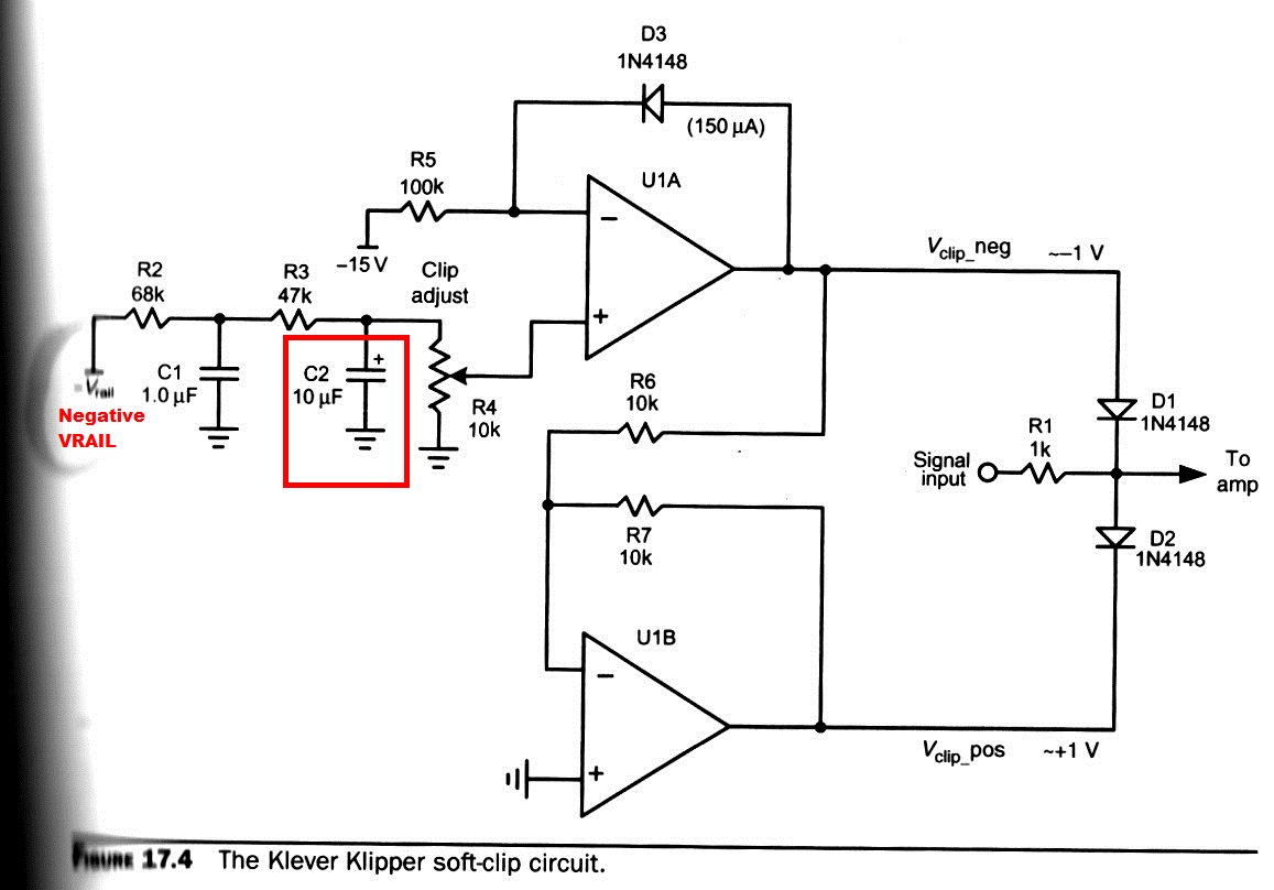

> ... I suspect for many users it would be best to ... make clip level a set fraction of supply, allowing for nominal diode drop
Have a look at the Klever Klipper schematic, either in Bob's book or in post #9345 of this thread. It does set the clip level to a fraction of supply.
761379d1559859541-bob-cordells-power-amplifier-book-kk-jpg
As the book says,
Diodes D1 and D2 provide the soft-clip function in combination with R1. The soft-clip threshold voltages are created at op amps U1A and U1B. These voltages track the short-term average power supply rail voltage. Adaptive soft clipping occurs just shy of output amplifier hard clipping at any given rail voltage condition. As a result, little or no dynamic headroom is sacrificed.
This implements a trimmer-adjustable clipping threshold; the trimmer modifies the "fraction"
  • Clip the input signal when it exceeds [(Rail Voltage) * fraction]
However, this is only an approximation of the real situation. The LM3886's output stage is not RRIO; it clips when asked to drive the output beyond (Rail Voltage - (Several VBE and IR drops)). What we really want is a circuit that will
  • Clip the input signal when it exceeds [(Rail Voltage - OPSdrop Voltage) * (1 / AmplifierGain)]
Where OPSdrop Voltage represents the VBE drops and IR drops that occur between the supply rail and the output pin, at clipping. The "fraction" is just (1 / AmplifierGain), which is the relationship between input signal and output signal. Rewriting,
  • Clip the input signal when it exceeds [(Rail Voltage * fraction) - (OPSdrop Voltage * fraction)]
I suspect that Bob included a trimmer potentiometer specifically to deal with the second term (the error term) above: (OPSdrop Voltage * fraction). It's not a constant, it varies with load current. Which means it changes when you change the load impedance (4 ohms vs 8 ohms), it changes when the LM3886 die temperature changes, and other variables. We could attempt to identify and quantify every one of them, and build a replica model of their effects into the Klever Klipper threshold voltage circuits. OR we could build in a trimmer pot and let the user dial them away. I think the second method may be far simpler.
And, fortunately, the second term is small compared to the first term. The LM3886 datasheet provides many different datapoints from which you can back-calculate an estimate of OPSdrop Voltage. For example, max undistorted output into 8R load with 28V supplies is 38W on the datasheet. Thus Vout = 17.44V rms = 24.66V peak and OPSdrop Voltage = 3.34V. The first term is (28 * fraction) and the second term is (3.3 * fraction). The error term is small but perhaps not negligibly small.
One way to go, of course, is to use a combination of measurements and datasheet calculations, to find the worst (largest) possible value of OPSdrop Voltage, and use that as a conservative over-estimate. Maybe the KleverKlipper will activate a smidgen too soon for folks with 6 or 8 ohm speakers, but it certainly won't active too late and thus allow the 3886 chip to enter clipping. And there are probably a few other approaches one could take, which end with the same result: the cat has been skinned.

Hi Mark,
These are nice, insightful measurements. Although I can't explain the behavior when the signal is set to be just into clipping where harsh clipping occurs at a higher level, it could have something to do with power supply sag interactions. I completely agree with your suggestion of setting it up so that non-rounded clipping does not occur at any signal level.
Bob
