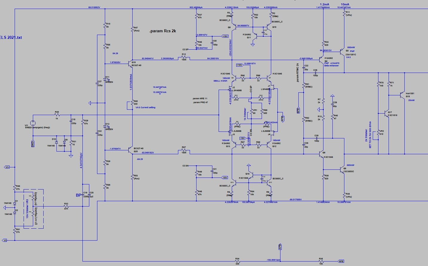

Hello Bob and Jan
I prepared two asc files that should run as I included the models directly in the asc file.
This time I increased the floating ccs current and added R12 and R57 (150k ohm) so not to reduce OLG at LF.
Let me remind you that the amplifier is built and works perfectly with Bob`s shunt resistors solution but I feel I could get a slight improvement in the LF if I was able to increase OLG.
As is the amplifier produces an extremely detailed and clear HF being able to produce a very large and well defined soundstage but the competitor (my reference in fact based on the differential VAS also from Bob`s book) has a much better rendition in the lower octaves.
Hope you have the amiability to have a look at my humble efforts.

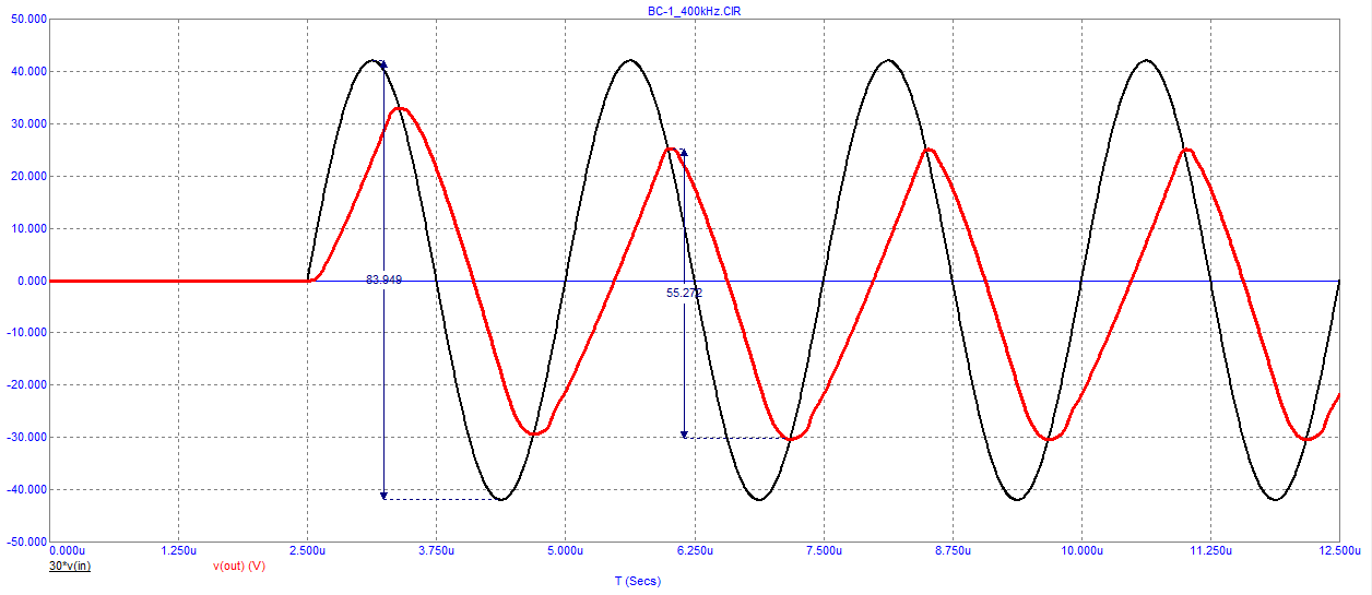

If I remember correctly, a 100kHz low pass was used pretending that it would limit the signal frequencies to the audio band.
But that is not at all the case; with a 100kHz 1st order low pass, the 200kHz component is only 6dB or so below the 100kHz component.
Hitting an audio amp with such a signal is very unfair to the amp :cool:
And drawing conclusions from how the amp handles this for it's performance in the audio band can be very misleading. Bad science.

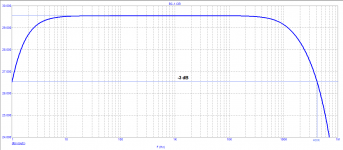

I agree with you, every note of a piece of music begins with a break of the first or second order.
Hit the piano key - get an infinite spectrum. Hit the cymbal with a stick - get another portion of the infinite spectrum, and so on from the beginning to the end of the piece of music.
And in order to reliably amplify such signals, the amplifier must be as broadband as possible, strictly speaking - with an infinite bandwidth.
For example, Hafler said that the amplifier should be as broadband as possible, although I have not seen anywhere in his statements which band is enough. Cyril Hammer argued that an amplifier with feedback should have a negligible signal propagation delay - only a few ns, and this requires a bandwidth of tens of MHz.

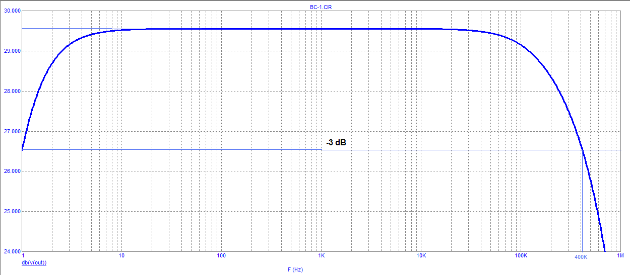

The low-signal bandwidth of the amplifier under consideration is 400 kHz, while the full power bandwidth is much more modest.

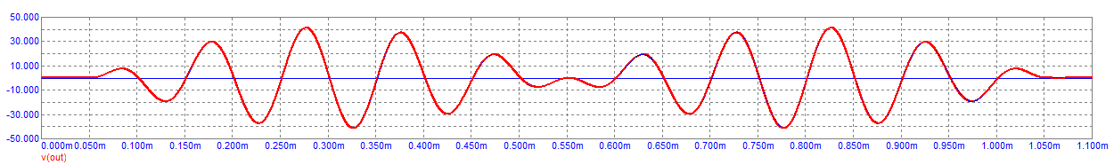

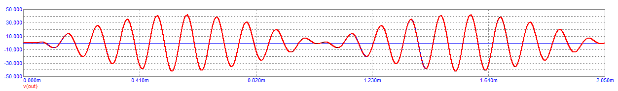

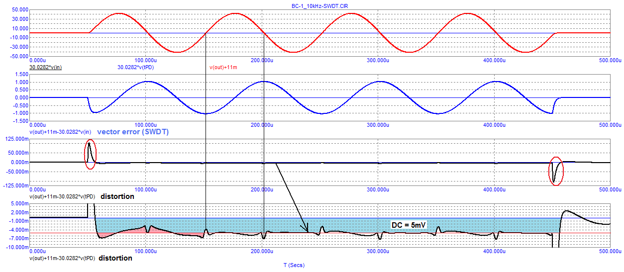

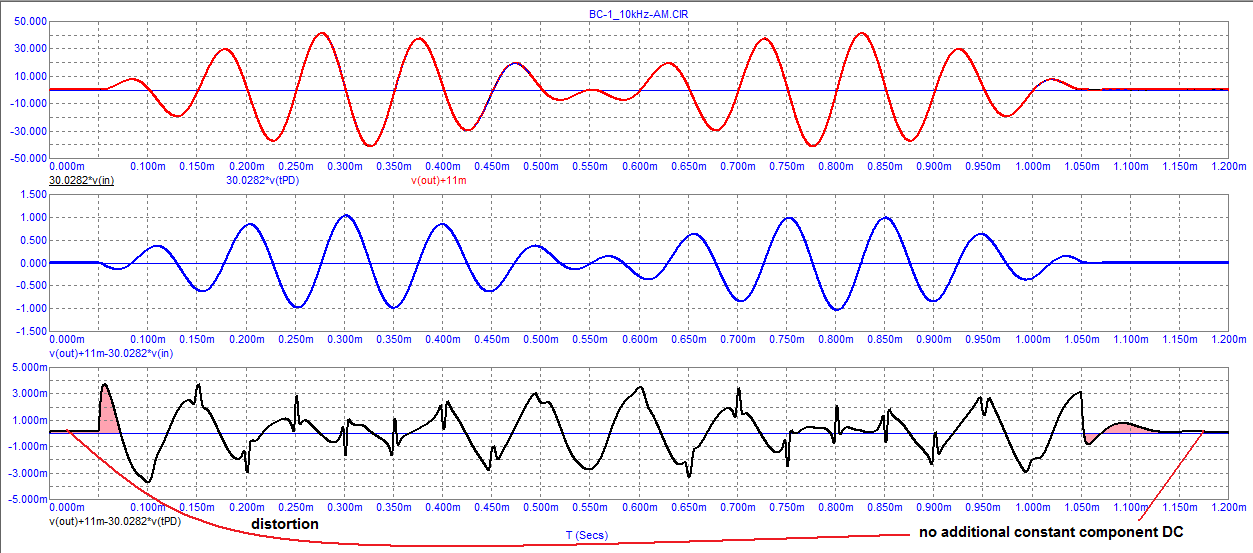

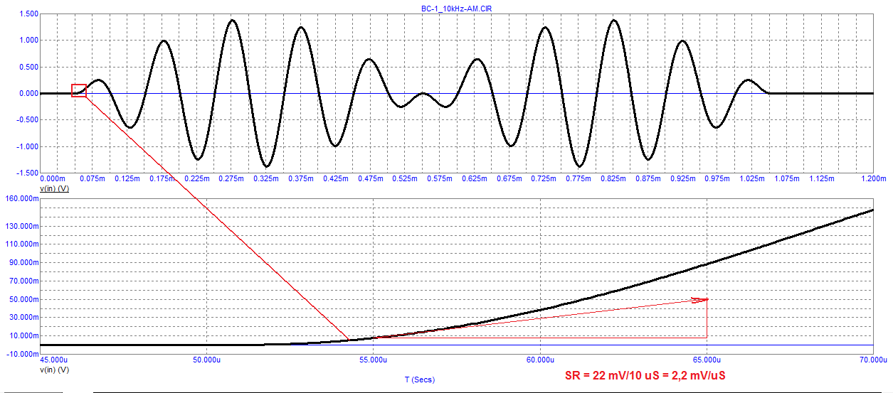

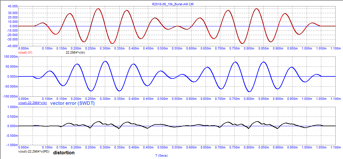

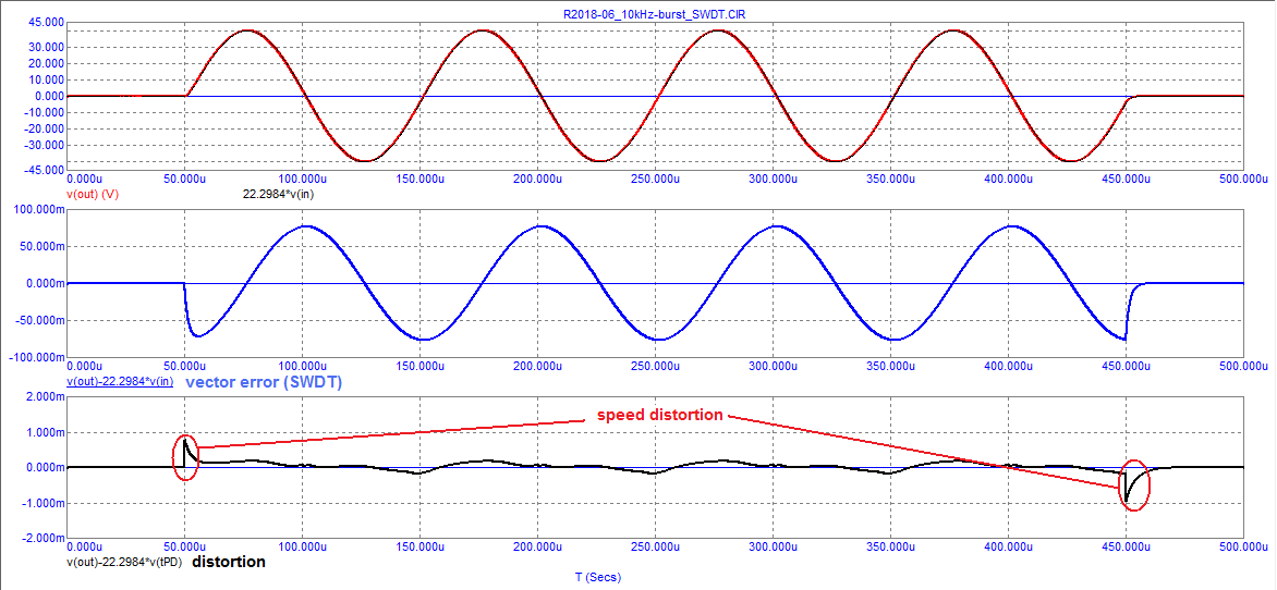

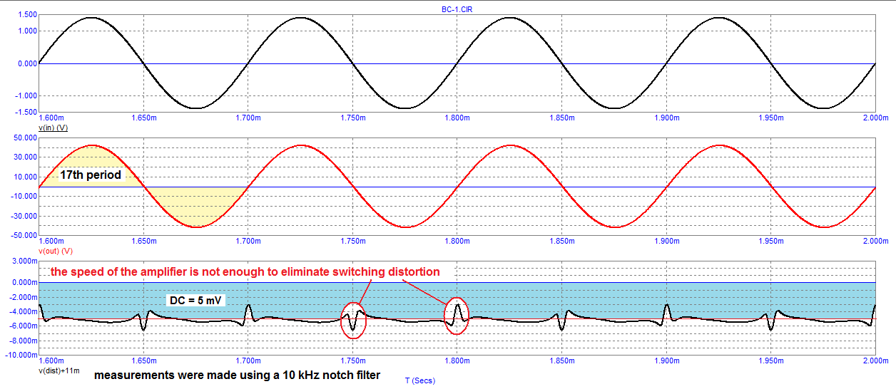

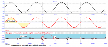

Jan, where do you see the infinite slew rate? at what point of the signals? Can you show these points in a stretched form?
Here are three tests with a 10 kHz signal:
  1. In steady state - using a 10 kHz notch filter;
  2. With the help of a burst (the test was performed in a compensatory way);
  3. With the help of an amplitude-modulated signal (the test was performed in a compensatory way).
    All three tests were carried out on the same model by simply switching the input signal. In the absence of an input signal, the output of the amplifier has a DC component of approximately 11 mV.
    When a burst is applied to the input (the first test), reaching the steady state takes a little more than a period (not counting the additional constant component in the signal).
    When applying an amplitude-modulated signal, the greatest distortion occurs precisely at small signal amplitudes.
    In the third figure, areas of distortion with an “infinite spectrum” are highlighted in pink (if I understand your statement correctly).

Note that the derivative of the slew rate, aka 2nd derivative, is also limited to a non-infinite value.

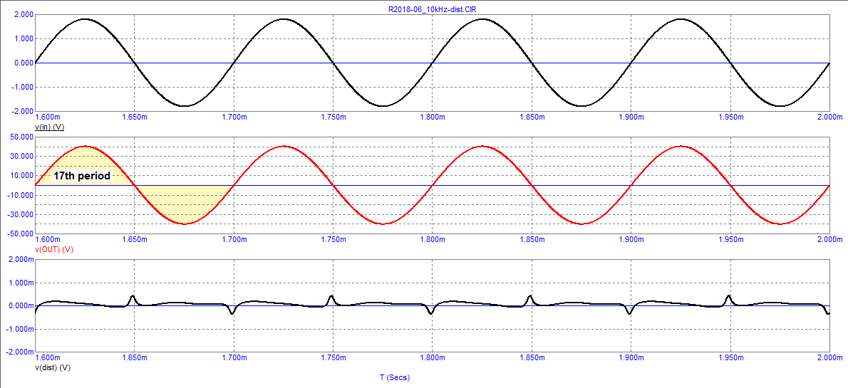

Bob, why did I ask you a question about your opinion about the signal delay time? Because this topic is not covered in any book on the design of audio frequency amplifiers.
Here are the same tests that I gave on the model of your VS-1 amplifier on the model of another amplifier whose signal delay time is an order of magnitude less. Distortions in steady state are approximately comparable.
Compare and draw conclusions.
Thanks for attention
