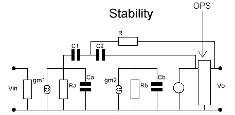

Hi Joakim,
Using your formulas to calculate the lead compensation for the TPC compensation seems okay for C1 < C2. However, for C1 > C2, the step response is way too slow, IOW, I did something wrong.
Here's my calculation:
C1 = 600pF (input cap)
C2 = 120pF (output cap)
R1 = 530R
Rfb1 = 3k8
Rfb2 = 200R
Rp = Rfb1 || Rfb2 = 190R
A = 20
RE = 68R
Ic = 2.5mA
gm = 1/(68+10) = 12.8mA/V
tau0 = A * C1 / gm = 20 * 600 / 12.8 = 937 ns
tau1 = R1 * ( C1 + C2 ) = 382 ns
tua2 = tau0 + tau1 = 1319 ns
lead compensation, R3 and C3:
R3 = tau2 * Rp - tau1 * Rfb1 / (-tau0) = ( 1319*190 - 382*3800 ) / (-937) = 1282R
C3 = tau2 / ( R3 + Rfb1 ) = 1319 / ( 1282 + 3800 ) = 260 pF
Clearly, these values are wrong, but why?
(BTW, pen and paper math is not my forte. Actually, I hate it, as it's so prone to errors)
So please, would you be so kind to pinpoint my error?
E.
I do not understand your arguments.
TMC as TPC are minor loop compensation techniques
Did you look at figure (2) of my hand written notes where the TMC circuit is drawn in a nonstandard way? That might help understand why I did not treat it as a nested feedback loop circuit.
If you still want to use a minor/major loop analysis method then it's that you didn't account for the output stage that I object too. The stability of the major loop is well predicted by your previous analysis as long as the local feedback from the OPS to the VAS through R is stable with good margin and the OPS pole is well above the major loop crossover frequency. There is a need to check that the minor loop enclosing the OPS and VAS is stable too and has good enough margin.

Hi!
Those are not the C1, C2 and R values in a TPC circuit but the values you would have used in a TMC circuit.
Hi Joakim,
Okay, not the same values as in a TPC circuit.
This calculation then gives you the lead compensation required in a TPC amplifier with the same C1, C2 and R to give it the same response.
[snip]
Now, I'm really puzzled. First, they are not the same and now they are the same?
E.
What I mean is that my calculation is not a calculation of the optimal lead compensation for a TPC circuit with certain C1, C2 and R but the lead compensation needed for the TPC circuit to give it the same response as a TMC circuit with equal values of C1, C2 and R.
If you choose like you did in your post
R = 530R
then you are making a TPC circuit with the same response as a TMC circuit with those values. And that's probably not what you wanted.
Of course the minor loop must be stable. If you look at the loop gain of the minor loop, at frequencies close to crosse over, the R is shorted to the input of the output stage by the large C2 and do not influence the minor loop stability anymore. The minor loop loop gain is governed by C1 only like in a Miller minor loop.
Is this wrong ?
JPV
That's true for the minor loop enclosing just the VAS. At its crossover frequency which can be pretty high, maybe tens of MHz, R is basically shorted out and you have only C1 and C2 in series.
But there is also the loop around the output stage that has to be stable. This loop can become unstable as you decrease R even though the VAS looks stable at its local loop crossover frequency where 1/(s C2) << R.
But the loop gain around the output stage is less than 1 so no instability.

The loop gain around the output stage is, with the "global loop" back through the IPS broken
Code:
     (  + C1)
 (  + C2 C1 R1 ) s
times the gain of the output stage itself, so that is not correct. If all other feedback paths are in place it looks like in andy_c:s post and has a double-pole, single zero type response. See also the equation in my previous reply.
R = 530R
Ah, now I got it, thanks!
E.
