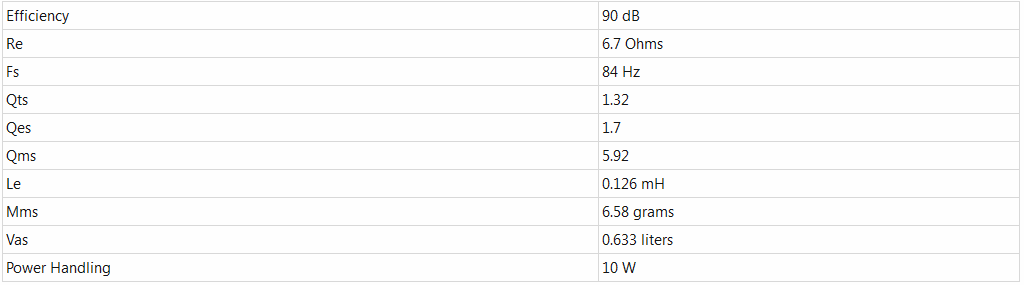

I found some measured T/S parameters for the F6 & plugged them into the simulator...the results were not good, but I knew "trouble" would be coming with a Qts of 1.32. Cone control as measured as Qes is way high at One-Point-Seven...yikes!!! I got a sealed system with 15+ Liters of volume, and a big nasty hotspot right around 100 hertz, a big three decibel hump, Very poor electrical control...a nice big honking magnet would help...try to find a pair of scrap speakers & yank the magnets off of them & stick them to the back of these new units...anything to increase control...more lines-of-force...??? I would bet those shiny cool looking backsides are hiding a puny magnet.

I think this is the data Richard Ellis found:
I'm just not sure I can make sense of the low Vas, which would be more typical of a 2.5" driver. Then again measuring compliance is the most error-prone part.

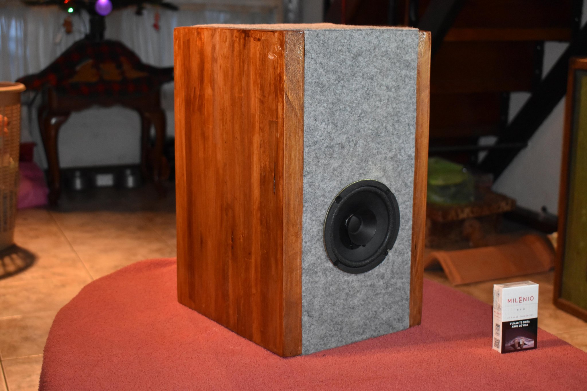

I would vote for aperiodic as well...I had a pair of NOS five-inch drivers with a poor electrical control with a Qes of 1.11 Since the particular driver came out long long ago with a long history, many had seen fit to experiment endlessly. I fashioned an aperiodic enclosure along the "best sounding tried" volume of enclosure and "restrictive vent". The results have been great, wouldn't know it's one of those 'black art' aperiodic types.

I think "6.33" liters makes sense. a stuffed leaky box would be safe. IF it has a lot of on-axis rise then might sound pretty good in a Karlson - it would need a lighter balance than say BetsyK or BG20 for clear sound.
If it's only a decimal shift, 6.3 liters would be more believable; considering the higher than advertised Fs, the suspension is likely stiffer than what the incomplete parameter set presumes on the Lii website. It's still a big shift from 50L to 6.3L. I wonder if their more popular or expensive offering measure closer to advertised.

Thankyou for the suggestions. I'm finishing off a pair of pencil/alpair speakers for home atm and will knock up a pair of 28 litre cabinets after they are done. Lastly, for the hole, is it better to be on the front or back... (Aesthetically I'd have the driver front high and port rear low)
The location of the aperiodic vent does not matter AFAIK, since it produces no output to speak of.

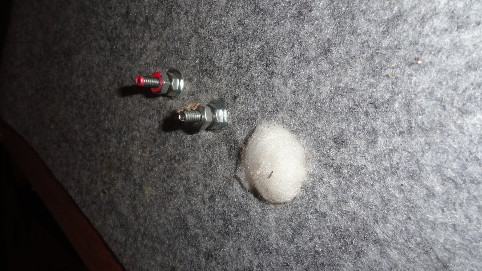

Here is my aperiodic with the five-inch driver, the "hole" is but one-inch in diameter so the stuffing stays in place, a bigger version could stand the likes of a nice chrome sink drain grating for a finished look. Wad up the stuffing having this "grill" on both the inside and outside to keep it in place...in addition to the volume being fully stuffed.

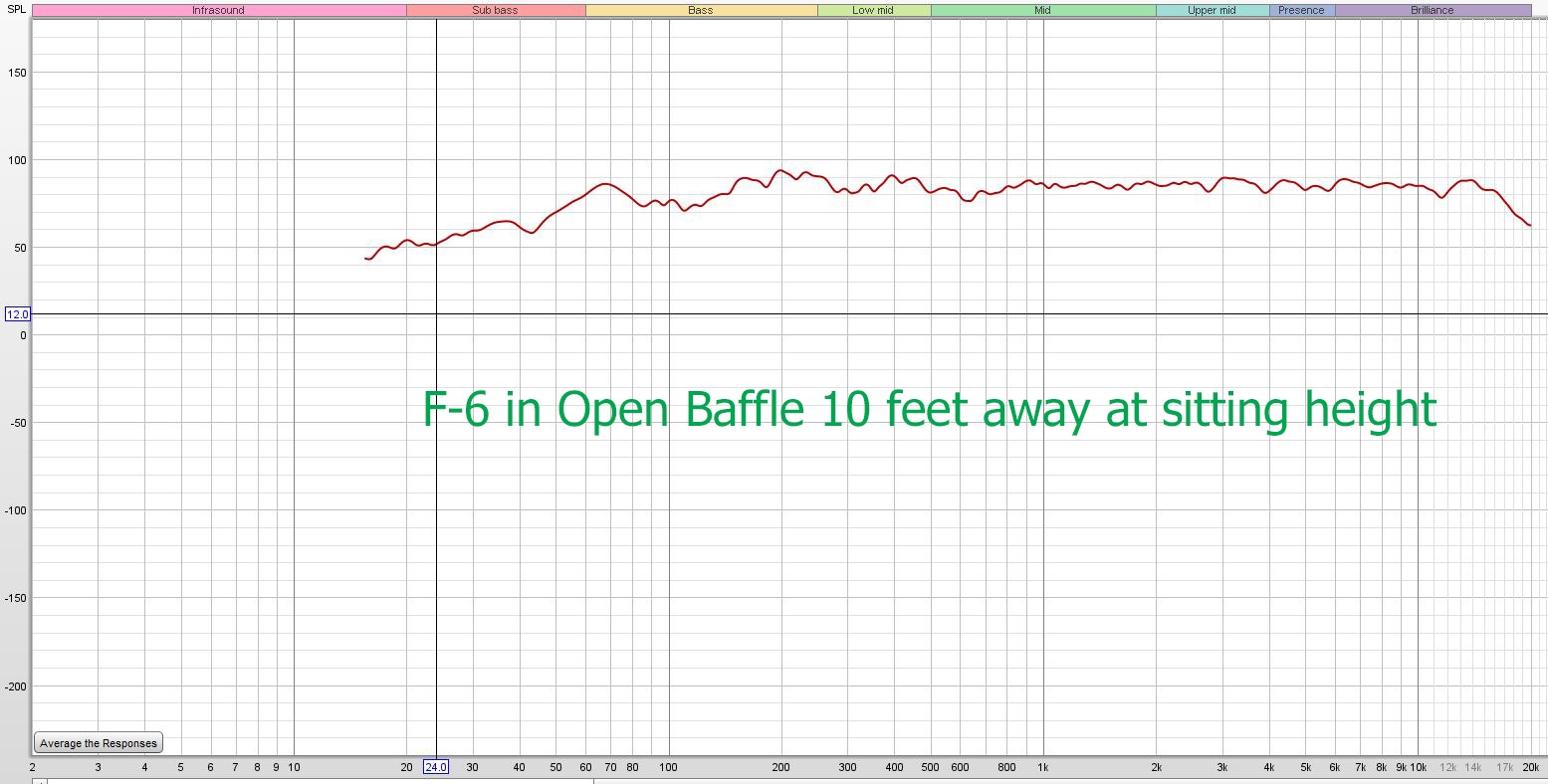

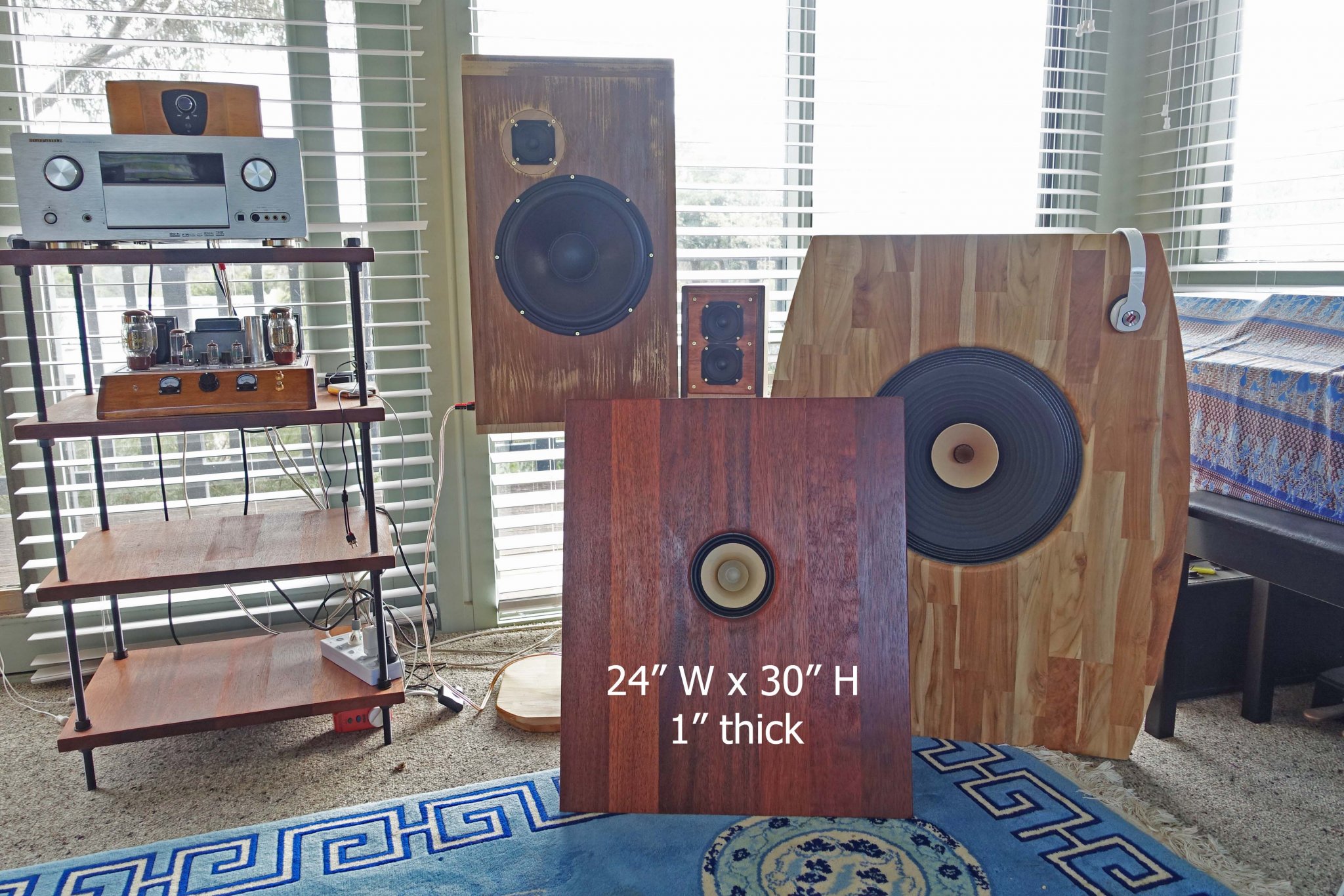

Hi James
FWIW, I received the same deal while awaiting F-18s. It was nice not to feel too "invested" and so have some fun with the build. I made some very basic open baffles. They were my first ever speakers and still work quite nicely for me (note: I don't hear over 10khz).

I thought about open baffle, but need them up off the floor on a shelf, thus considered that they'll be less than OK due to the closeness of the wall behind. How far away from a wall do you use yours...
