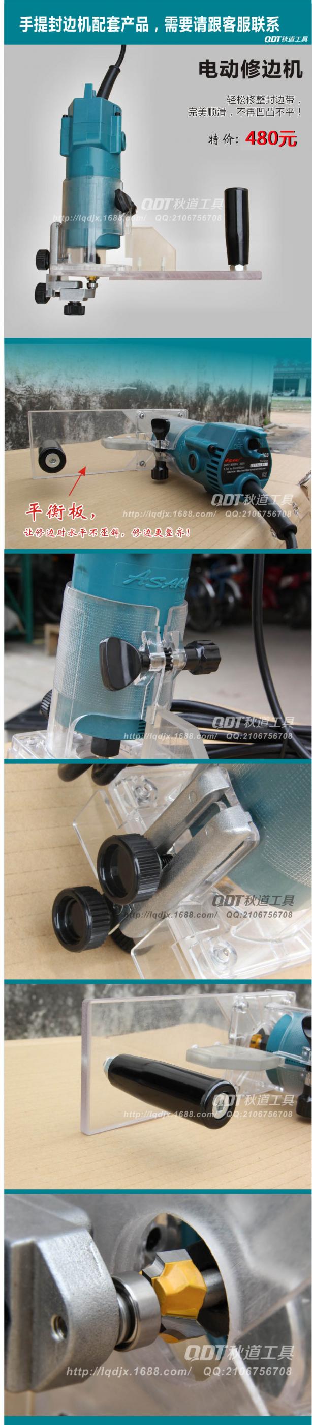

Thanks guys for your input, I think I am going with something like Makita RT0700C. It looks like a very popular model with many clones. So the Makita and third party accessories are in abundance.
Among those accessories there is a specialised base for trimming veneer, if not I can simply screw a strip of wood with a handle under the router for the same result.
Cutting big holes in thick material is not high on my list. My go to method is hole saw, and also it's possible to do this with a jigsaw and circular guide. I'm sure a router would do a prettier job, but this is inside the speaker and internal aesthetic is not that important to me.
So as mentioned my primary use us for trimming veneer, and may be cutting rebate for driver flush mounting. So we are talking about removing just a few mm material here.
As for progressively increasing the depth, this is a Dremel trick to overcome the limitation of its weak motor. And no you cannot do this while the machine is live. Even if you don't mind ruining the workpiece and yourself, the vibration would make it difficult to make precise adjustment (we are talking a few mm here).
Edit: With regard to roller marks, I read that we can stick masking tapes where the roller would be rolling, I don't know how well this works though.

Looks like a good choice for your needs. The pictures show a clear extension attachment with a handle. Don't know if that's included or not, because I've never seen it in the US. However, if it's not then definitely purchase it as well. You will need it. Balancing that router on its small circular base without tilting it at some point is not easy.
Makita offers a kit, at least here, with the plunge base for quite a bit less than buying that base later by itself. You will eventually need a plunge base to build proper speaker baffles with a chamfer on the back and a properly sized rebate on the front.
Have fun building whatever you're going to do.
