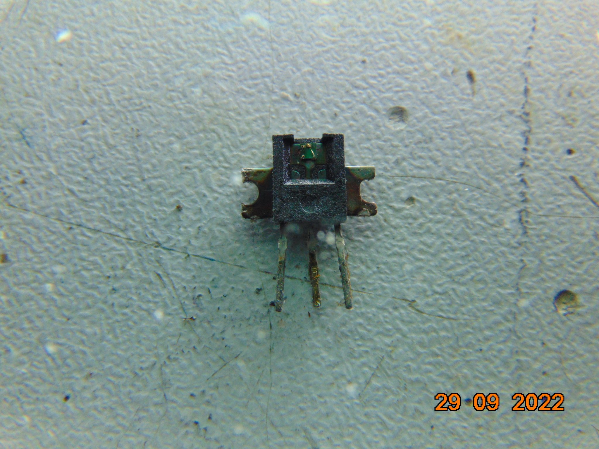

CD laser diodes are IR.......heres the diode,can anyone identify the type etc so i can find a replacement?,on testing with my fluke 83 on diode test mode,i get both expected voltage drops but no light output
i know they are ir but cant see anything on my phone camera either,the disk spins slightly then stops,consistent with no diode output,does anyone know the form factor of this then,so at least i can look for one.
messing around with the diodes is useless, you'll never get another one in proper alignment unless you have the factory equipment to do so.
Because once a diode is deemed bad, you replace the whole assembly, as is done in repair shops.

I know what your saying but why not stick to what i have asked BUT the laser assy is no longer sold,so getting another diode to try is worth a go,also the diode goes upto a datum so cant be that far off,worth a go as fas as i see it,thats why i need the case style +poss part number etc ok,hope that makes it clear?.

is no one going to answer what i asked or just keep having the keyboard equivelent of verbal diareah,i need to know the form factor of it,bit like a transistor could be t03 or t0 18 etc ok.

Finding that exact laser is difficult.
So this quest is foolish.
Best find another unit with a different fault, and make a good one from the two damaged units.
There also, different production months may have different lasers.
Again, good luck.
