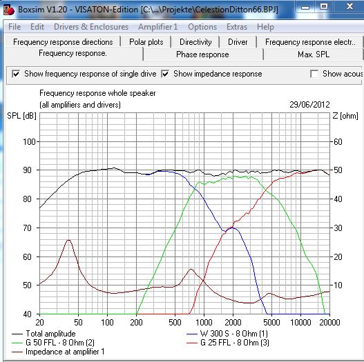

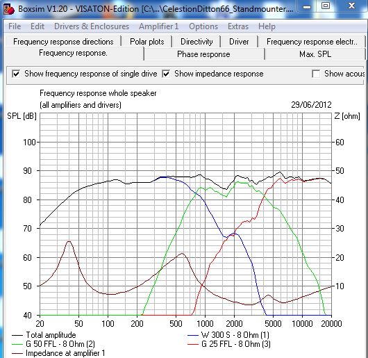

Below are the diffraction effects from a 60x40 cm standmounter which has been bafflestep compensated in the bass section to a reasonable degree, and the same basic design wallmounted and recessed into the wall to give an effectively flat front baffle with minimised diffraction effects and the 6dB wall boost you'd expect.
Some significant colouration from diffraction alone with the standmounter, along with loss of efficiency.
You can draw your own conclusions, but it certainly gives some insight into what direction a box design should head.

Steve, were those plots measured or simulated? When I measure a sharp edge box of about that size, I get a lot more diffraction effects. 1/2 inch radius helps a ton. This weekend I hope to do direct comparisons to 1" if I can work in the shop. It was 105 F out there today. about 95% RH. I am way too old for that.

No, diffraction effects are worse than a single suckout, David. They are a whole multiple of peaks and suckouts at ever increasing frequencies. Hard to equalise.Looks more like someone didn't take their time designing the midrange crossover in the baffle step adjusted speaker. A 4 Db suckout? Tsk tsk
