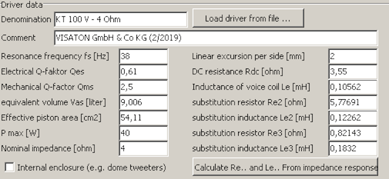

Main thing with Boxsim is this
Where do those substitute entries come from?? And is it a complete set? Needed if I try to use another brand with it.
I just entered a Dayton woofer into it. Some moans but it let me do what I wanted. Also saved the project file.
Main problem is that Dayton do not appear to state how their measurements are made. I have read that they make use of a hole in the wall for speakers but Xmax? I'd hope it's the 10% distortion version.
So I picked DIN baffle as the measurement method and optimised for that. Then changed that setting. The sp graph could do all sorts of strange things.
The moans mostly related to some one choosing to build a box, measure the data and re enter it and doing something else. It suggested saving it with _mod on the end. Needed if a visaton speaker is being used. It doesn't seem to have actually saved it,

I now find it pretty easy to use. It was mostly a familiarity problem as nothing like winisd. The common box aspect confused me a bit as I didn't realise each driver needed it's own enclosure when one is vented. I assume it's the same when sealed. Some commercial units do not use separate enclosures for each driver.
