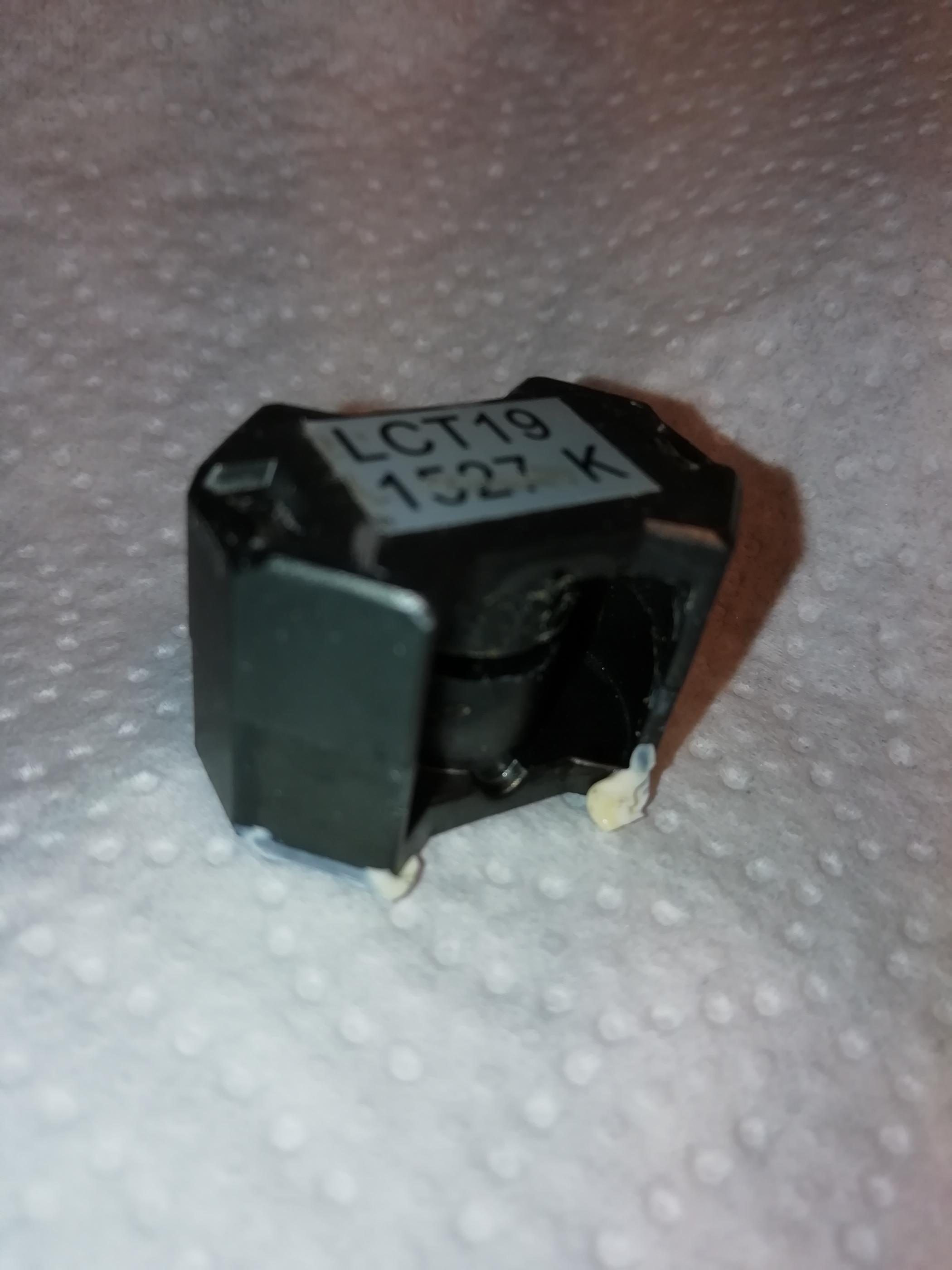

UCD/Purifi use closed external leg RM cores, gap is in the centre leg, also screened by the winding.
No. See picture of a demounted NC500 core. Air gap visible in centre leg. The external legs enclose the coil no more than 50%.
I can imagine high frequency strayfield issues, but pure and correctly oriented toroids should not be worse.
Yes. That's how I described it. The RM core is a compromise compared to a fully enclosed P core but still provides significant enclosure of the flux.
Sorry no. You seem to say that flux is "happening" in the coil and the core "encloses" it, but flux "happens" in the core.
The fact that toroidal transformers have low strayfields is because the core is "screened" by the coil (copper windings). Strayfield leakage in toroids is where terminal wires come off the core where it is not so well "screened".
Again you are saying what I said before. You may have misunderstood my suggestion that the coil screens the gap but once again you are stating the same in similar terms. We do actually agree with each other.
In terms of the coil screening the gap it is important to note that this is not an electrostatic effect. It is a magnetic effect. Stray H-Field concentration at the gap, the gap is treated as being distributed but it is not, is compensated by a reverse H-field in the winding. This is one of the reasons why losses in components carrying high AC currents experience higher copper losses specifically around the gap.

The core acts as a short circuit to the B field so the windows carry little to no stray field. In magnetic, reluctance, terms the windows form a parallel circuit with the externally closed, short circuited, core.
The effective field is nominally, reduced in ratio to the effective permeability, Ue, of the core material which is something like 2,000 or more for this sort of ferrite. 300mT -> 150uT
