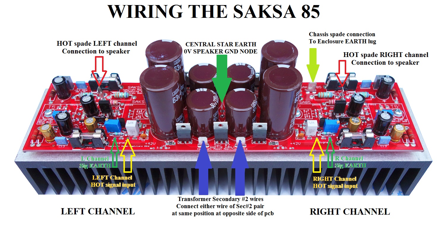

Hi Hugh,
Looking at your initial post with the attached pictures, correct me if I'm wrong and ignore my ignorance but is that a single PCB with 2 channel with separate psu on board so all we need to do is find a case and transformer? Basically I gather that's $k just for parts alone so it comes non populated.

Yes, Peter, you have it!
I populate, adjust and test all my amp modules these days. I do not sell bare pcbs.
Once running, all you need is a case (I have them available at moderate cost, designed specifically for my modules so no drilling or threading or painting), two transformers for the Maya or one transformer for the SAKSA.

Hugh,
Thank you for the quick reply. Am I correct the Saksa uses the same 300VA transformer with two 30V taps? If so, it's a drop-in to for a Naksa 80 amp.

Hi Jim,
Sorry for slow reply.
Yes, you are absolutely correct; this new SAKSA uses exactly the same transformer, 300VA with 2 x 30Vac secondaries. The footprint and all output devices are in the identical spot too, so it's a remove and replace with no drilling! You may need to solder the input coax from the RCA inputs, but all the rest is 6.3mm 1/4" spade connectors just like the NAKSA.
The 5A fuse for a 120Vac mains 300VA toroid is not enough. I agree; a 10A for this lower mains voltage is mandatory.
I also offer a custom enclosure for this amp which is one piece 3mm Al, very swish and 300mm wide, 250mm deep, and 65mm tall. This is very small, very high WAF. It has all holes and connections all drilled and ready and fully powder coated, with nice SAKSA 85 front label. It is $AUD120, or $USD92. A bargain for guys who hate metal work!
