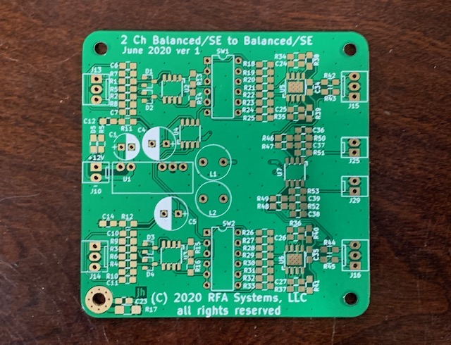

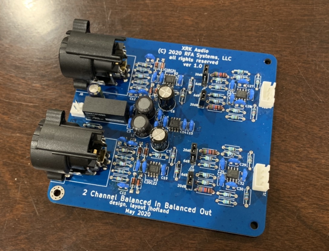

Here was the v1.0 verification prototype that I built:

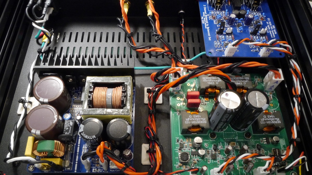

Member Redjr has already used the prototype version on his very nice TPA3255 amp build here.

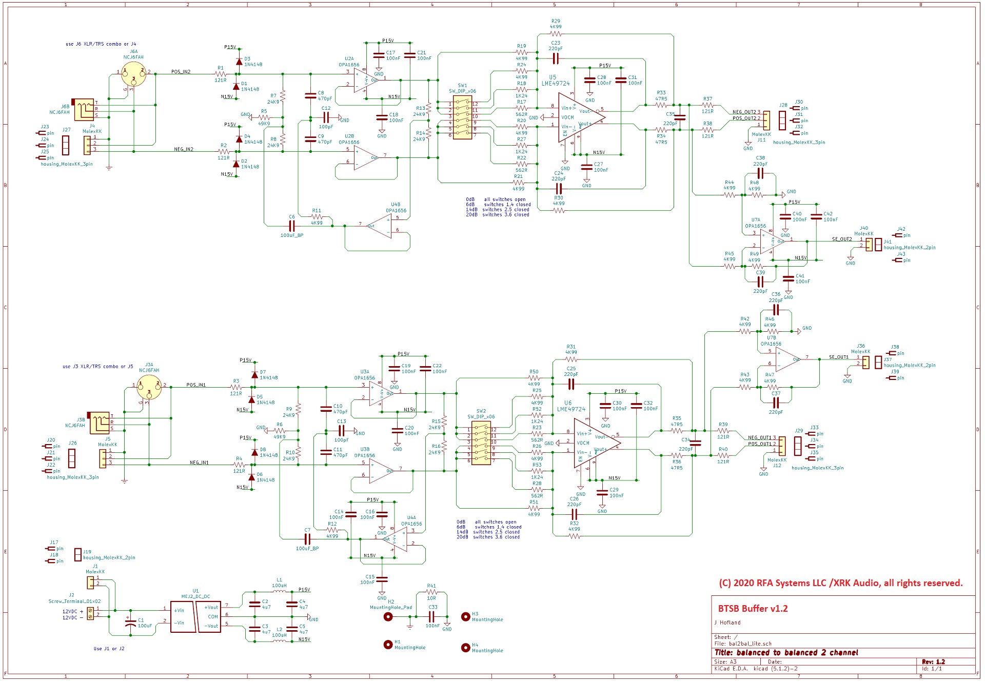

I thought that a more universal buffer would provide a choice of either SE/Balanced input and be able to driver SE/Balanced outputs simultaneously. This might be useful for driving a subwoofer amp, for example. The topology uses a state of the art OPA1656 for the input buffers and state of the art LME49724 balanced line drivers and another OPA1656 for the SE outputs. Another OPA1656 provides a bootstrap for the input amp to allow lower distortion drive at higher drive levels close to rail voltages. The power supply is provided with a very low noise Murata isolated DC/DC converter to take 12vdc from a wall-wart to +/-15v using the DC/DC followed with a CLC filter. The BTSB is absolutely silent and adds no noise or coloration. It is very transparent and can be used as a simple signal booster in cases where you need just a little bit of extra bump in the output from your source or existing preamp.
With the ability to accept SE or balanced and to drive SE or balanced, and with your choice of 0dB, 6dB, 14dB, or 20dB gain selectable with a convenient 8-position DIP switch - you will find it an indispensible part of your electronics toolbox kit. I think that you will agree that is may be the best thing since sliced bread...
To see the schematic, please click below. It is too wide of an image to display inline.

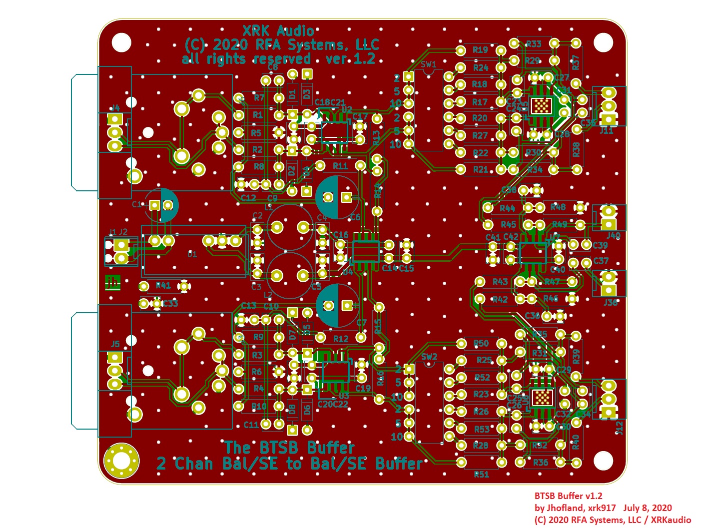

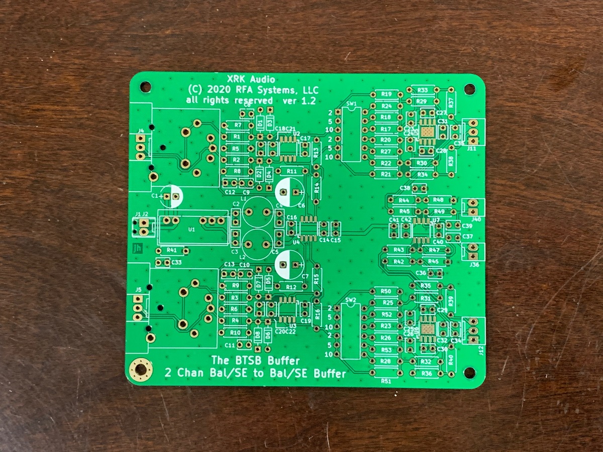

Here is the layout:

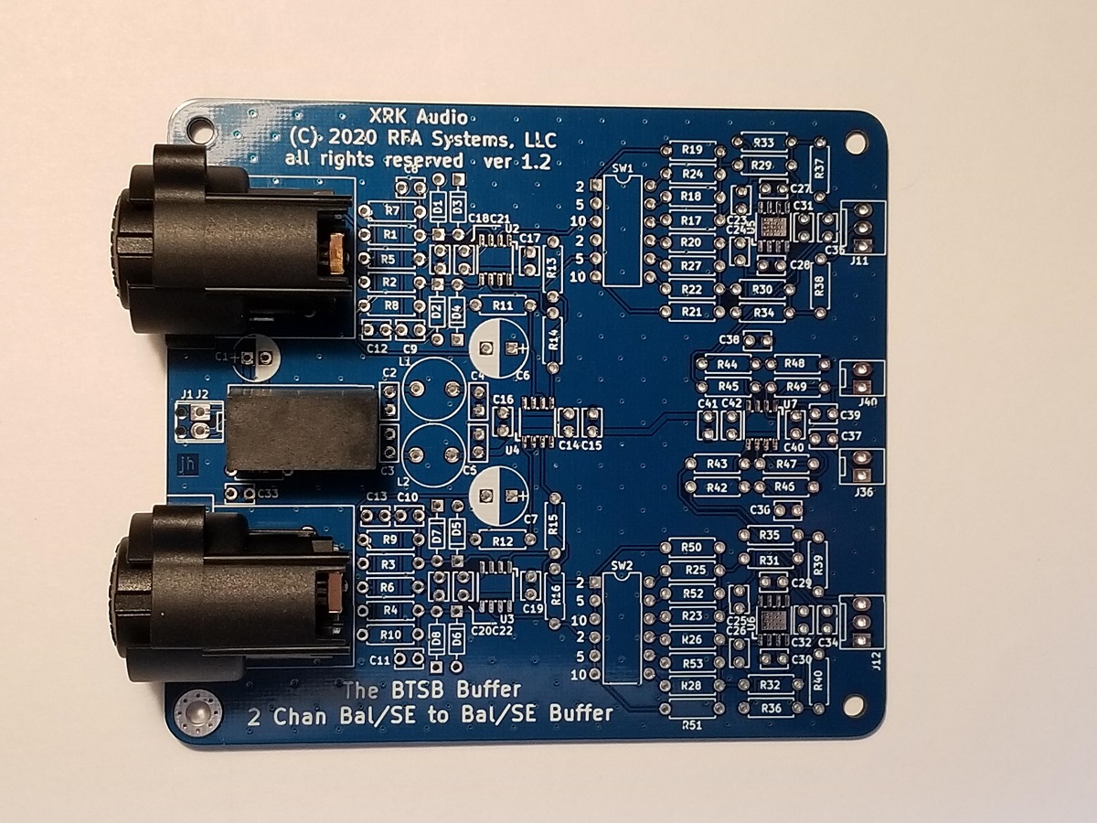

Here is a photo of the PCB with a Neutrik XLR jack (plain Molex KK terminals are also provided if XLR is not needed):

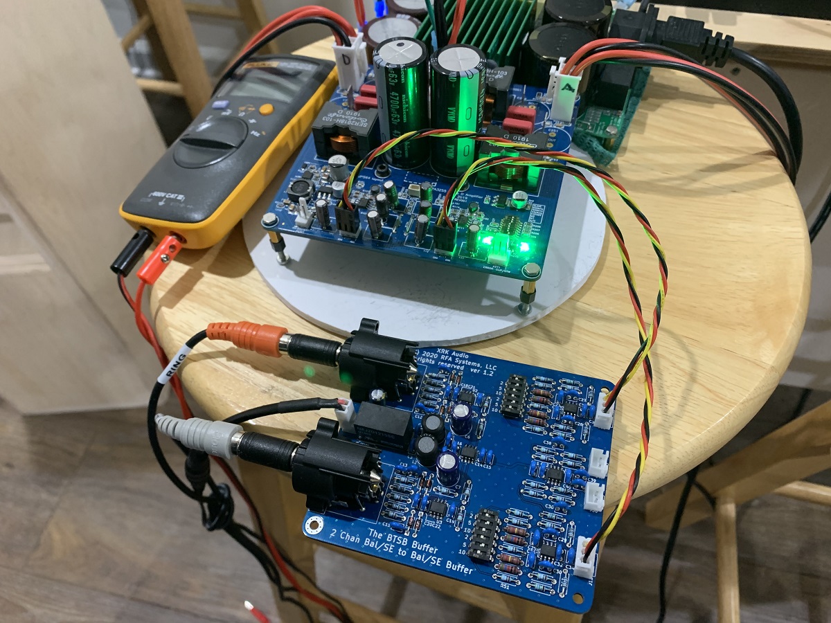

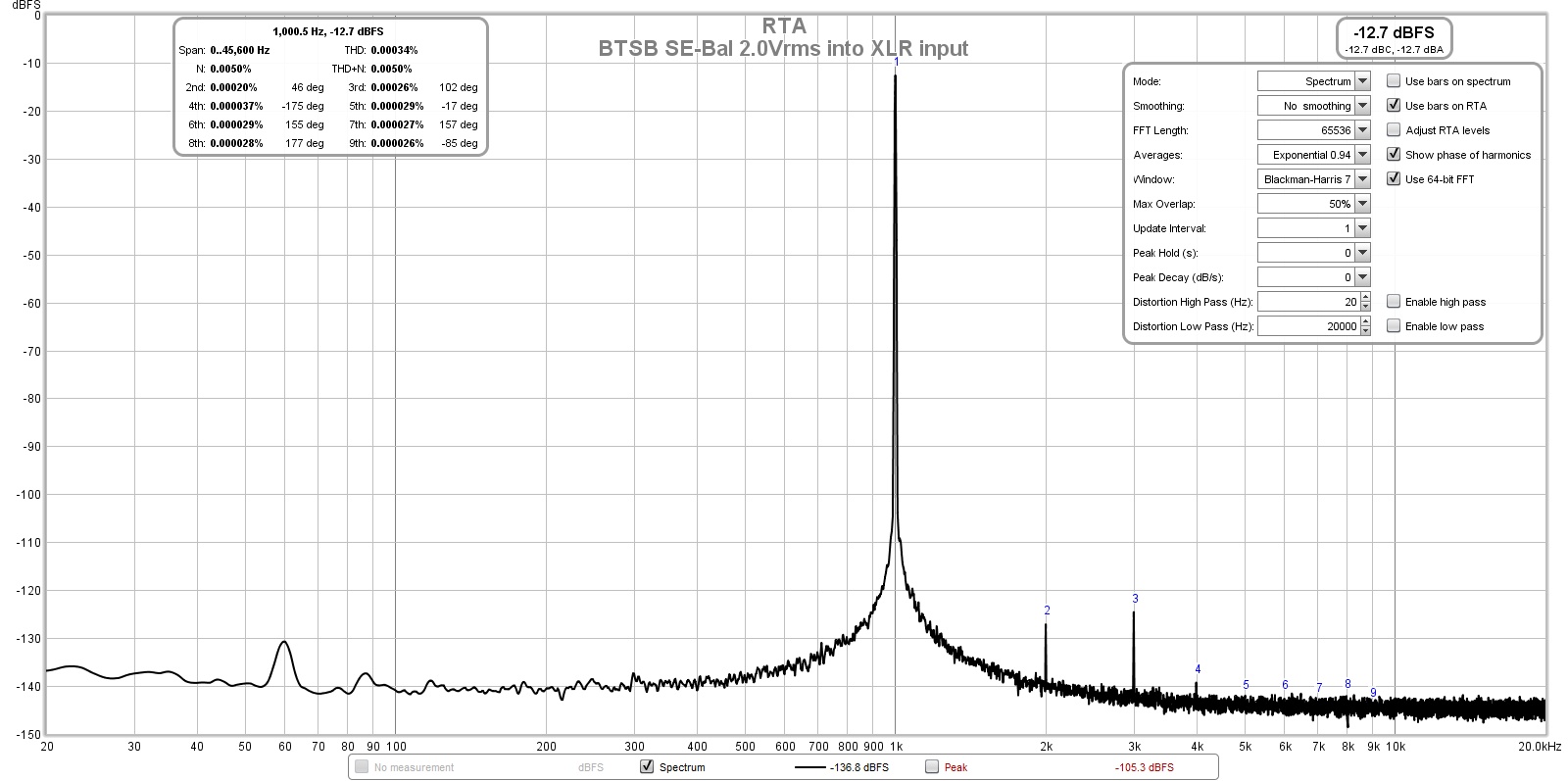

Here is a measurement of a 1kHz low distortion signal from Victor’s oscillator and 20dB gain from SE to Bal mode and fed to XLR input of my Focusrite - the so-called loop back test with BTSB in the loop. It has noise and distortion below the measurable limit of the Focusrite.

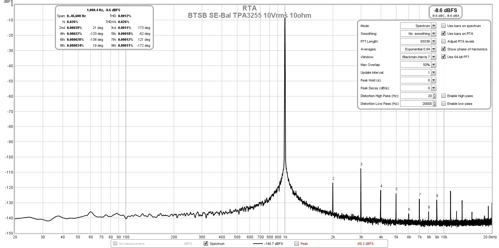

Here is a measurement of the distortion of my TPA3255 w PFFB as driven by the BTSB in SE to Balance out with 20dB gain applied - the THD is lower than the TI factory data at the same condition. The noise baseline is very low at -130dB:

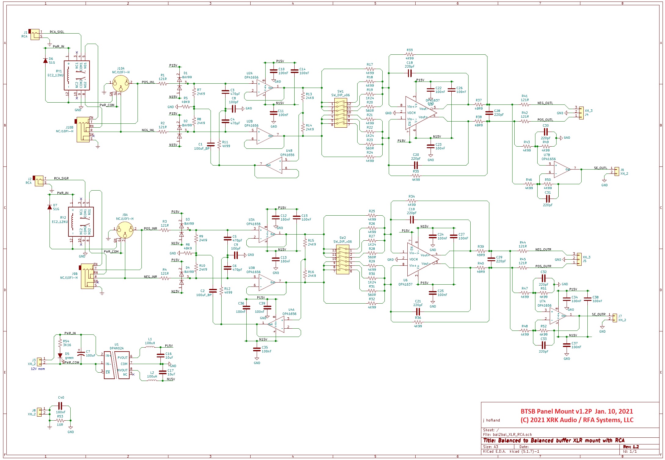

There is a new panel mount version of the BTSB that has separate auto-switched RCA inputs. Anytime something is plugged into XLR/TRS, a relay automatically disconnects RCA's. This version also uses OPA1637 for balanced output driver (uses less quiescent current). Mounts directly to rear panel and no mounting standoffs needed. Very compact and conserves chassis real estate on bottom panel. Also reduces flying leads that can pick up noise.

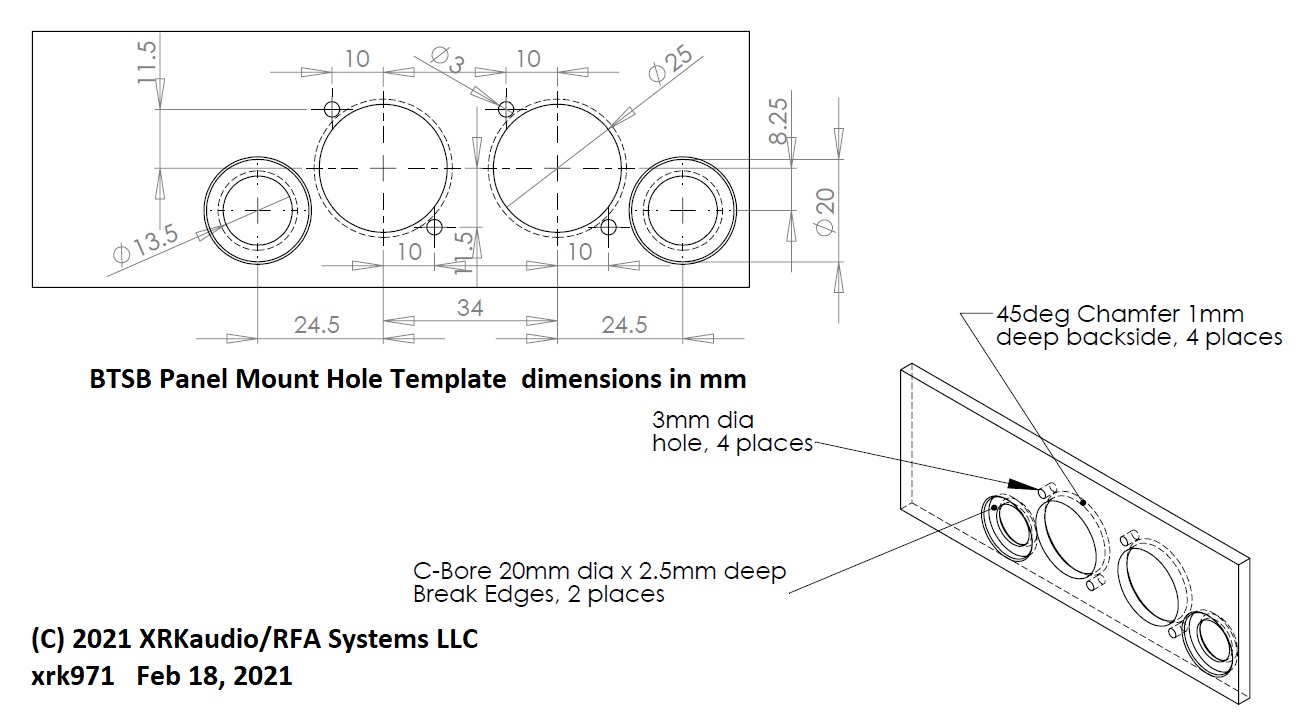

Here is panel hole template. Note that the vertical CTC distance below is for the Elecaudio RCA jacks. If you purchase the RCA jacks from my shop or the RTR BTSB Panel Mount then the distance is 7.25mm:
Board dimensions:
BTSB TH v1.3 board dimensions are 100mm wide x 88m high.
BTSB SMT v1.2 board dimensions are 70mm wide x 70mm high.
BTSB Panel Mount SMT v1.2p is 132mm wide x 45mm high.

I would be interested in two boards only if you have or can provide a drawing that I could use to cut with a CNC machine the holes for the connectors used. Thanks in advance and ai will be waiting for great news from your side 🙂.

Hi Florin,
You can find a DXF file for the Neutrik connector here:
NCJ6FA-H-0 | Neutrik
That should give you enough info for cutting the holes on the panel.
X
X

Jut wanted to let you know that I am finally back from vacation and tested the BTSB v1.2 as a verification build (by jhofland). It sounds fantastic! Very nice sounding, super neutral, super transparent. Adds exactly the amount of gain you need with a flick of a DIP switch! 0dB (1x), 2x (6dB), 5x (14dB), or 10x (20dB). Listening to them with my TPA3255 amp right now.
Please note that PCBs you will receive are 1.6mm thick, green, 1oz copper, and ENIG finish. Like this:
