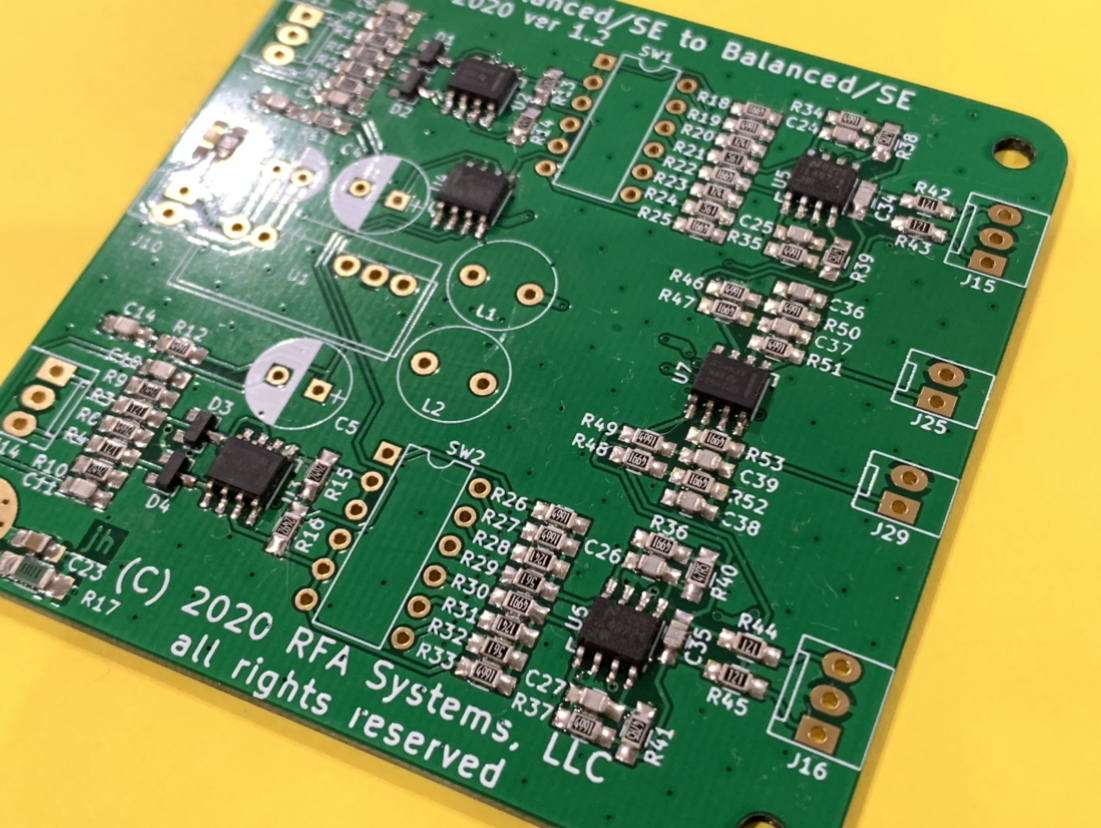

I am sorry to tell you this, but there is an error on the BTSB board v1.1 and v1.2 and the SMT boards. When I built the verification board, I failed to test the SE outputs - I have been told by a member who contacted Jhofland and together, they determined that the phase on on the J36 connection is flipped. Having just ordered a new set of boards (now with this error), I will have to get a new set ordered and send out replacements to everyone who has already bought one. If you have not started populating them, you can wait for the new ones. Or if you have no need for SE out, you can go on as usual. There is a workaround by crossing some resistor legs on the TH board. The SMT board is not so easy as it requires cutting a trace and adding a jumper.
Please accept my apologies for this error, and I hope to send you replacements free of charge as soon as I get them in. Please PM me or send me a message in Etsy to confirm that your shipping address is still good, and how many boards your ordered.
It was the one thing I did not check, and of course I should know Murphy's law well by now.
Thank you,
xrl971
Here is the workaround if you have already populated your boards:
To fix the through hole version lift one end of R42 and of R43 and reconnect R42 to the pad for R43 and connect R43 to the pad for R42.
To fix the SMT board cut the trace from R35 & R39 to R47 at R47 and cut the trace from R42 to R46 at R46. Jumper from R35 & R39 to R46. Jumper from R42 to R47.

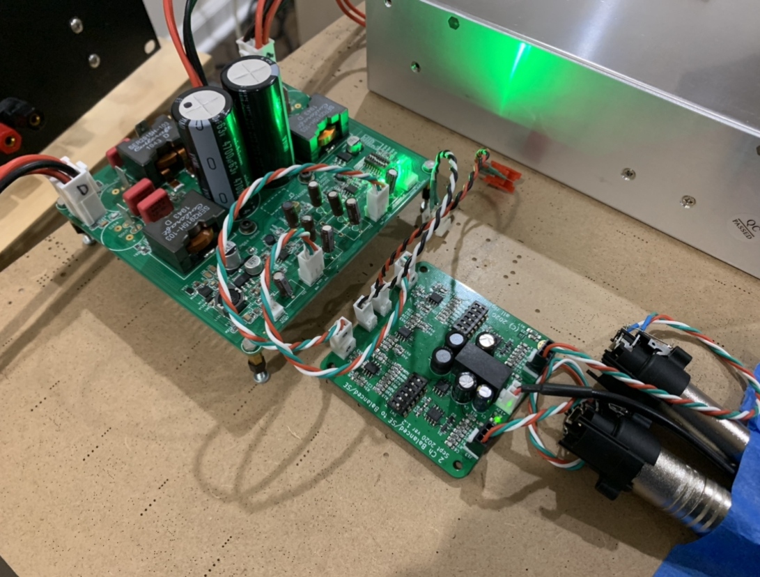

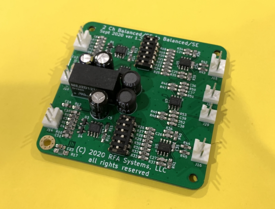

I finally got a chance to assemble the BTSB SMT v1.2. Will test tomorrow - need to assemble some Molex KK connectors between the source and the amp.

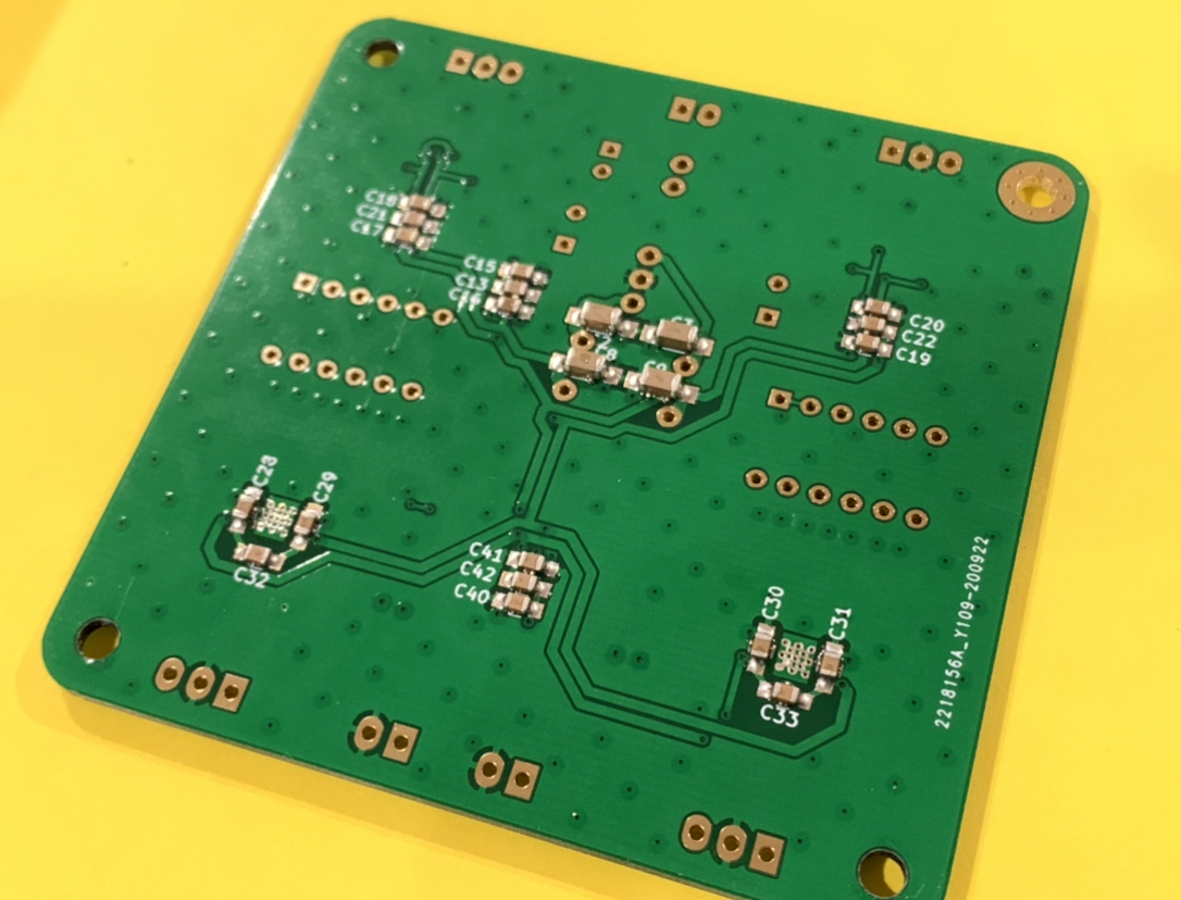

Solder paste applied with syringe and tapered plastic nozzle (blue one), hot plate on bottom and hot air pencil on top:
attachment.php
Bottom side has bypass caps all done with paste and hot air pencil:
attachment.php
Then through hole parts were quick and easy:
attachment.php
A very enjoyable build.

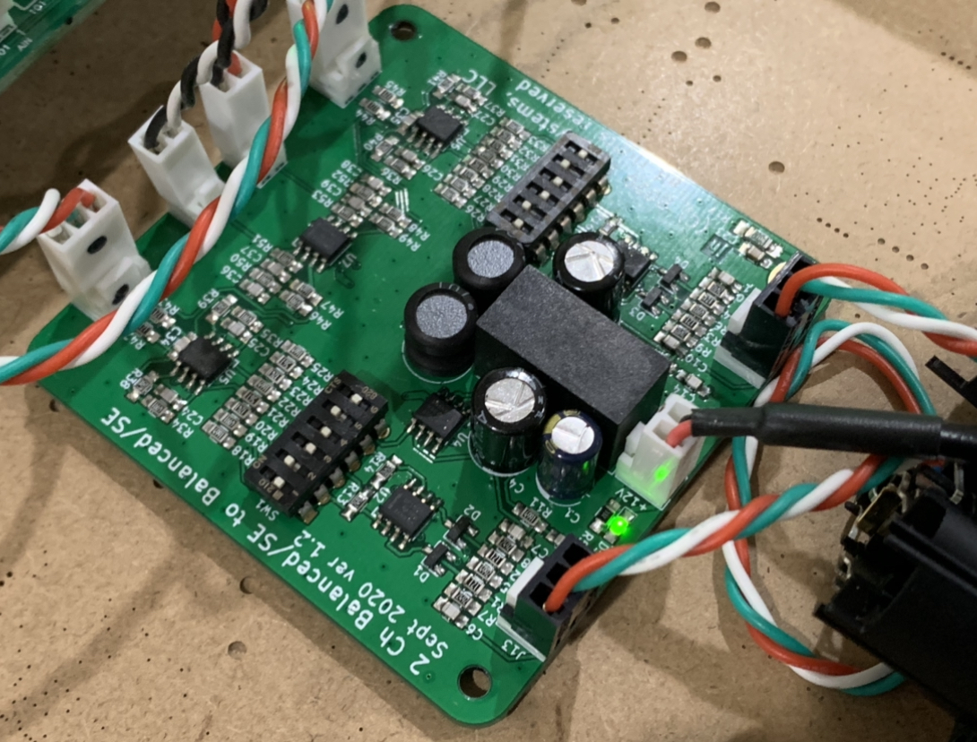

Hi Vunce,
Hopefully it fires up without any issues. As you pointed out, a 3-pin Molex KK can be inserted where the DCDC is and use an external PSU that provides +/-15v. However, I think that the built in Murata isolated DCDC and CLC (2.2uF 50v X7R / 100uH / 2.2uF 50v X7R) is a very quiet and effective combo. All it needs is 12v in from a Class 2 wall wart. Many SMPS have an auxiliary 12v supply output.
The SMT BTSB has been tested with SE output (with FH9HVX) and Balanced output (with TPA3255). It works and sounds great. Totally transparent and very quiet when music is not playing. I also tested out the various gain settings using the DIP switch. It all works just as intended. Nice to ha e 0dB, 6dB, 14dB, AN’s 20dB on tap.
