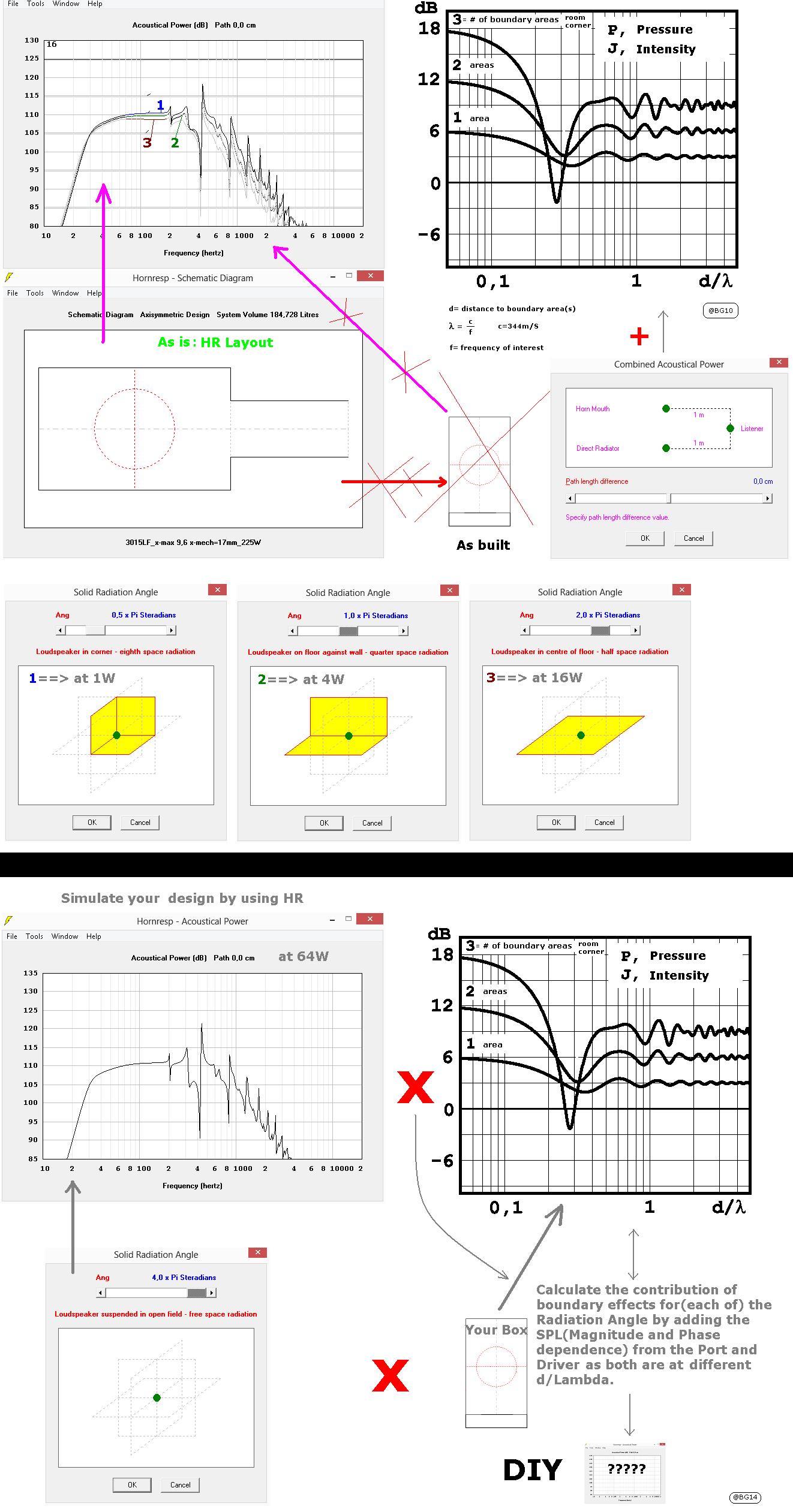

I still stand by the fact that hornresp does not accuratly represet multiple vented cabs (or a vented cab in 1 pi/ .5 pi) because it displays a lowering in tuning (frequency of displacement minima moves to the left)

FWIW, I just did a quick and dirty experiment with one of my small vented cabs and yes, there is a small but measurable downward shift when I "load" it with a corner. The upper impedance peak also noticeably decreased.
hornresp would likely predict a shift of about 5hz in that example. (I'm assuming that lower impedance spike is around 45?)
I haven't modeled the enclosure in HornResp to see what it would predict.
I measured the enclosure in free air, and then mounted up close to where a wall met the floor, so it was more in 1PI rather than 0.5PI space.
As it wasn't perfect 1PI loading, I don't expect that the measured result would exactly match any HornResp prediction, but it certainly shows that there IS an effect on Fb when the loading on the system is changed.
First: Agree with Brian's findings...
Couldn't resist: Don't blame HR,: Blame your ignorance in Applied Acoustics.
IMO it is stupid to do an Apple to Orange comparison when building a Speaker Box that differs in outline compared to the default of the HR Schematic Diagram.

Sine, the larger and more efficient the cab, the bigger the shift - thus you wouldn't notice much on a little computer or sony home theatre sub but in a 10 cubic foot 18 cab there would be quite a bit. It's probably caused by the extra air resistance loading the ports (or approaching the efficiency ceiling.)hornresp would likely predict a shift of about 5hz in that example. (I'm assuming that lower impedance spike is around 45?)
In simulations of tapped horns it happens too, although the advantage seems to be squashing the displacement peaks, whereas with bass reflex they grow (as if you lowered the tuning). With front loaded horns I'm not sure.
The predicted helmholtz of my vented 3012lf cab goes from 40.66 Hz to just above 37Hz. Half space to corner. I'll have a look with my eye at the cone next time I get the chance. I always corner load anyway.

In response to sine143, this design is predicted to lower its tuning A LOT when corner loaded, especially 2 in a corner. It can be a blessing and a curse (if you favour high SPL and headroom) My tapped horn design in progress (For Faital Pro HP 1030/1060P or 3012lf or 6 MCM 55 2421) seems to be more resistant to the 'corner detuning' phenomenon, although it still does it slightly, it actually reduces displacement instead of increasing it in the BR designs. THs also draw more power when corner loaded.
