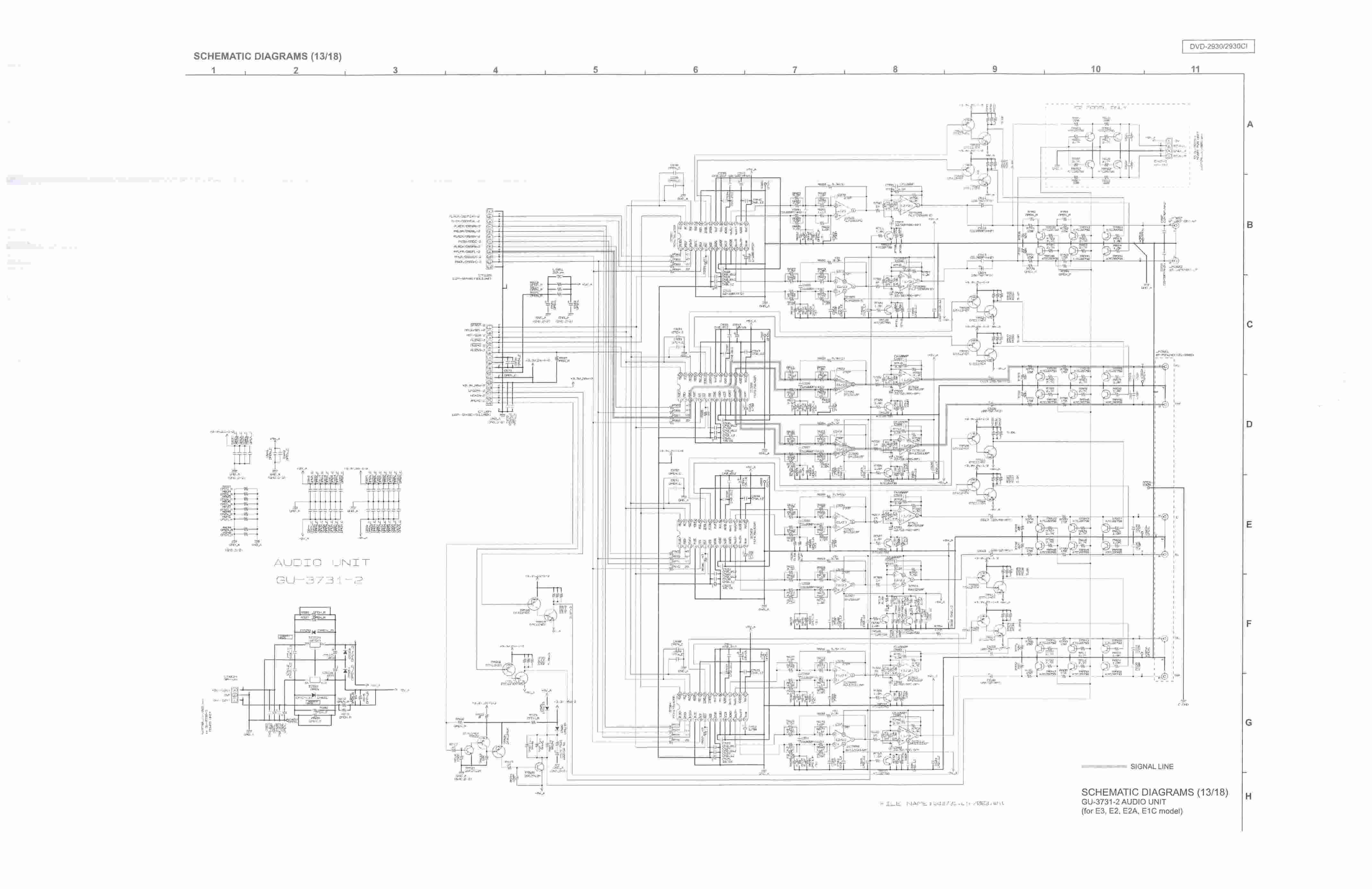

Russ and Brian,
I have a Denon VD-1930 that I modded to get the DSD signal. I am getting some serious noise when I plug the Denon in. The system is quiet and then it sounds like a ground hum with static pops when I plug in the Denon. I am ready to scrap the project due to frustration. Any ideas? It looks like the solder joints are clean. It sounds good except for the noise.
Russ and Brian,
Would help with more info on how everything is connected.
I figured it out. I had to add a earth ground to the Denon and it is as quiet as a mouse now.
