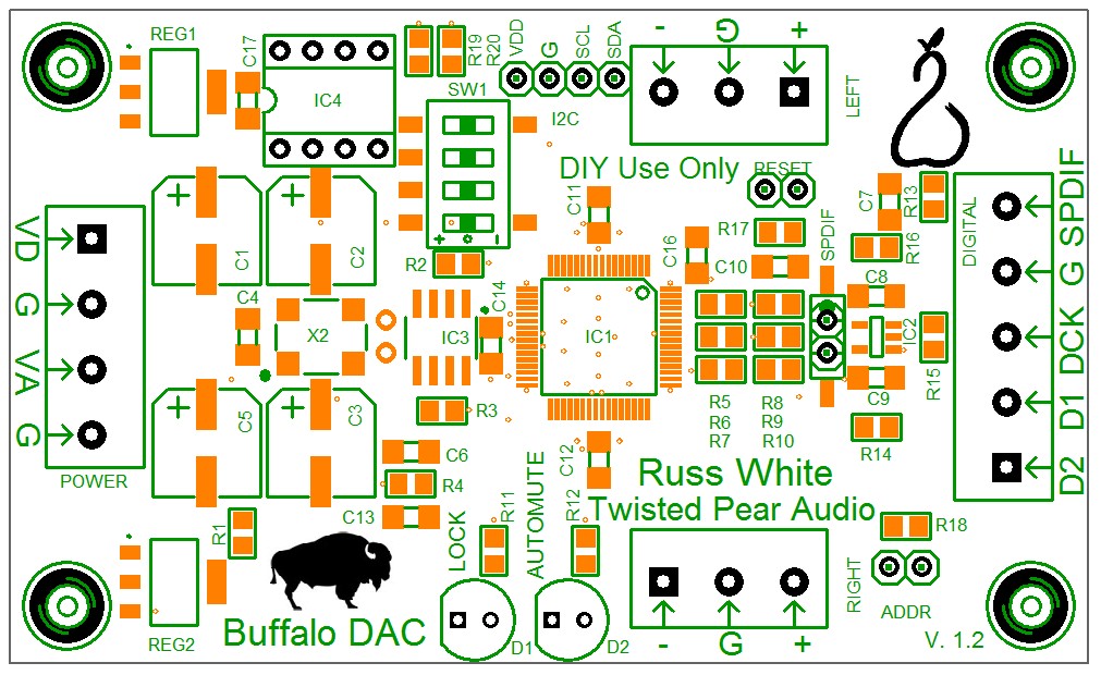

I'm looking at my Buffalo now wanting to upgrade the clock supply. I'll use a PFM Flea 3.3V with a dedicated supply but need to cut a trace from C2 to the clock.
Does anybody know which of the 100uF electrolytics is C2?
Hi RichLund, you can see it here: http://www.twistedpearaudio.com/images/digital/buffalo_layout.jpg

And thanks for the info Russ. For the clock supply mod should I cut the trace before C2 (between reg and the cap) or right by the clock.
Also what is the current draw of AVCC?

I upgraded the clock supply with a 3.3V Flea regulator this weekend. A nice little mod, better clarity and separation in the music. Certainly an improvement.
The trace to cut is hard to see, you need to hold the board up to a light to really get an idea where it is. I have indicated the trace on the layout diagram below if anybody is keen to try.
