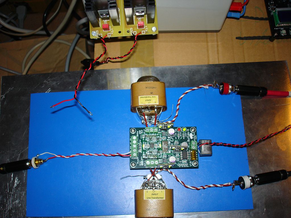

silver rock transformer output stage
This is exactly the configuration I've been seriously considering for my Buffalo IIs, although I haven't pull the trigger on silver rock due to its cost and the lower dynamic range of 9018 chip when voltage mode is used. Did you compare this with any other output stage? Or can you give any comment about sound characteristic of your modded CDP with any high end CDP?
Thanks!

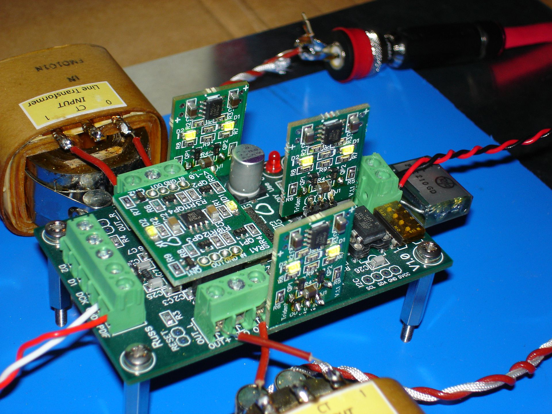

Jeffrey, As I understand dual mono, two Buf modules can simply be paralleled into one pair of transformers.
I'm two days into a Buf II with Tridents and Placid PS into 1:2 Audio Consulting New Silver Rock transformers buffered with LME49600, all on SLA battery power. This is a righteous sounding combination.
Can anyone describe what they hear with dual mono vs. one Buffalo? Tough to leave well enough alone.
Thanks!
rdj845, I have only tried B2 with battery-powered Placid & Tridents through an output stage of Audio Consulting Silver Rock transformers and battery-powered LME49600 buffers. My guess is that together with galvanic separation, the well powered and bypassed buffers do the best than can be done with B2 as a voltage source. This output stage has been proved out by Reference Audio Mods across a wide range of modified CDPs. Personally I can only vouch for it in my modified SCD-1, where I directly compared buffered transformers coming directly off the DAC to several approaches using an I/V stage. There is a lot to be said for a very simple, optimally powered circuit coming directly off the DAC chip with a minimum of piece parts to get in the way. It's the best RBCD I've heard, and I do get out to CES, RMAF, Axpona, etc. to hear many commercial alternatives. The buffer is critical to adding dynamics and detail that go missing with passive transformer output. People praise the smooth relaxed quality of naked traffos; IMO this suggests a loss of current drive.
The further improvement with dual mono B2 was surprising. More detail and separation and a tremendous payload of dynamic energy on transients and decay.

In dual mono two transformers are sufficient. The DACs in each Sabre chip are summed by jumpering the left & right outputs—taking care that the jumpers are crossed over to obtain correct phase.

Two transformers, whether in stereo or dual mono. In dual mono the stereo outputs of each Buffalo pcb are paralleled-- both configurations look the same to the transformers except for the lower output impedance associated with dual mono. The Silver Rocks don't have a centertap. Connect the primaries to (+) and (-) at Buffalo output and float Buffalo ground. Connect the transformer secondaries to XLR pins 2 & 3; for SE output you ground the (-) phase. The buffers can be placed on either side of the transformer, but the number of buffers varies depending on their position and whether SE or balanced output is desired. I buffer the secondaries, with one buffer chip on each of four phases into two XLR outputs. For SE output just two buffers are needed, as anti-phase is tied to ground. Placing the four buffers on the transformer primaries makes for simpler wiring on the secondary side if you want the ability to switch between XLR and RCA outputs. In this case you would need to add a toggle switch between XLR pin 3 and RCA barrel.

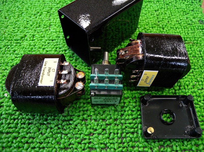

ESS9018 specially made IV transformer from Japan and Feastrex
New Japanese ESS9018 IV Transformers –a mini review
Executive summary: these new Japanese transformers are the best sounding IV transformers that the author have ever listened to, and compared to a highly modified Legato and a fully discrete all-FET IV converter, these transformers are sonically hard to beat.
I have tried both the amorphous core Lundahl LL1684 and Sowther 9545e audio transformers applied as IV converters, and although the sound has been good with the LL1684:s, and OK with the 9545e:s, they did not sound as good as the discrete IV converters I have. I actually gave up on transformers even though they had something special sonically. Instead I started to modify and upgrade my Legato, IVY, and fully discrete FET IV converters with new components, and the power supply super shunt regulators were modified as well.
I thought that I´d given up on transformers as the ultimate IV converter, when a few months back, Bunpei wrote to me about a new Japanese transformer distributed by Feastrex*, that was made especially for the ESS9018 DAC, and that this transformer used a special type of core material called FINEMET, which is a nano crystalline soft magnet material. I checked out the new material and got a few photos of the transformers, and two weeks later, I had a pair of unusually heavy transformers hooked up with solid core silver wire to my reference DAC, the Buffalo II with the three Tridents installed, playing music from the SDTrans384 memory card player I use daily.
Compared to having a dual mono, discrete IV converter with dual toroids for raw power supply, and dual super shunt regulators to feed the converters, hooking up a similar transformer setup, is unstressingly easy. For each channel, just connect two (GND is not needed) short wires from the Buffalo2´s output to the transformer, connect the three or two wires (balanced or unbalanced) from the transformer outputs to the line amplifier, and voila, you are done! Well, OK, you need to have a load resistor on the transformer outputs and maybe a small capacitor across the secondaries, too.
I used a 4,02k TX2352 bulk metal foil resistor connected directly at the transformer outputs as load resistor to get 2,0Vrms at 0dBFS into the Buffalo2. A 10nF RIFA PFE210 film and foil polystyrene capacitor was also soldered to the outputs, as I, on my oscilloscope, noted a ringing when only a resistive load was used. The cap removed the ringing, and also made the treble sound as it should. For the experimental person, lower resistance values and made of other resistor materials, and ditto for the capacitor could be fun try out. If a lower output voltage is wanted, just lower the resistor value. One could even use a volume control of top notch quality connected at the secondary windings to get the master volume control for one´s complete hifi system.
