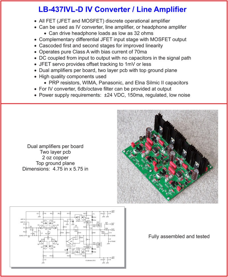

It has a pretty low output impedance and I guess buffer stage is unnecessary. Right?

yes, as others have said, there is a very good chance you dont need a buffer. The borbely design is specified to drive low impedance headphones, so driving some cables and an amplifier input wont be a struggle (although I wonder if they realise how low they go these days)
regarding the borbely IV, its a rather esoteric, but well designed discrete circuit. His designs always use rare and hard to source parts; mostly the fets, but by now, probably a lot more than just the fets. Do you actually have a populated board for the IV, ready to run, with power supplies? (good chance it will require more current than what is available in the player). If not, how were you planning to source and match the required parts? can you buy all that from fetaudio? I guess it was spencer that took over Erno's kit business. Do you have the knowledge and equipment, as well as budget for that? If you have just been told the borbely IV is good and opamps are crap and are progressing thinking its going to be straight forward, you will be disappointed. You'll excuse me for saying it sounds to me like you dont have the required knowledge for dialling in the IV once you build it and adjusting to suit the TDA. Make sure you get spares for the fets while you are at it, they will not be available forever and the price keeps going up. I'm not sure your friend is helping matters ...
