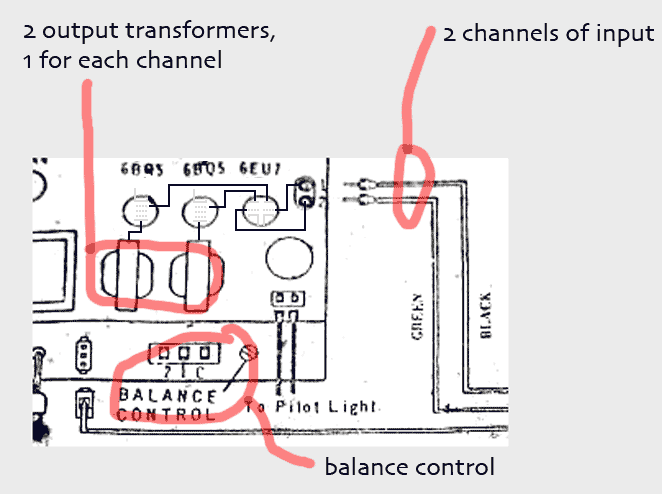

bacon665 said:I didnt mention the at7. His set up is currently single channel.
His current amplifier is stereo. (12AT7 = ECC81)

RH84 is a straight power amp (althou a 100k pot can make it a simple integrated). A preamp does the fancy stuff.

bacon665 said:Planet10 How do you see the current amp being stereo when it has a record player and no tuner?
I'm not sure how the available sources are relavent. The amplifier has 2 output transformers = 2 channels

Unless its pushpull or one for each load. If he would trace where the wires of the balance pot goes it would settle this.
I do need to remove the amp from the console. I haven't yet because of the way the power cord is secured, has a clamp on it in a strange way, hard to get to the screw holding the clamp. I will get it out and trace the signal path. What is the technical definition of Stereo? I always thought it was two seperate channels all the way to the speakers.
bacon665 said:Unless its pushpull or one for each load. If he would trace where the wires of the balance pot goes it would settle this.
I've seen enuff of these to be pretty sure what it looks like... It is a stereo single ended pentode amplifier except for the detail it will look like the map i posted earlier.

Im not sure what the exact definition is because you can have two monoblocks or two sets of speakers hooked to one amp.What is the technical definition of Stereo? I always thought it was two seperate channels all the way to the speakers.
is there another speaker hook up where this image is cut off?
Or is it just the green/black single channel.

bacon665 said:is there another speaker hook up where this image is cut off?
No speaker connections i can see on that diagram... but lots of clues that it is stereo...(including 2 independent speakers just off the page)

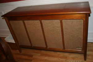

Where does Admiral rank in the console department? This is a new listing on CraigsList. The tuner looks to be solid state. I may go look at it. I really like the look of the cabinet. Maybe I can hide more than just a turntable in one so I can keep collecting them. One will have a washer and dryer, refrigerator, garbage can, toilet, dog water bowl.....

Prolly not great electronics, but it sure looks good. Knoxville seems to the capital of old consoles!
For $50 I'd take it. =)
901Fixer said:Where does Admiral rank in the console department?
Probably not a dog. We do know that they were the ones with Tunnel Reflex, which have been the North American supply for Foster FE103A.
The TT in that one looks of an age to expect tubes in it.
dave
I wasn't able to get by to see it today so I'll have to wait until Saturday. I doubt I'll get much competition. The seller says both TT and reciever turn on and work. Is there anything in particular I should look for on this one? I'm gonna check this one over better than I did the last one, it wasn't in as good a shape as the seller let on but I'm still glad I got it.
What would you guess this has for drivers? Just two of the Foster 103A type drivers or a bit more involved?
What kind of TT does that look to be?
As long as I can remember Admiral was a cheap drugstore brand. Most that were in that class were coasting on a famous name from days gone by that had impressed the world many years previously. I wondered if Admiral had at one time been a sought after brand instead of just generic vendor rebadged junk.

Was Admiral ever a quality brand name? This unit looks to be on the same level as the Magnavox but I haven't actually seen it yet.
I picked up the Admiral yesterday. It is pretty heavy. Has alnico drivers but I haven't removed the back to see what they look like but they feel to be about the same size as the Magnavox. This console has 2 or 3 amplifiers. There is one that is part of the reciever and then another assembly below it on the shelf between the drivers. I have the owners manual and it states that this unit has individual amplifiers for left and right to produce the amazing true stereophonic sound and play this new FM Stereo broadcasting technique.
