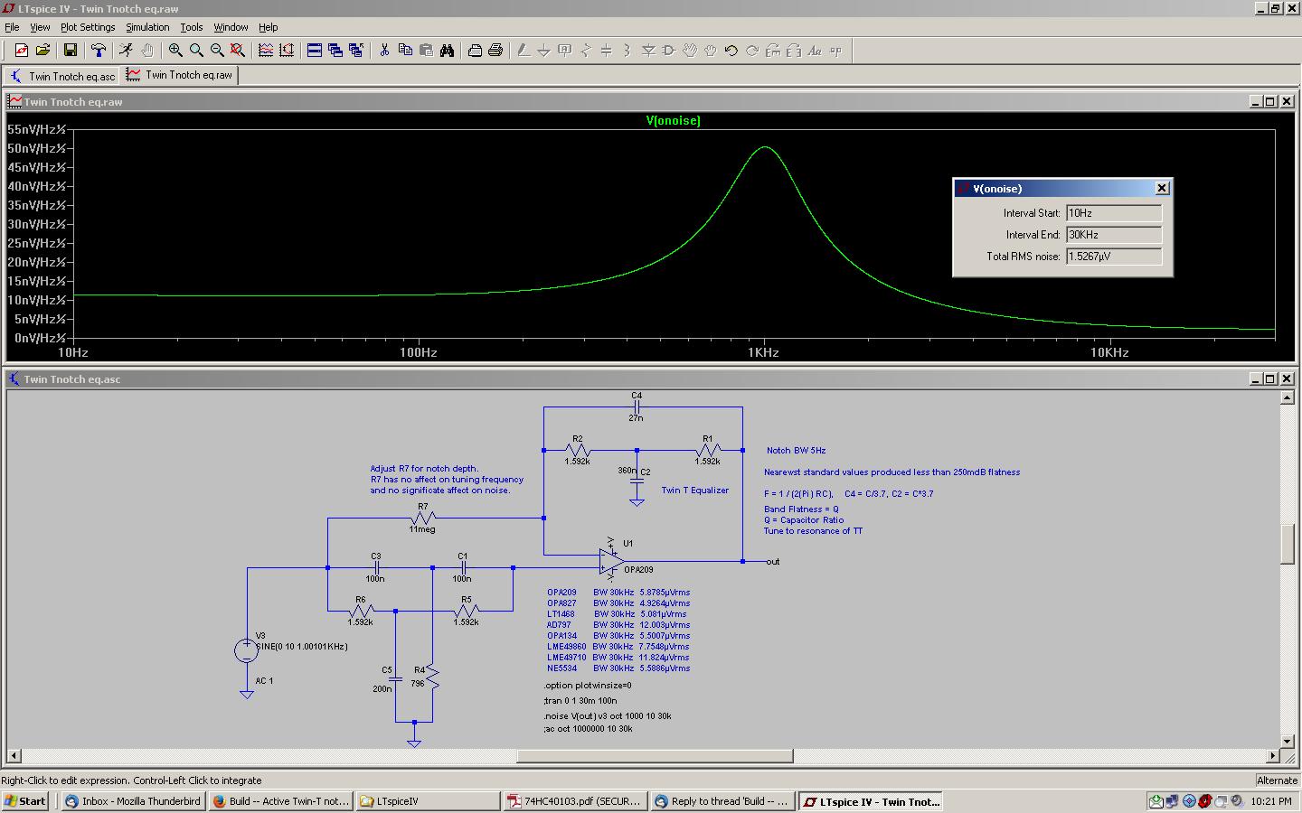

Excellent post David. I took your proposal and implemented it into my circuit with positive feedback and tweaked the values to achieve a controlled 40dB notch with about the same Q value. With the feedback option I can also get the notch down 98dB by varying resistor R7. I did also counteract the feedback resistor noise by dividing resistor values by 100 and multiplying cap values by 100. Haven't run noise calculations yet but I guess it won't be very much higher than yours.
Have you by any chance measured your output noise using AD8429?
The idea is to eliminate the positive feedback all together. Both seems bit redundant.
But build it see how it goes.
Joined 2004
Good news and bad news. I got the notch working and it works as predicted. A little tweaking and tuning and I have a -40 dB notch centered at the target frequency. Bad news is that the Q multiplier is actually creating distortion. I was getting more second harmonic than I should on the output. So I measured the input and the second harmonic is increased from below -140 to higher than -130 when the Q multiplier is active. In the passive mode all is fine except the notch depth is around 50 dB the way I have it tuned. I'll boost the gain to 50 dB so the analyzer/FFT have something to lock to. I still want to solve this issue. Perhaps its a problem with the q multiplier opamp running with output tied to the - input with no resistor. Tomorrow. . .
Scaling values by 10 and using the opa209 brought the noise down to 1.53uV in 30kHz. -161 dBV.

So far with all the tricks I'm still running into limits at around -150 or so. The good news is that the LME49990 is at around -135 dB on the harmonics as a 40 dB amp at 3V out. That would suggest -175 dB at unity gain if it were possible.
Now the need for an unbelievably good buffer amp to drive the filter appears again.
