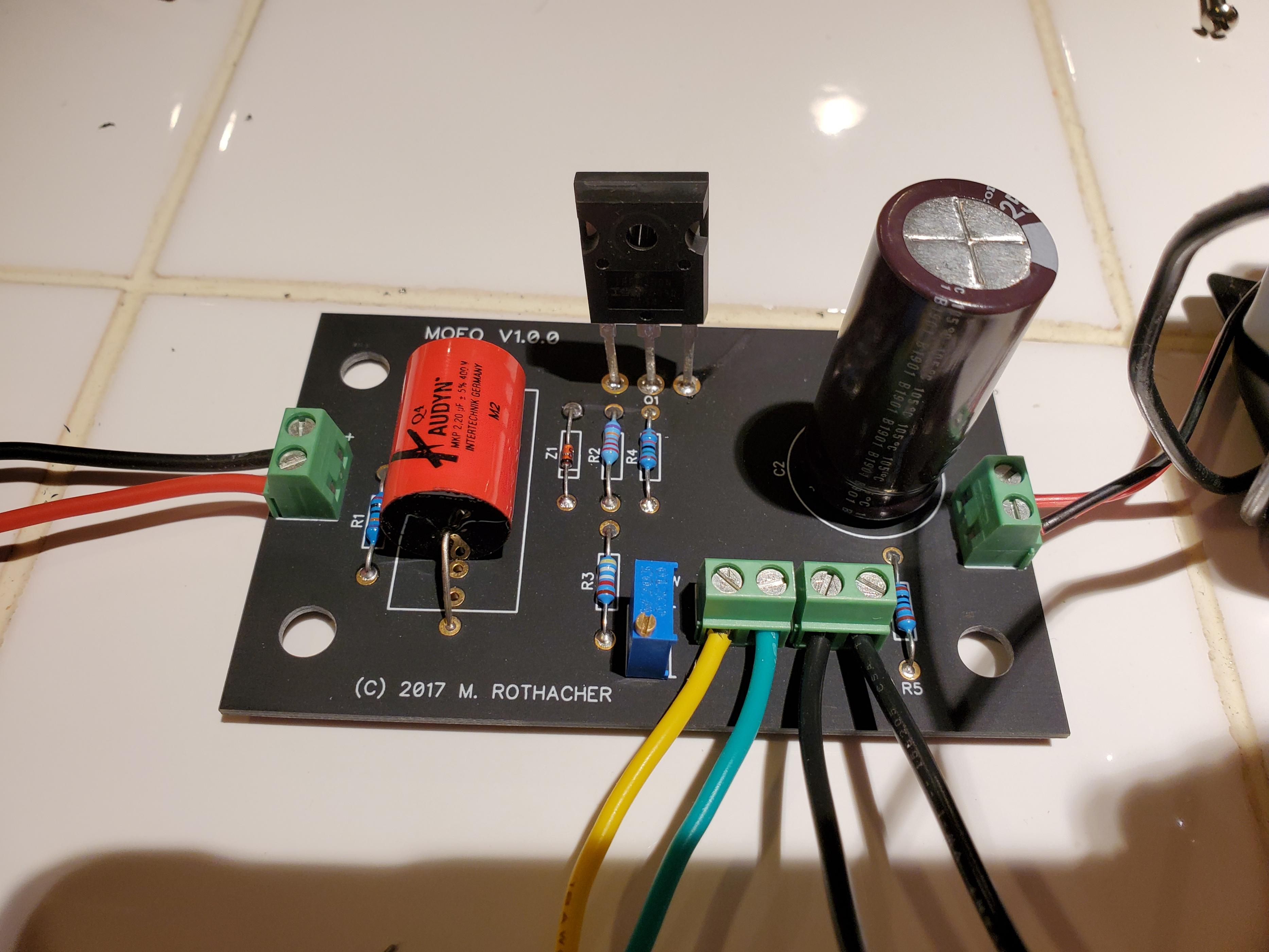

Hi Folks, brand new builder here!
Project was built to spec, but every time I attempt to bias, the FET overheats despite heatsinking. Fried both channels once already. FETS replaced and same issue. Anything over .10v across L1 and things get hot.
Slowly digesting the theory but any thoughts on what I'm doing wrong? Thanks in advance.
