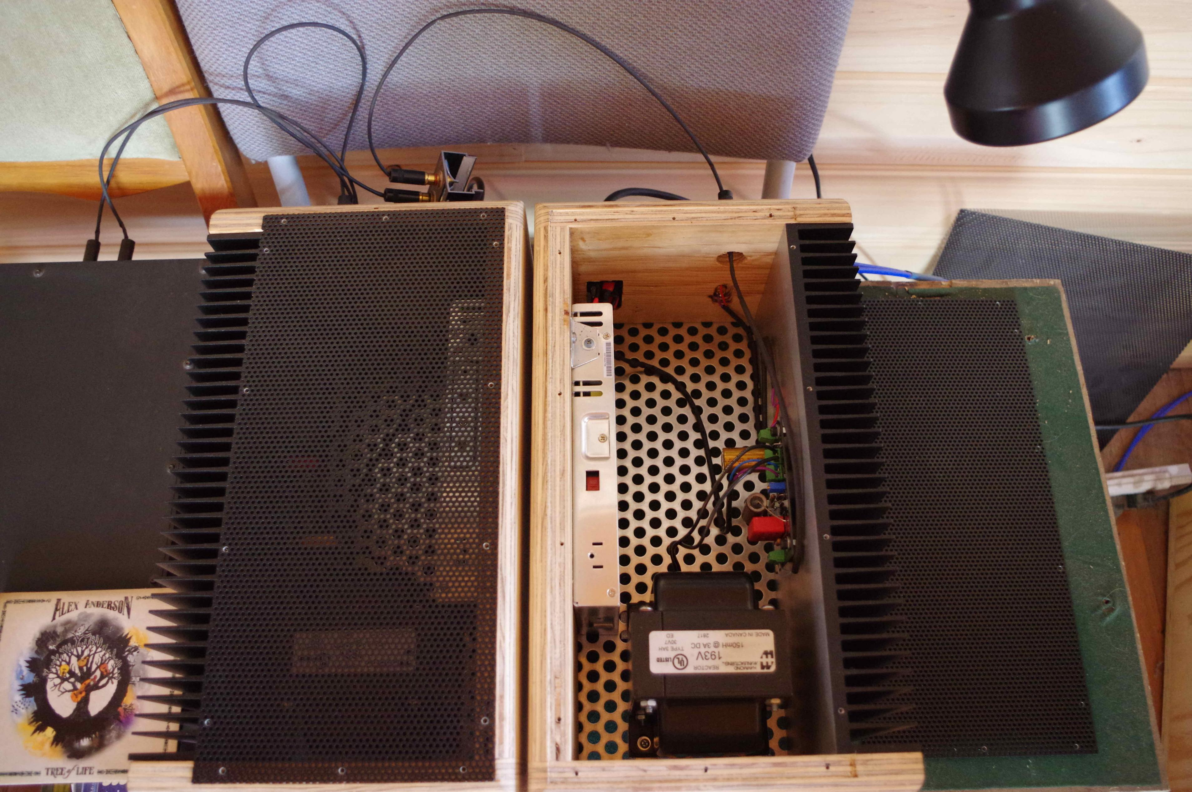

Originally, I used one choke for both the positive and negative sides but I believe it became saturated. The choke became hot to the touch when I set the bias above 1 amp. Once I complete the chassis, I will be testing it out again! Thank you!

Not necessarily a positive and negative side. Those chokes are used instead of the Hammond 193T. It’s like two bridged MoFos and I wanted to use a bipolar supply, that’s why I used the IRFP9240. Both sides are mirror images of each other than the positive and negative rails. I’m still learning and most of the times, I don’t describe things very well.
