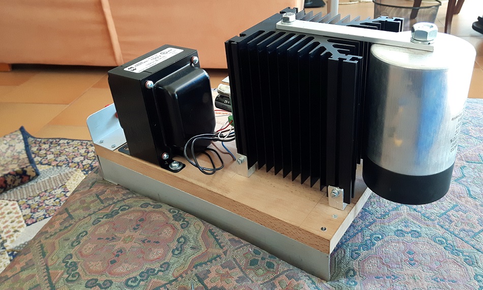

As for me, now that the experiment of placing a battery of polypropylene capacitors immediately after the smps has further magnified the performance of my two monoblocks, I'm more and more convinced that the maximum performance can only be obtained with the tubes but in a separate preamp with its well-structured power supply.
My pre is a single stage (common cathode with 6SN7 with plate loaded by autotransformer) without buffer supplied with a 5Y3 + CLC completely made of polypropylene.
No pre jfet I've tried (DCB1 - Pre Juma - JC-2 clone by J.Curl) manages to have the same reproduction quality especially in terms of dynamics, vitality in the midrange and soundstage. With my pre the Mofo now also appears without power limits (my speakers are the Diapason Adamantes II). I am very satisfied.
Great Amplifier. To be recommended to anyone.

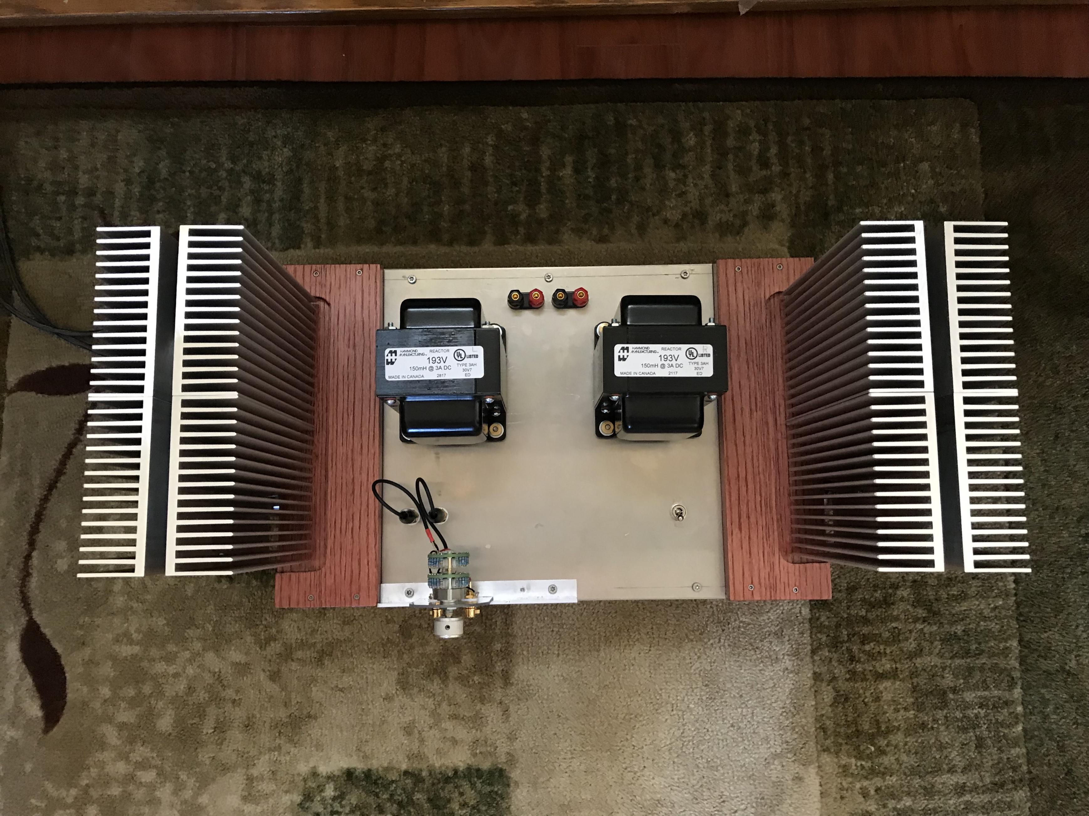

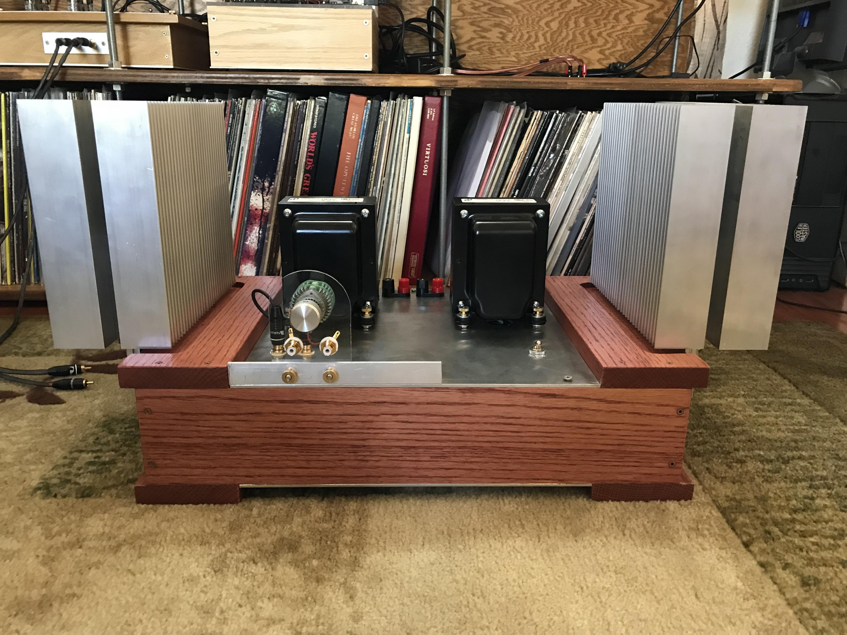

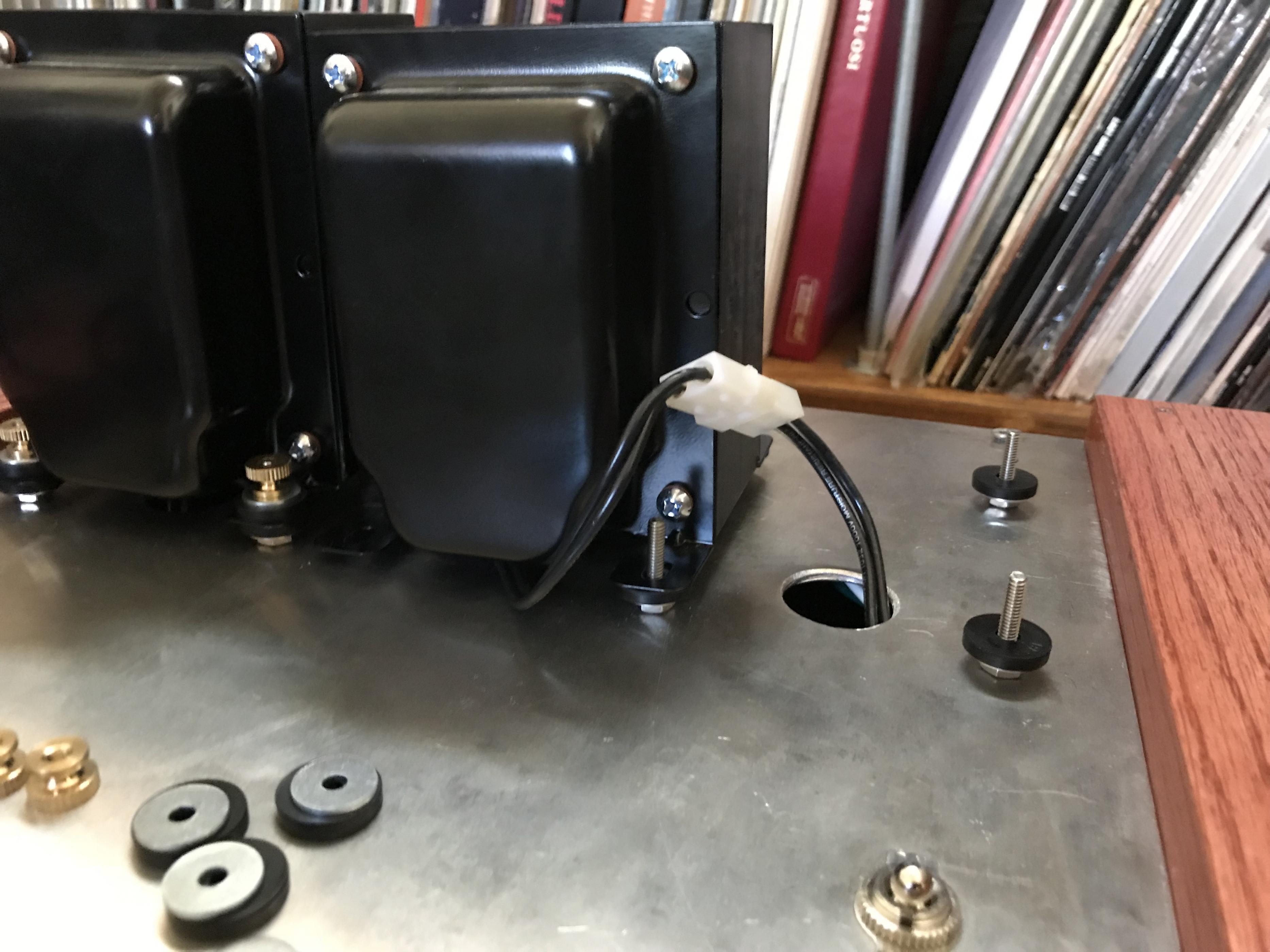

Another MoFo
I've been lurking around for some time now. Had a lot of fun with DDDAC and all its variations. Built an Aleph J which sounds amazing. Now, needing another fix, I put together this big MoFo. I biased it at 2.7 amps. I have a little hum probably from the 500va unshielded transformer. Each major piece of this project seemed to weigh about 10 lbs., so this thing weighs over 50 lbs. I mounted the inductors so that I could remove them fairly easily with thumb nuts and Molex connectors. I need to build a BA3 preamp to properly drive it.
Good!!
another fan :)
I like your design ..... but ... some photos of bottom would explain more
