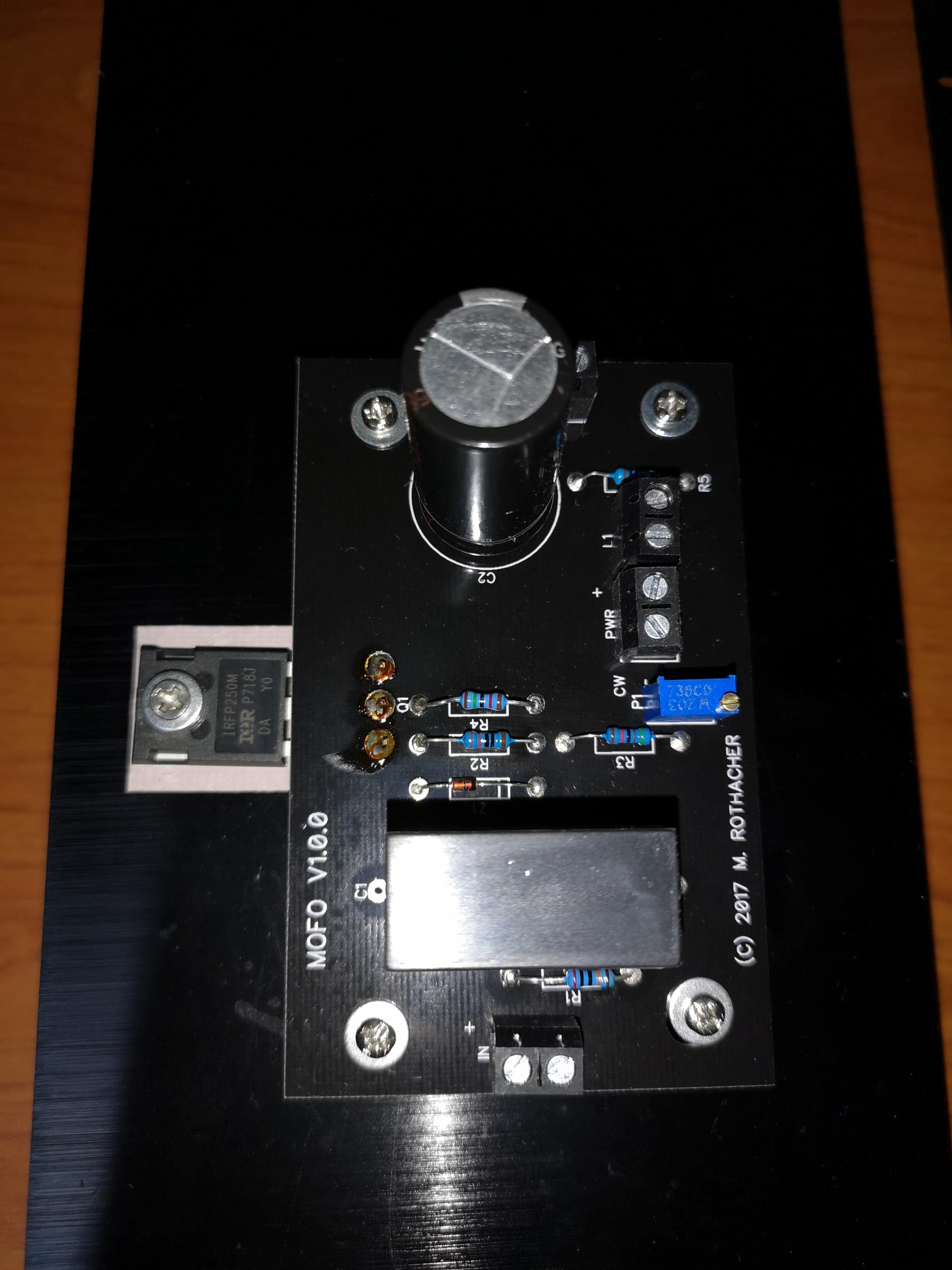

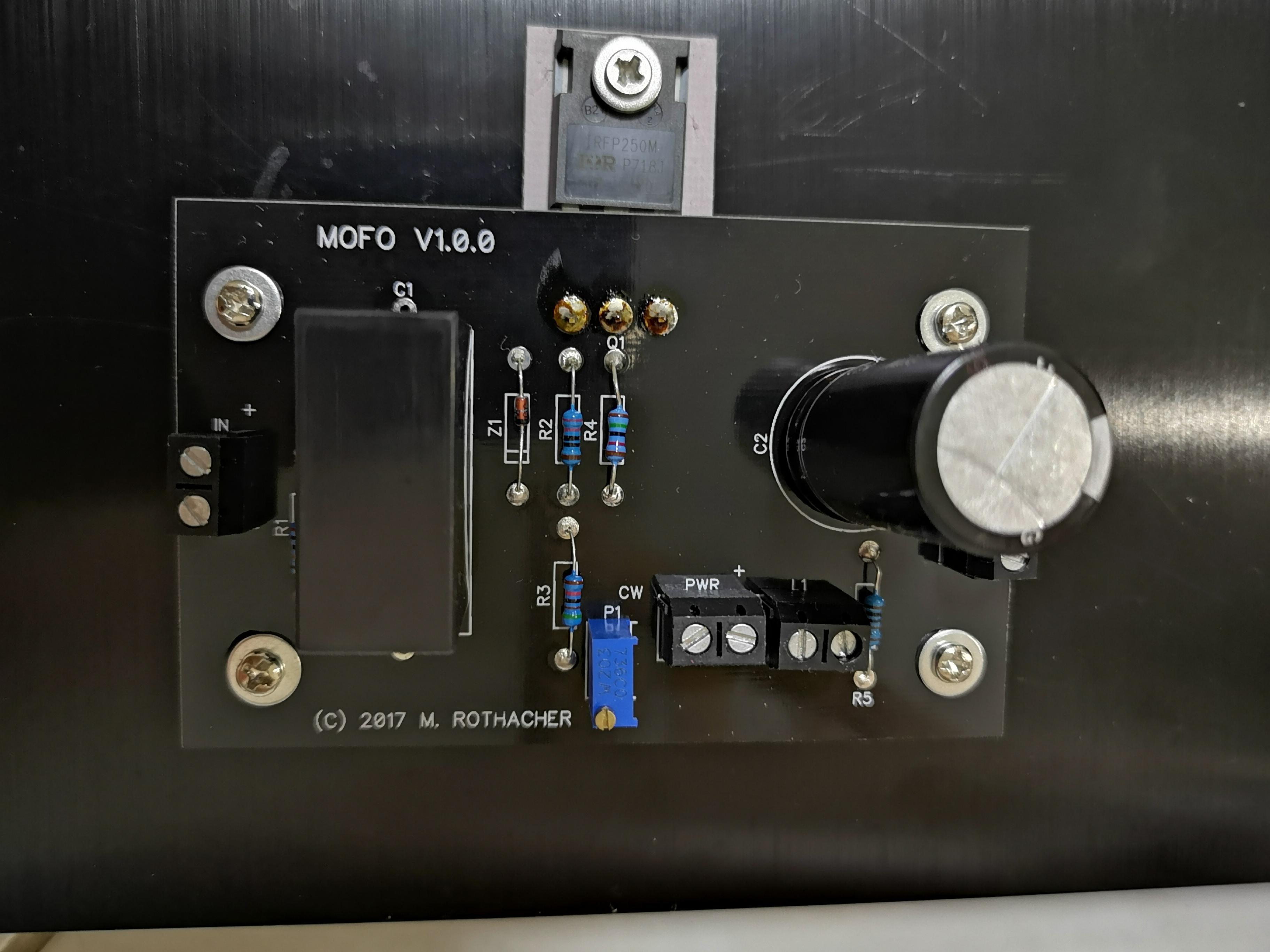

First of all a big thanks to Michael for sharing this great design. I have completed my build of the 24V version of the MoFo and I like the sound very much. Unfortunately, something went wrong this morning. I have built it with a very low priced inductor that claims to be rated at 3.0A (and I am suspecting this is the problem). It has a DCR of 1.3 ohms, so I biased it at a voltage of 3.25, i.e. 2.5A.
Anyway, it has been running for 2 weeks, and this morning while playing some music I heard a pop on the left channel, and after that no more music, leaving a low frequency hum on the speaker. The right channel is still fine. When I touched the surface of the inductor casing, it seems to be much warmer than that of the right channel. I have not started any troubleshooting / measurements yet. My questions:
1. What are the recommended steps to troubleshoot?
2. In case the inductor is found to be faulty, will this be a good replacement? https://my.element14.com/hammond/195s4/choke-70mh-15-chassis/dp/2893269?st=hammond inductor
Thanks & Best regards
Liu
Hi Zen Mod,
Thanks for the reply. I have done the following:
1. On the faulty channel, measured the voltage across the inductor, V=9.5-11.0 increases with time, does not change much when I turn P1 anti-clockwise (many turns). Iq=6.9-8.5 A.
2. On the good channel, measured the voltage across the inductor, V=3.25, Iq= 2.5A
3. Swap the inductor or the normal channel to the faulty channel, V=9.5-11.0, same as step 1.
So I can now conclude that the problem does not seem to be caused by the inductor. So how should I proceed? Attached are pics of the finished chasis and the faulty channel mounted to the heatsink. Visually I can't detect any burnt component. The colour of the solder on the transistor does appear slightly charred as compared to the normal channel though. Could I have burnt the transistor?
Best regards
Liu
