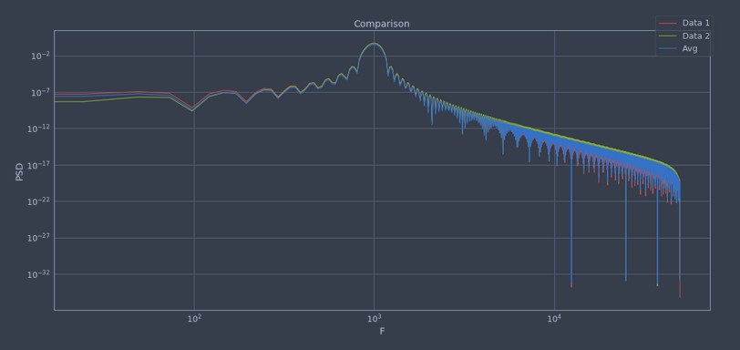

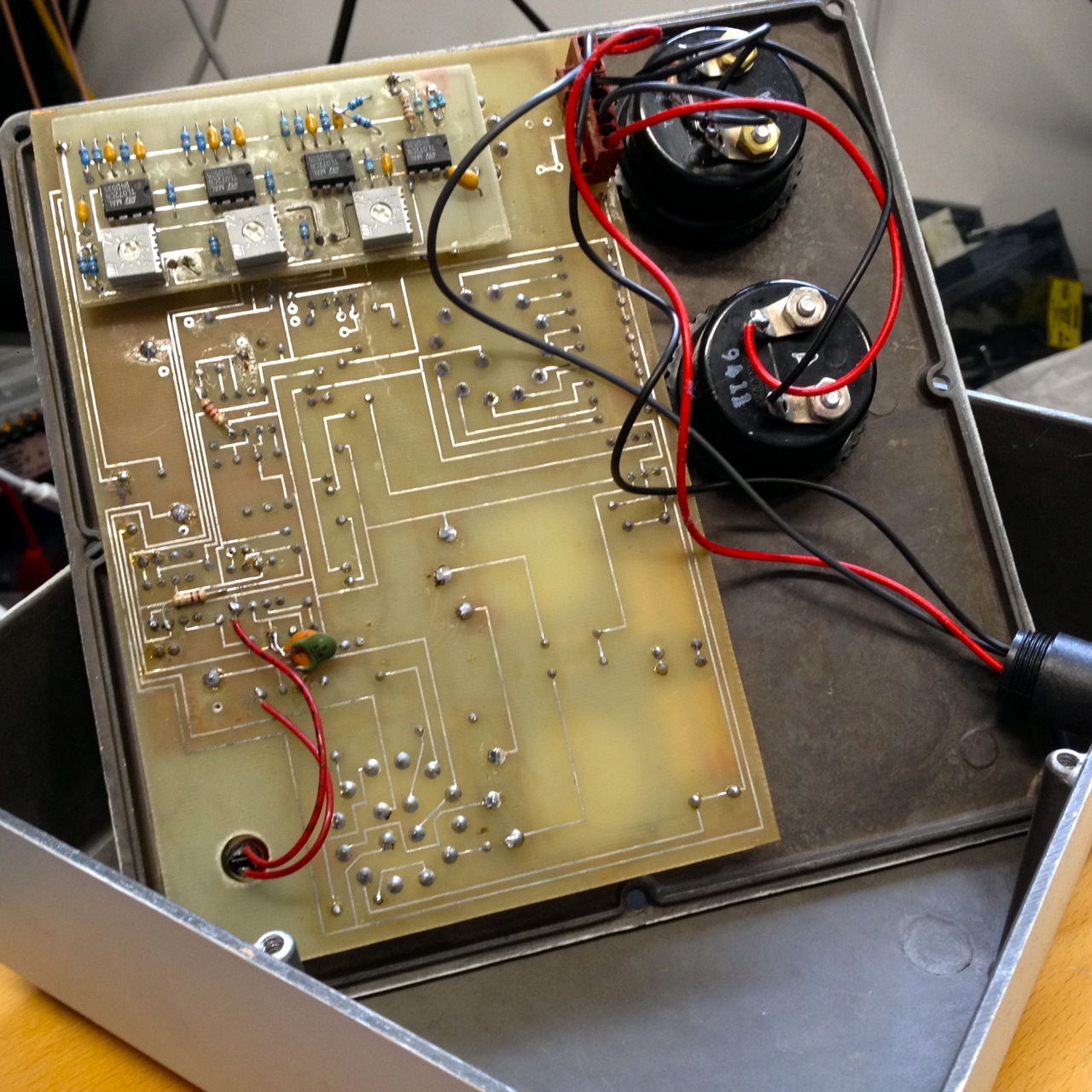

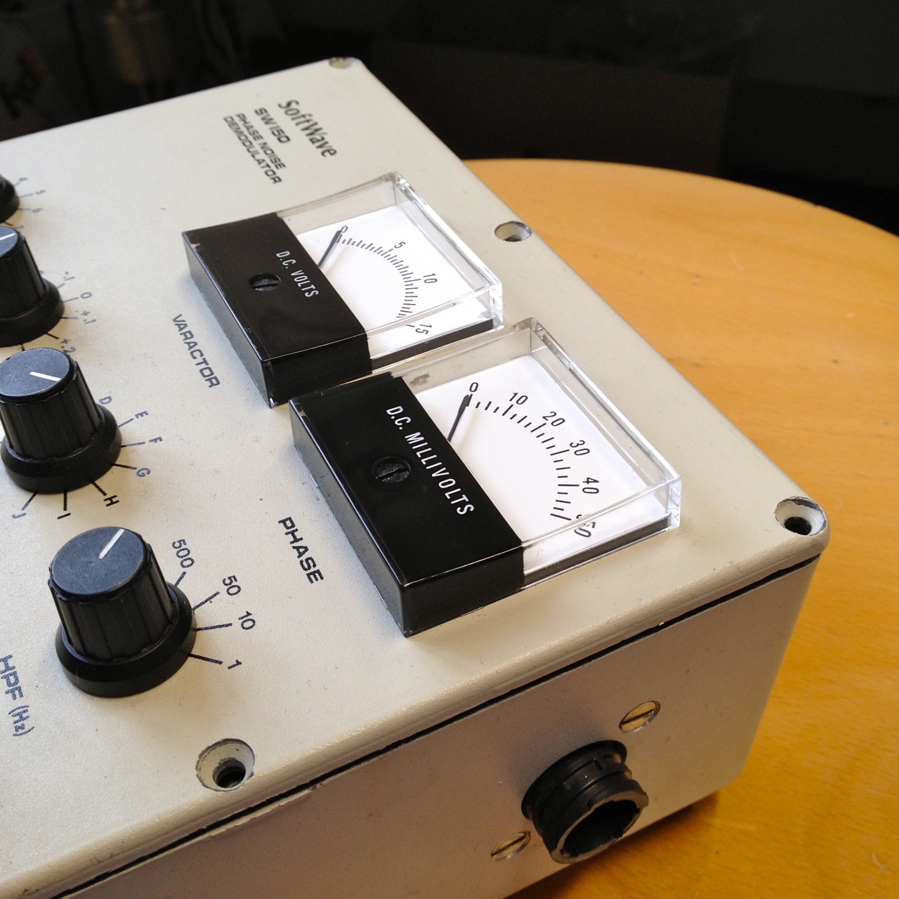

On the software side I am using Linux, a dirty hack of JAAA from LinuxAudio-Downloads for the FFT analyser. Hacked to have a log display for frequency axis and to extend analysis bandwith down to 0.01Hz.
SISCO : LV2 Plugin Documentation to visualize the signal in time domain.
A PUREDATA patch to remove DC component and Jack the sound server to connect all this together.
If any interest I can give the dirty hacked sources of jaaa.
Joël
Joël

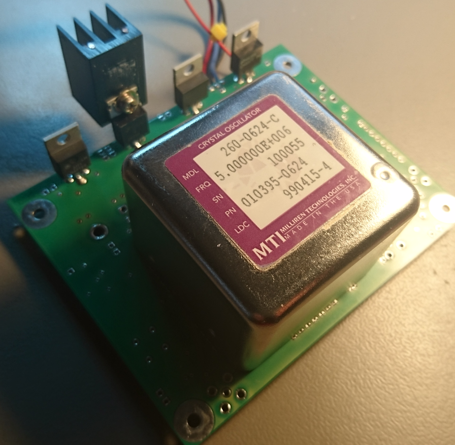

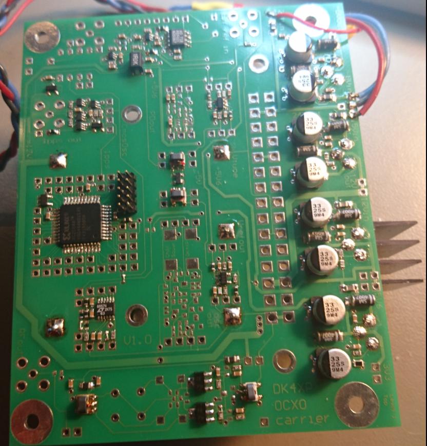

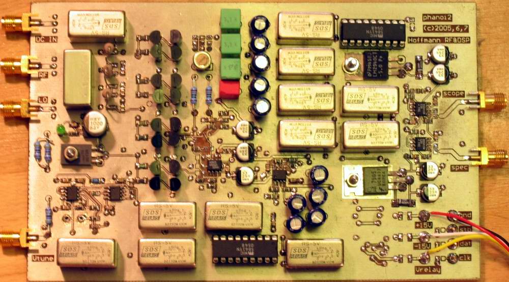

I have also done an oscillator board in the Riley style that can sloooow lock an
xtal oven to a, say, GPS reference, It can accomodate MTI 260 ,
Morion MV89A or HP 10811 oscillators.
Also a phase detector board that is not far away from Wenzel, or really HP3048.
Everything is switched with reed relays, that blows up the hardware somewhat,
it looks more difficult than it is.

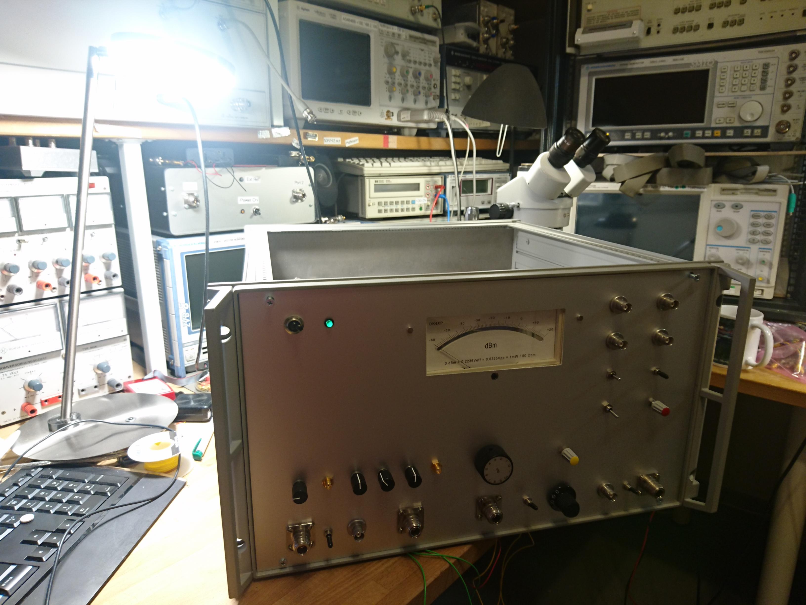

BTW. I have cleaned up the control software for the Agilent 89441A.
It is a 1.9MB zip, including the 89441A GPIB manual. The program itself
is only a few pages of C. Email me if interested.

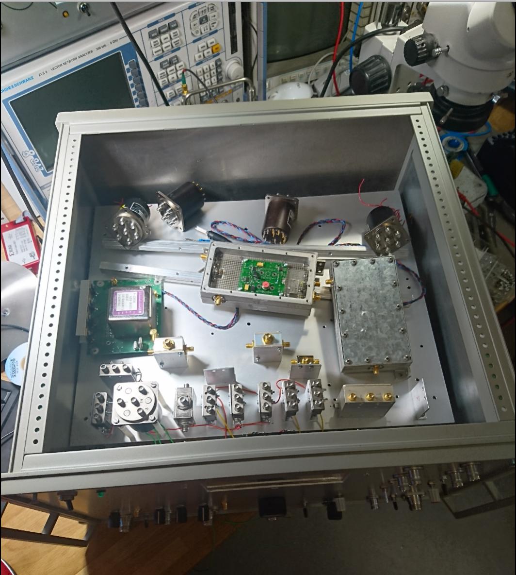

Having seen the creation date of the phase detector board above, I have
concluded that it's about time to complete my own phase noise tester.
Last weekend I have done most of the mechanical construction. It is quite
large because of the amount of Aircell coax cable needed & the relays
for the switchable delay line. It will be 2 channel so I can use the 89441A
for cross correlation.
The amplifier after the ring mixer is based on an earlier design of mine
using an IF3602 JFET. Ring mixers are SRA-3H since I had them.
The open box in the open box is one of the ring mixer/preamp assemblies.

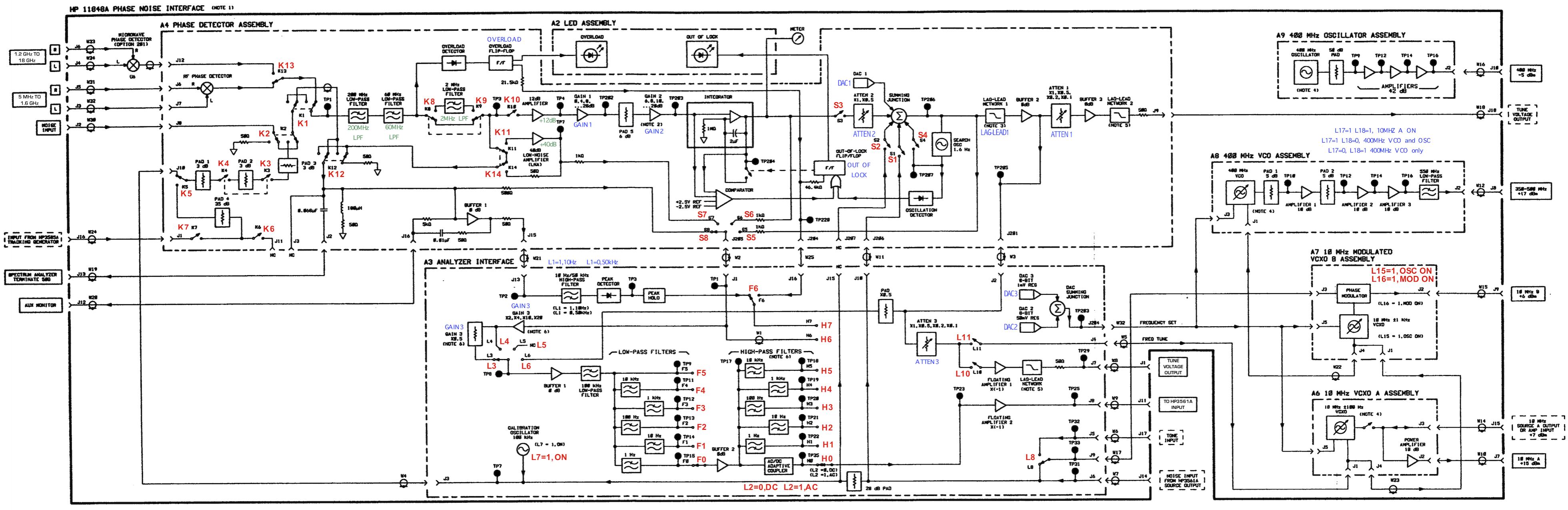

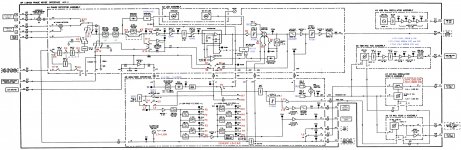

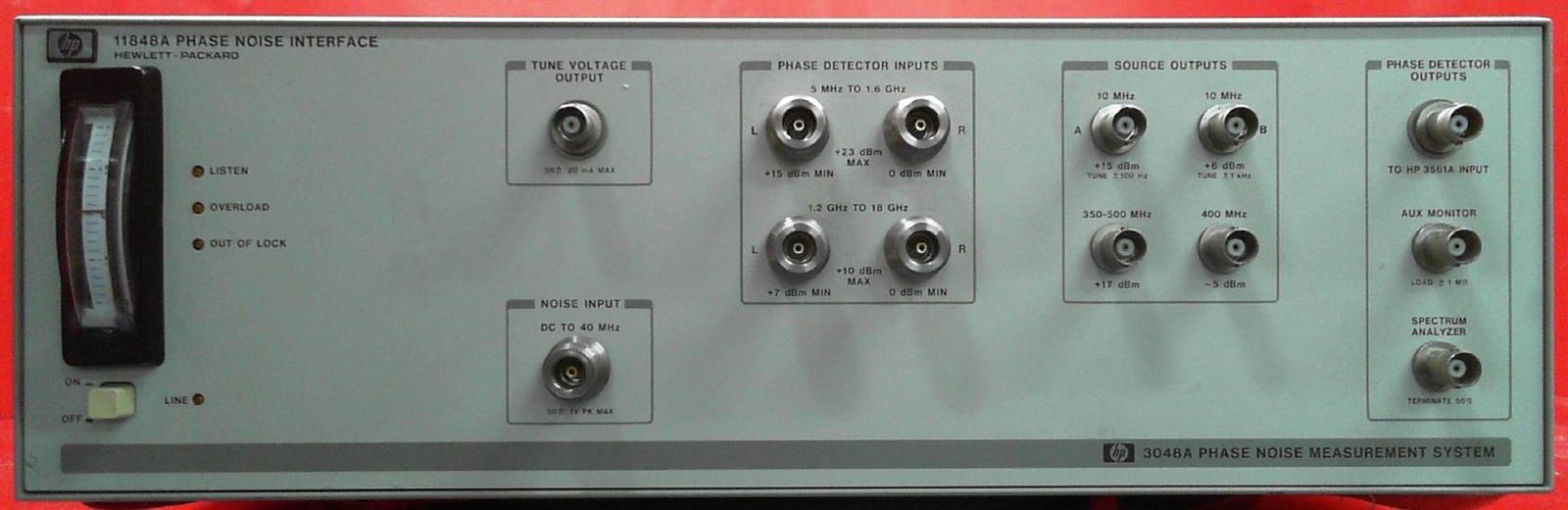

Has anybody used HP11848A phase noise interface in anger?
It is a bit clunky to control over GPIB but reasonably useable.
It is, basically, a mixer, LNA, PLL loop, set of of LPF and HPF filters, DACs and tonnes of relays that allows you to send measurement or test signals through almost any branch.
I like it so much I have two.
I have used it with HP3651A and custom 24bit 500ksps sampler.
Leo
Leo

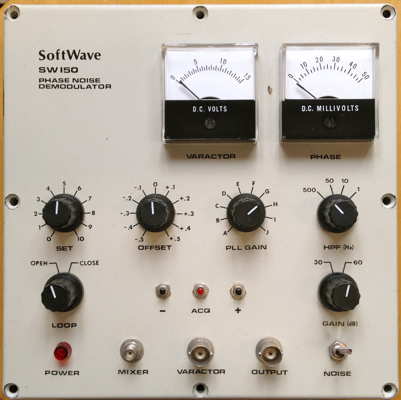

Does anybody know where this mystery phase noise interface could have been made? It is a test set that take input from the mixer and has VCO driving voltage and sampler outputs.
I like it because it is fully analogue and very tactile.
Leo
Leo
