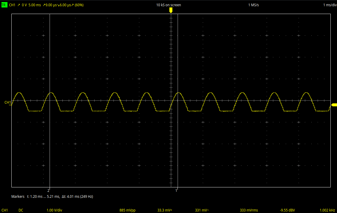

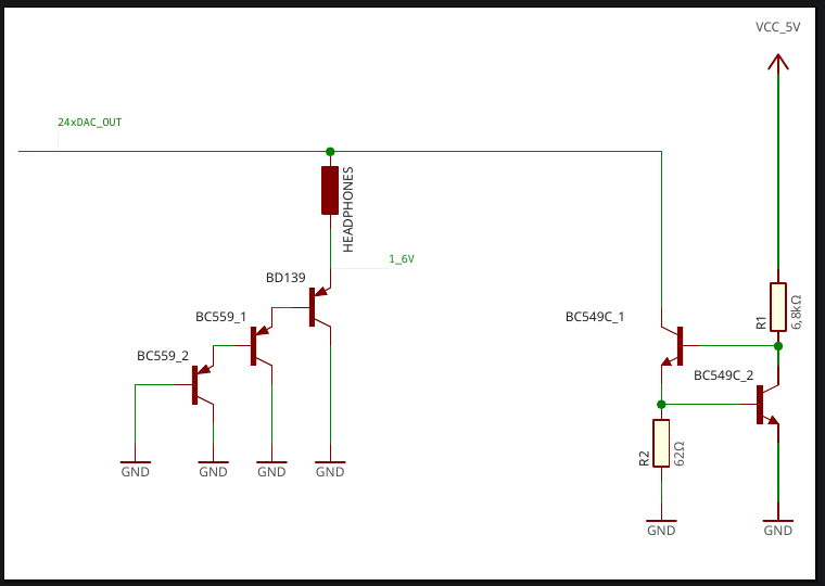

That's encouraging. I tried to ground lift using PNPs, using what I had at hand and avoid using an opamp which was noisy on a previous trial. Connected the negative of the headphones to the ground lift (BD139's emitter), which effectively measured 1.6V from GND. The positive of the HPs to a CCS sinking roughly half current (11mA). I probably did something wrong, the scope shows now only half wave.
One problem with your 'ground lift' circuit is it can't source any current, it can only sink it. Therefore positive half cycles are fine, but on the negative half cycles there's nothing to support the 1.6V reference and it'll collapse. Perhaps this explains the truncation of those negative half cycles in the scope pic. You could fix the BD139's inability to source current with (yet another) current source from VCC to its emitter.
Do you mean something like this? If this goes in the right direction, I don't know if the CCS biasing resistor R4 should be grounded to BD139's emitter, or to GND as drawn in the diagram.
I'll be happy to listen and measure this I-out DC free, hoping to get a working circuit. 🙂 But I suspect now that the aggressiveness I hear might come from digital signal integrity. It is quite noticeable as artifacts when digital volume is low, even with an I/V resistor and passive RLC filter... Might be the lack of an USB isolator or buffered I2S streams... trying to find it out.
Yes, that's what I had in mind for the CCS.

The 'DC sink' circuit works fine on breadboard. With the values on the previous diagram DC went down to 200mV. Lowering CCS resistors to 47ohm it went down to 27mV, which seemed to be optimal because further down it would start increasing again. Also shrinking the CCS saturation helps: increasing the 'CCS bias resistor' from 6.8k to 13k brought finally DC down to -3mV, even though sometimes it comes back to 30mV or so.
The case is there is almost no more constant high DC 🙂 I suppose this will increase dynamics on the HP membranes and time will show me the actual benefits of it.

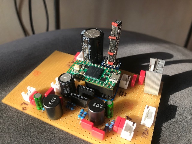

I also got quite rid of the annoying noise. Yes... it was 'ringing'. A 100n at supply helped. Then had to solder another 4 along the tower, a 5th didn't make any audible difference for me. I know this makes in total 500n, probably I should get some smaller 10n ceramics and solder 10x along, as @Zoran suggested. Thanks for that advice!

Any suggestions to my primitive 'ground lift' @abraxalito ? I'm not sure if I should use diodes instead at the BD136's base.

As regards your ground lifting circuit I can only suggest maybe use an IR LED as a voltage reference (fed from a resistor or CCS with ~5mA) and delete the two BC559s. The anode terminal of the IR LED goes to BD139's base and its cathode goes to GND. The IR LEDs I use are very low noise and have a forward voltage ~1.2V. I think they're 940nm.

Thanks for the suggestion, I'll dig into the IR LED alternative. I suppose that the amount of current injected into the BD136's emitter, aka. ground lift, should be doubled when having the two channels of the HP mounted on it? Also, R3 should be somewhere around 30-22ohm?

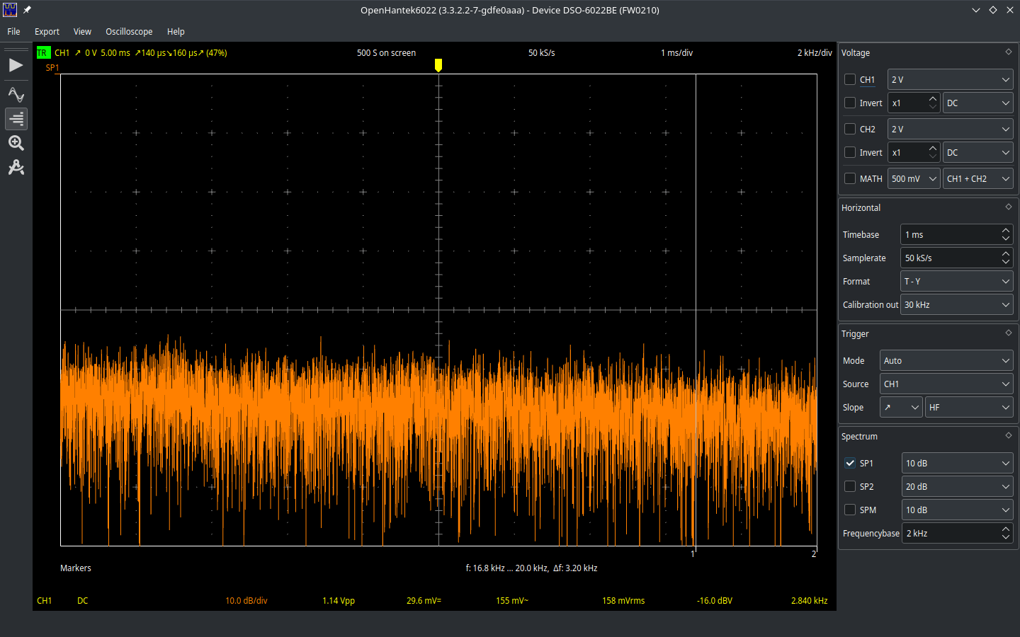

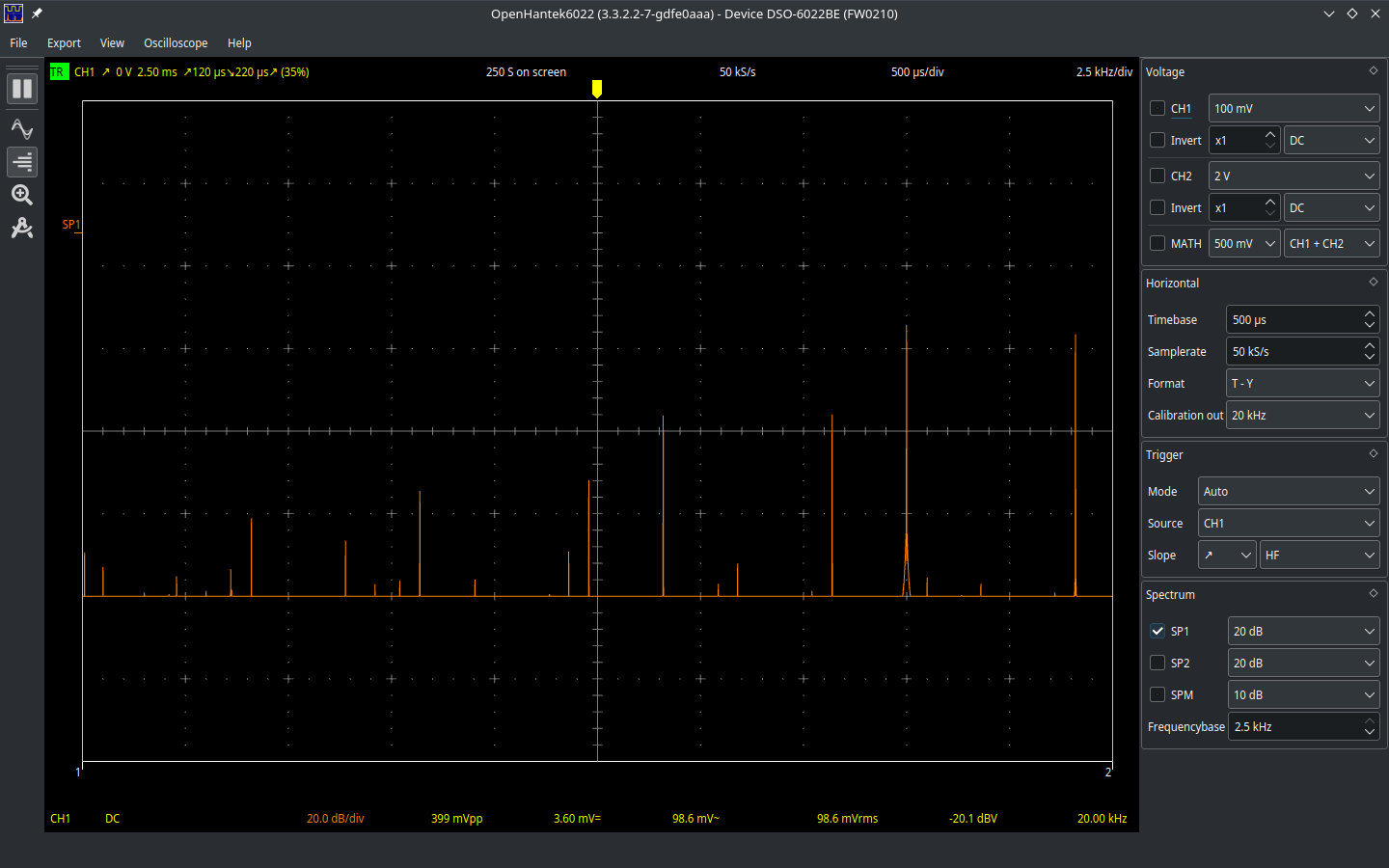

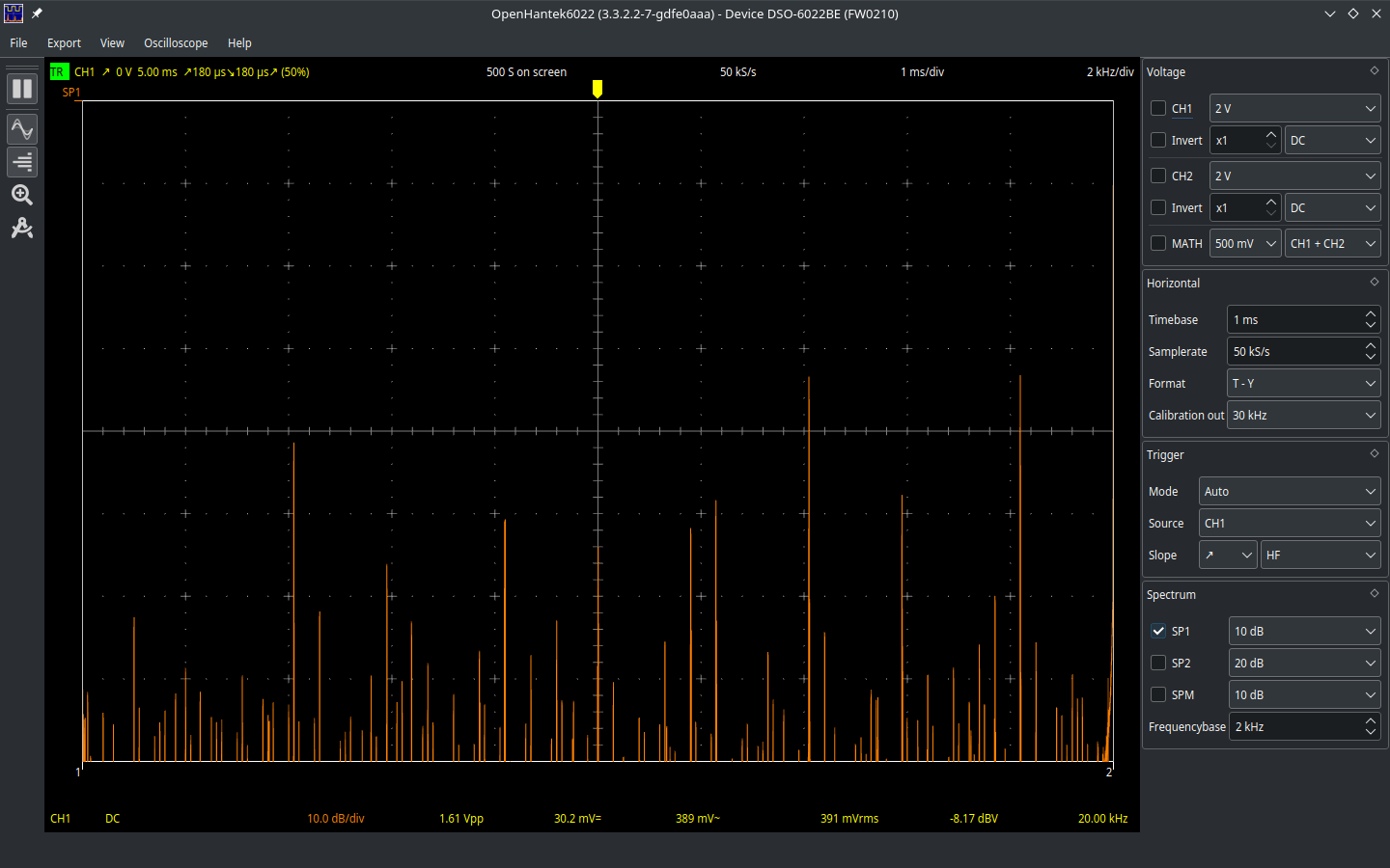

The canyon I was having (-11dB @ 15kHz) was mostly due to the CIC digital filter I was using. Unfortunately I don't have proper knowledge to modify it and, without any filters, the 24x I-out design appears very flat to me but a bit of an harmonics festival within the audible range.
White noise on unfiltered NOS 24x (10dB/div)
20kHz on unfiltered NOS 24x / with 80% attenuation (20dB/div)
The way things are, one can clearly hear a 20kHz sine wave–which is probably impossible for me. On the scope it can be seen that loud harmonics (-20dB quieter the 20kHz signal) form at 18kHz and 14kHz. Also, a -40dB peak is visible at 8.2kHz and milder ones down to 4kHz and 2kHz. Probably it's those peaks, rather than the effect of ultrasonic images, what I'm listening to. Or maybe both, as one might be the cause of the other. I also don't know if this is technically called THD or IMD.
When listening to music instead of a sine-wave this effect seems to render into an immersive experience, or a sense of space–maybe similar to a reverb? I'd dare now to say. Infinite harmonics interact with each other, I assume, quite the way our perception works in real life. The drawback however being the loss of sharpness or punch quite needed sometimes, particularly to feel the contour of synthesis or filters. It was maybe my misconception so far that an I-out design would be more transparent in this sense. Unless I'm doing something wrong, I'm left to the idea at the moment that a filter is quite inescapable to mild down 'images' at least a little bit.

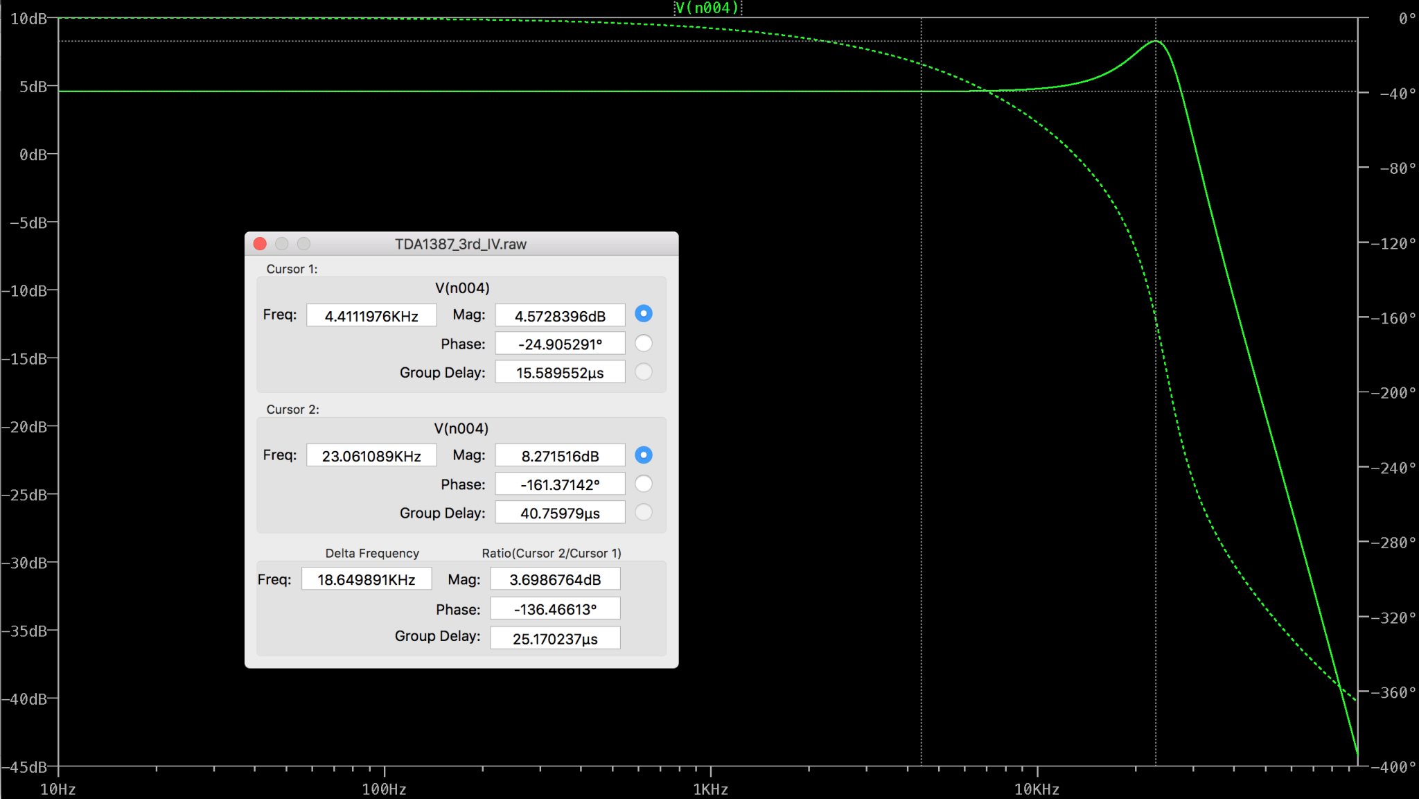

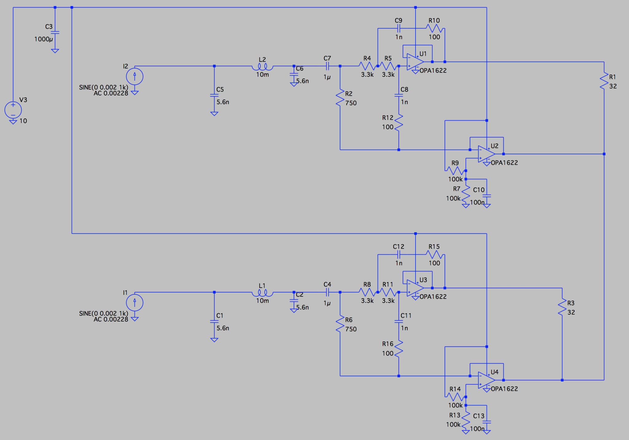

A year and a half later, this thread was my best induction into audio electronics–by a remarkable teacher. Sticking to the original need, a monitoring output stage for a DIY portable field recorder I've been working on, I'm currently prototyping the following circuit.

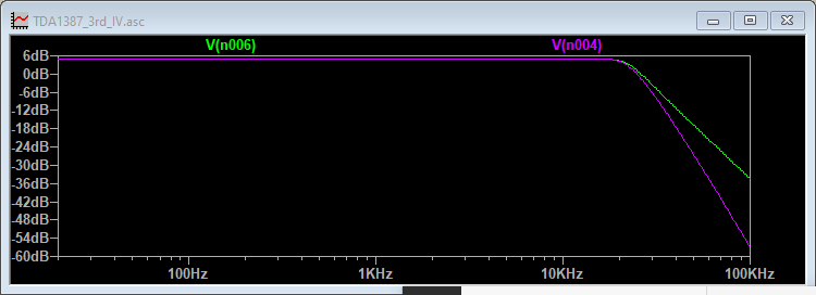

I'm not fully sure, but I think this should work nicely. The source is 4x TDA1387. Two OPA1622 as HP drivers and stiff VGND, so the output is capacitor-less. The combination of LC filter and sallen-key should form a 3rd order filter. I intend to oversample the DAC by 4x, so the first image should appear at 96kHz (-50dB according to the simulation).
A few things I don't fully understand:
1. The coupling capacitor after the inductor (1uF) together with the IV resistor (750) should form an RC filter with fc 212Hz. Obviously I don't want such HPF, I kept that capacitor's value low to use a film cap, but I'm puzzled on why the simulation doesn't show the expected HPF. Is it because there is not yet any voltage?
2. I added 100R in series to the OPA's feedback loop, to avoid interference (cellphones) coming in through the headphones. I followed this thread on that. Is this allright?
The IV filter has a peak of +3.5dB at 23kHz, to compensate NOS droop.
A 1000uF capacitor at the power supply decouples the whole circuit. Ripple is of great concern to me, particularly to avoid the circuit affecting neighboring preamps. I've noticed in prototypes that when headphones are loud, neighboring preamps feedback internally. Having the headphones grounded on an OPA VGND seems to help minimizing ripple, since the phase of its current draw is opposite to the OPA drivers'.
Overall, just welcoming any comments or observations regarding the design, before it goes to print.

Welcome back!
On question 1) its because the DAC is current output. The input voltage (to the HP filter) therefore rises in perfect compensation for the LF roll-off so you get a flat result in sim at the output. But in the real-world it won't work as the DAC needs its output voltage defined by the external circuit - without that its output saturates at one end or the other of its compliance range.
The opamps are supposed to be Sallen-Key LPFs? If so the cap values don't look right and the 100R resistors in series I'm not sure of their function. I haven't checked out your link yet though.

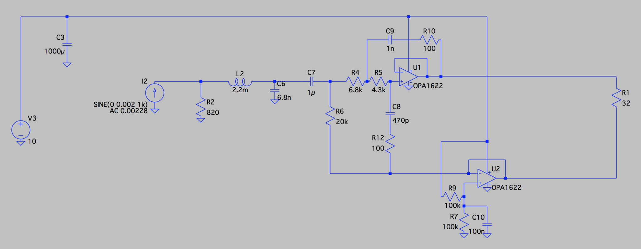

The opamps are supposed to be Sallen-Key LPFs, I guess you are rightly questioning the damping factor not being butterworth? Here goes another attempt.
I placed the IV resistor at the DAC's output, or it would have never work in real life–if I follow you well.
No need for NOS droop compensation maybe, because the DAC will be 4X oversampled?
RLC filter (fc 44.1kHz) + Sallen-key (fc 44.1kHz), should make a 4th order LPF. Sim shows -26dB at Nyquist (88.2kHz).
Would this be any good?

So 1387's sound is definitely preferable to AKM? The AKM is almost certain to have lower noise and so, likely more 'air'.

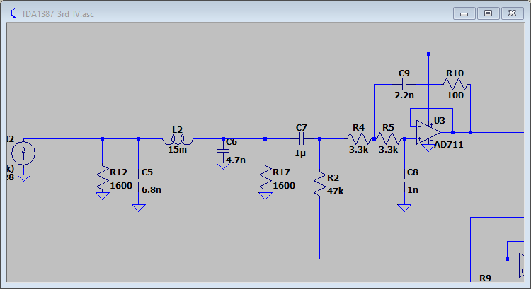

Here's my re-working of your schematic (had to change opamp, no OPA1622 in mine) :
To help flatten the LF roll-off, I increased R2 to 47k. C9 increased to get a sharper knee from the Sallen-Key LPF. I went for two I/V resistors rather than one to reduce current through L2 which has increased its value. C8 doesn't need to go to the mid-rail, so its grounded now. Here's the frequency response - green is from LC filter, magenta the opamp's output.
I agree, no need for droop compensation when you're running at 4XOS. Incidentally the first image when at 4X is at (44.1*4 - 20) = 156kHz
This is amazing, your generous intervention saves me multiple times of research and experiments. The filter now shows -58dB at 156.4KHz and any fold-back image would be even further attenuated and inaudible 🙂

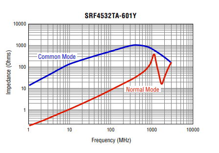

What puzzles me about the thread you linked is - why no attempt to prevent the RF entering the circuit through placing an inductor (or inductors, to extend the frequency range of what's being rejected) in series with the HP outputs? Why only focus on preventing RF getting to the opamp input terminals? Putting filtering there is going to fiddle with the stability of the feedback loop whereas an inductor on the output won't have that effect. You could also use a CM inductor as RF pickup on the HP leads is quite likely to be common-mode in nature.
