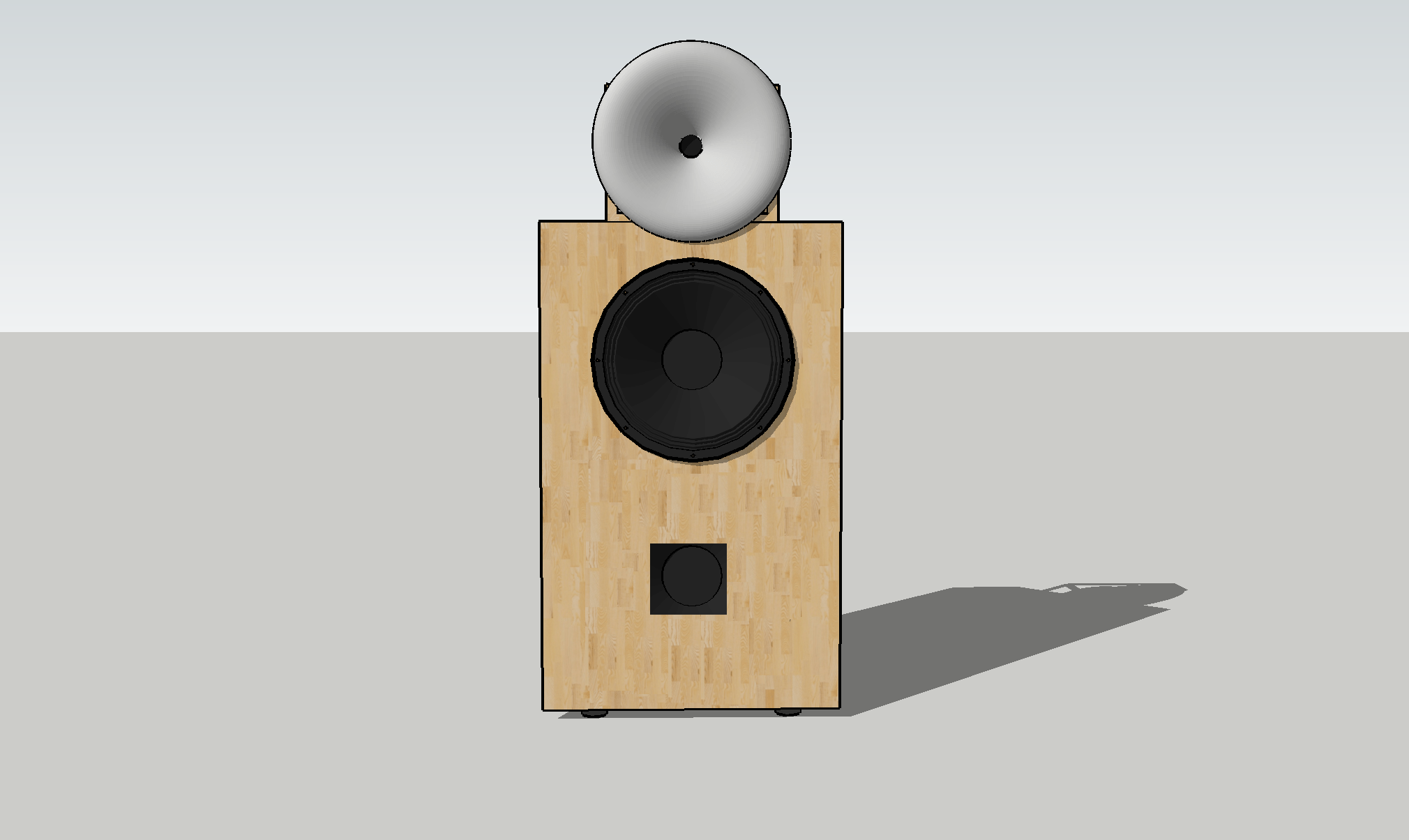

Here's what I'm thinking – I'm curious if you think I'm steering the ship in the right direction!
Specs
Cabinet: relatively unchanged. ~6 cu. ft. Add some bracing, cut a new baffle, etc.
Woofer: Faital Pro 15PR400 – seems widely loved and appears to do well in my form factor
Compression driver & horn*: Faital HF146R + Faital LTH142
Crossover: MiniDSP
Cost
This plan hinges on the assumption that I can (eventually) track down these parts for these prices.
This speaker, the "La Modesta", although a bit larger, seems to be close to what I'm thinking:
Are there obvious cost savings I'm not seeing? My guess is a decent xo would cost me about the same as the MiniDSP. Good CD's all seem to be expensive.

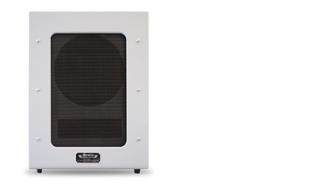

Heretic AD614 (smaller Box- smaller Price)
spec 1.7 kHZ crossover
Components
https://www.mcleans.info/products/heretic-ad612?_pos=1&_sid=ce787f6c3&_ss=r
Heretic AD612 (larger Box- larger Price)
Components
"External dims are 36x24x15 Gross internal volume 6.21 ft³ / net (without driver displacement) ~6 ft³"

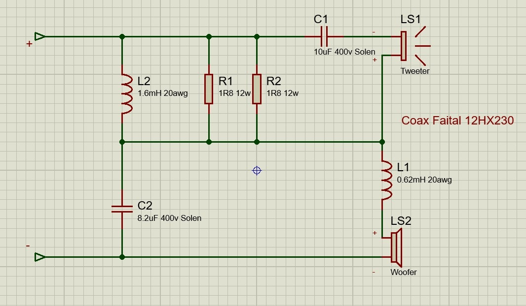

Faital Pro 12HX230
https://faitalpro.com/en/products/Coaxial_Loudspeakers/product_details/index.php?id=351050010
Heretic Loudspeaker A612 Clone
https://www.diyaudio.com/community/threads/heretic-loudspeaker-a612-clone.399873/page-6
(crossover -post's #27, 63, 66, 71, 88, 89)
post's #101 &102
modeled-different coils 1.5 mH & .5 mh (vs 1.62 & .62)
Looks like the same crossover & drivers.
