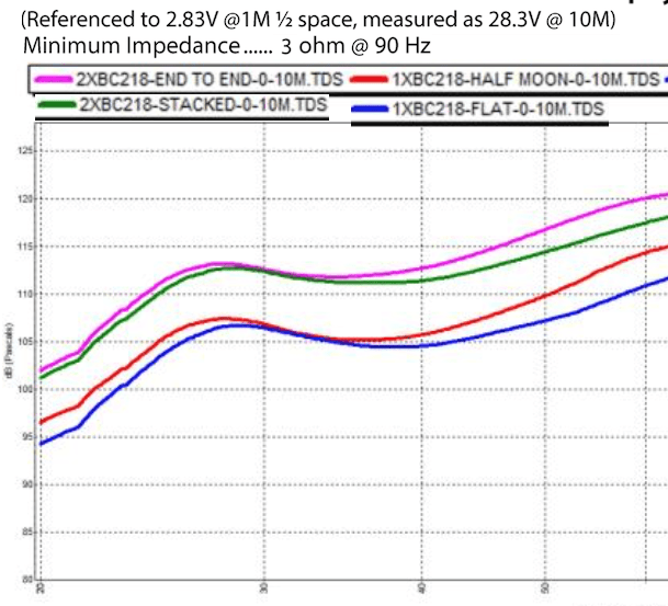

Here is an example of one Danely Sound Labs BC218 front loaded horn cabinet compared to two cabinets, each driven with the same voltage:
Obvious +6dB low frequency gain, plus a little more in the configuration that increases its frontal boundary.
Anyway, Stoneeh, myself, thousands of others have measured the same, and most simulations agree with the measurements.

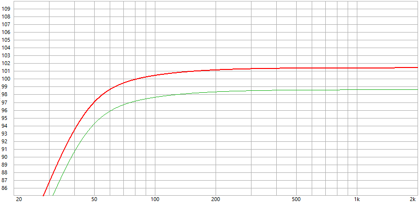

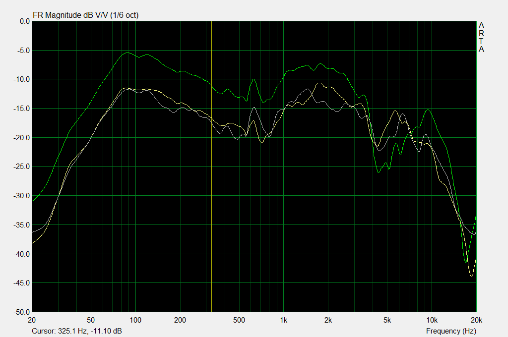

And just so nobody can claim the former measurement is horn stacking gain, here's a measurement of bassreflex speakers, showing the same thing. Infinity SM125, measured in GPM. Yellow and gray one box each, green both running in parallel.
+3 dB total amp power for +6 dB gain; meaning +3 dB comes from the doubling of membrane area. Note that at some point in the HF, the gain is lost, because at those frequencies the wave length gets so small that a mic being even slightly off center causes phasing / cancellation. So the prerequisite for the +3 dB gain is perfect addition of waves between boxes - which will always be a given though with subwoofers in stacks at low frequencies (very large wavelengths).
Any good simulation indeed shows the same. Even such a basic one as WinISD. Here's identical BR boxes, running at total 1w (2,83V for the single box, 2V for the two boxes in parallel). Green shows single, red shows both. Yet again, a 3 dB gain:

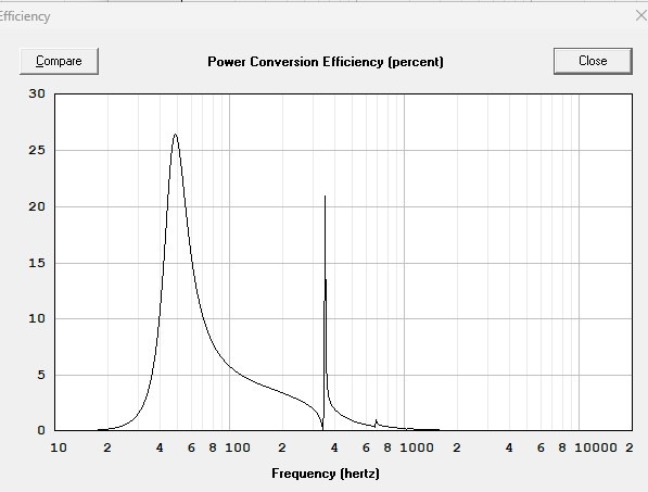

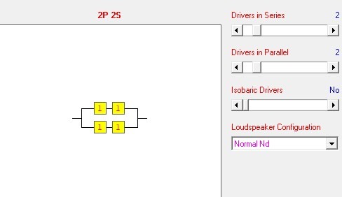

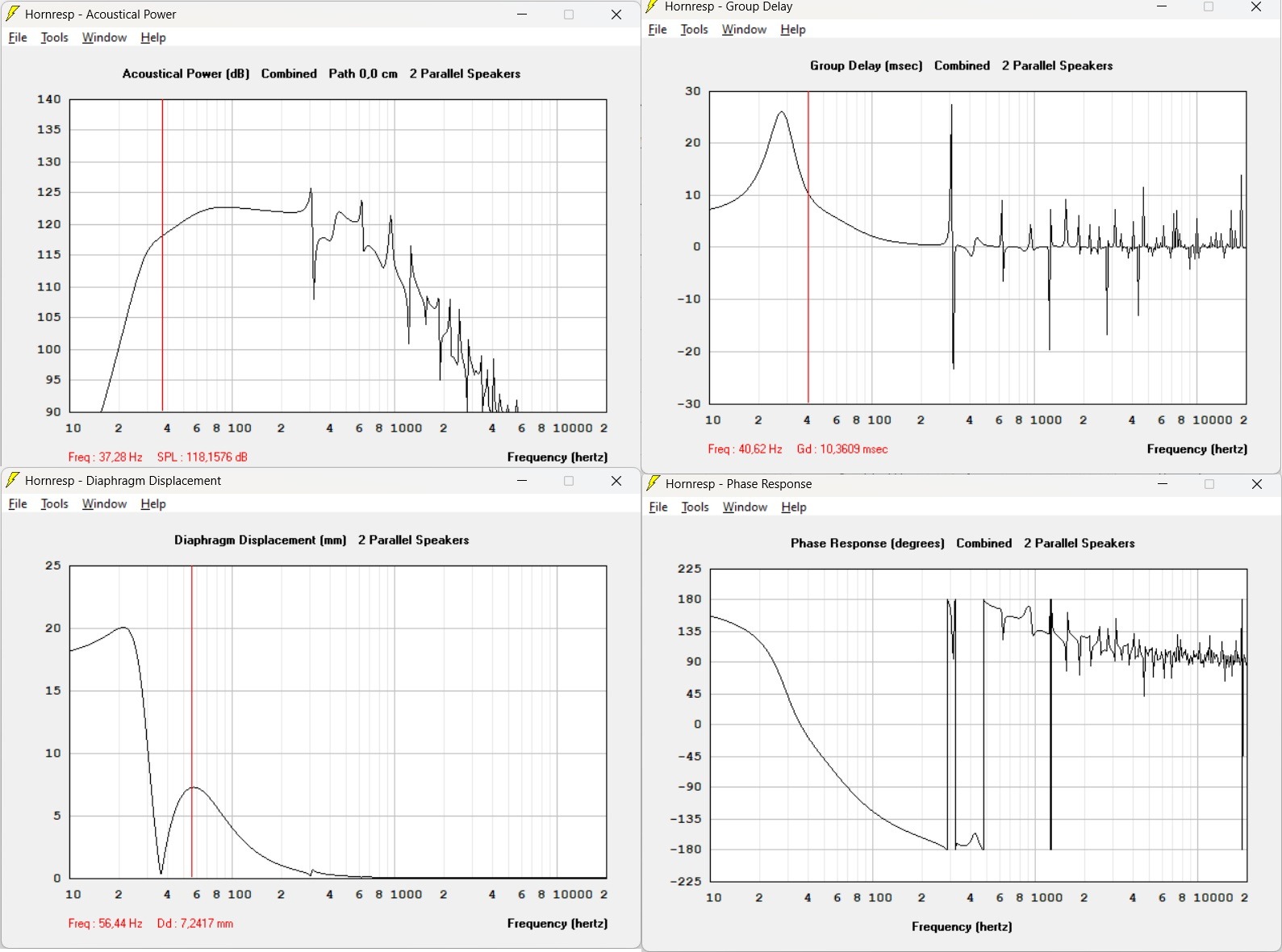

Efficiency does go up too, not just sensitivity.
Here's one 8 ohm driver, 2.83V, so 1 watt.
Here's 4 of the same driver in a 2P 2S config, for the same nominal 8 ohm impedance, so again 2.83V and 1watt.
And as expected (without showing the graphs), the 4 drivers vs one, show close to +6dB sensitivity gain for the same 1 watt of power.
