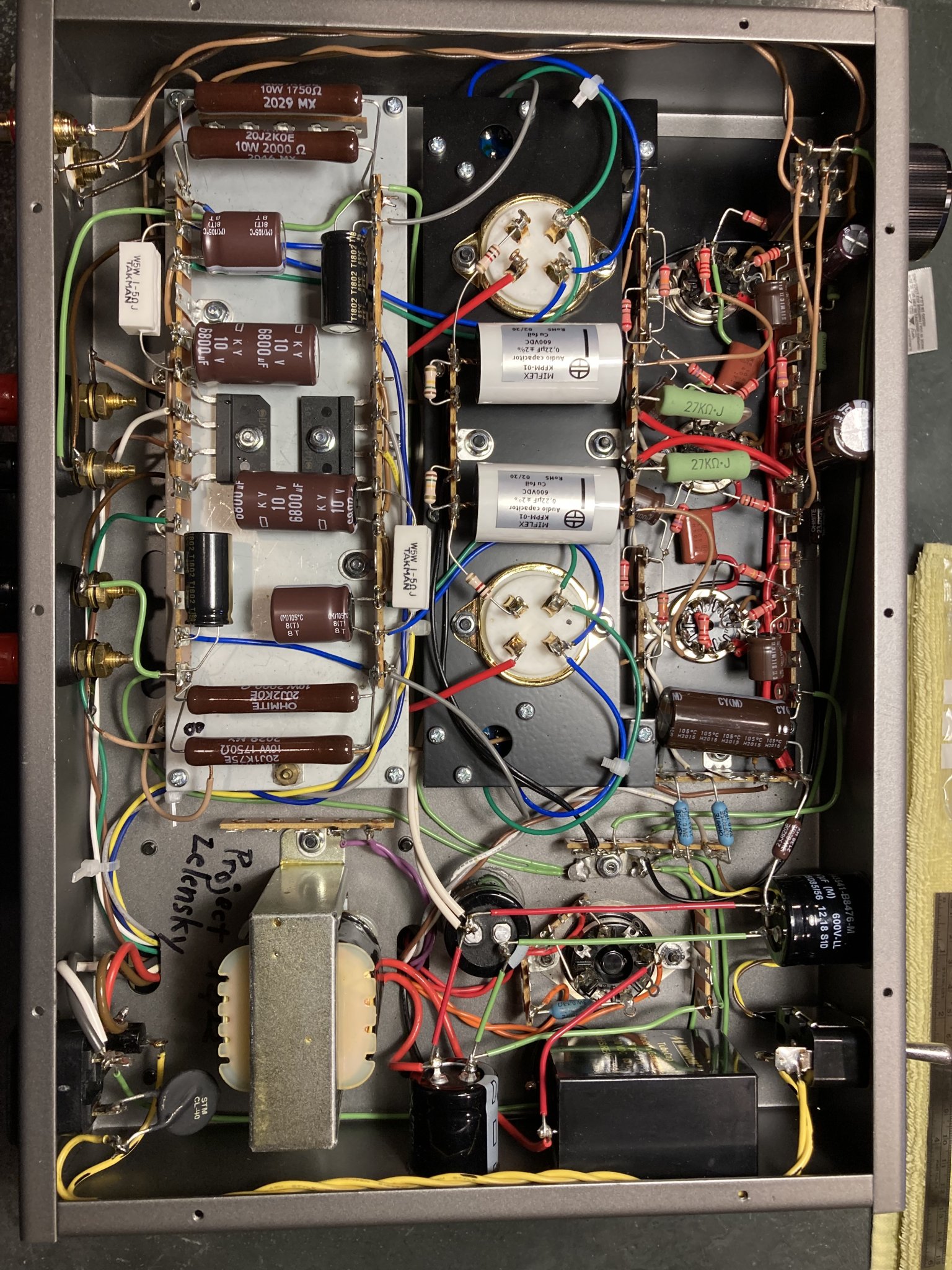

I want to start a thread about this kit build process because after some tinkering and adjusting this amplifier sounds much better than stock, in my opinion, and will be far more reliable. So first thing I want to say is that I built this kit exactly to the guide/schematic and then started to make changes. First thing I noticed was how hot the output tubes were running. The schematic suggests running a 300b with 482 volts at the plate with 73ma plate current. In my opinion this will fry any standard 300b pretty quickly. So the first mod I performed was to bring the plate voltage down to 400. Mine was actually running at 495 and 75ma. So to get the voltage down you will need to use the purple b+ tap, not the red, and use a 5u4gb rectifier tube. This will get you to 400v and 60ma which is a more typical operating point for 300b. This is just one of the mods I have done and there are several more to discuss but I’m interested to hear about others experience with this kit before I move on to the other changes. I have attached photos of what my build looks like at this point. So please chime in if you have this kit. Cheers Thomas

Hi Victor
I do understand that the amp is self bias. I am calculating plate current using the voltage drop across the cathode resistor which is 1200 ohms with a voltage drop of 90. Since 300b is a triode the plate current and cathode current are the same, I believe. So my calculations say 75ma and about 30.4 watts total dissipation. That is under the limit of 36-40 watts max and 100ma max. But that is still quite high in my opinion for standard 300b operating at nearly 500 volts on the plate. I’m just stating here that I prefer to run my 300b at lower plate voltage/current. I think they sound much better at 350-400 volts and in the 55-60ma range. The amp will run cooler and the tubes will last a lot longer.

So I want to be clear that all the changes I’ve made here are easily reverse able and are just resistor value changes in a few places and a change to the purple b+ wires.
If anyone here looking at this thread wants to tinker/experiment with a different sound from this amp and would like to chat about the various ways to go about it then speak up. Otherwise I will just let it be. Cheers Thomas

So recently I have been thinking about this thread even though it seemed like no one was interested in it. I was planning to post a photo of the innards as it is now. I have made some more changes to the circuit since my last post. When I get home I will upload a new picture.
Can I ask you a question first?
Are you using a 12at7 as the input tube?
Changes to the bias of this input tube make a big difference in the sound. I am not using a 12at7 anymore. I’m wondering if you’ve tried a 5751 or a 12ax7? I’m presently using a 12av7/5965 with higher plate current flowing.

Yes, I'm using the single 12AT7 (NOS Mullard). I haven't tried any other tube in that position and really like it. Even though my voltages have dropped, I like the sound quality better than the stock kit.
I'm still wondering if my dropping resistor approach (going from 5.6K to 6.5K) would keep things pretty much "as is" regarding the heater and filament supply wires. The B+ is lowered, and the heater current and filament wire voltages stay the same as Sunvalley designed. If I increase the dropping resistor, the cathode bias net will go from around 380 volts on the 300B tubes to a bit lower than my current 380 volts. That might be good enough. I also have a Dennis Had 300B amp, and that is set for the WE300B tubes that I also use in this amp and supposedly does 360 volts, but I haven't measured it. I like the Sunvalley Amp sound quality better(particularly using the upgraded parts that I have), but I want to get as close to the Had amp as I can in voltages to find out if it makes sense to stay around 360 volts. 380 volts isn't much higher, and I'm now trying to lower that if it sounds better. He uses an RCA 5U4GB rectifier, and I like that sound quality better than the stock kit sound quality. It's good but not good enough for me.
My dropping resistor change only affects the B+ voltage and doesn't change the heater or filament wire voltages. By using your 320-volt purple wires, I might have to increase the 12AT7 to something with a higher gain since that approach will also affect the heater wires. Currently, I don't, so I am wondering what might be best - the way I'm using the dropping resistor change or yours using 320V instead of the 380V that is recommended. The 320V wires are for using a pentode tube instead of the 300B, and I like the 300B and am going in that direction. Your 320V wires create a different heater voltage, which might be why you need to use a different tube than the 12AT7 and then change a few resistors.
I'm attaching my voltage readings using the 5U4GB and the 7.5K dropping resistor to this message.
I have ordered a Mills resistor for the dropping resistor that is 9.1 K instead of my current dropping resistor, which is 7.5 K. If that is too much, I can always purchase a dropping resistor in between. I don't think that the voltages on the 9-pin tubes would support using anything higher than 9.1 K. I'm going to try that value, hear the result, and then make my decision.
I am concerned about the 5U4GB not having a slow start, and I have purchased the slow start PCB from DIY Hi-Fi. If I decide that's how I'll go (permanent use of 5U4GB rectifier), I'll purchase the remaining parts, build the PCB, and install it. So far, this amp sounds good and hopefully I can increase the sound quality a bit more. Time will tell.
Using the 5U4GB and a dropping resistor of 7.5K creates a B+ net on my 300B tube to 380 volts. That sounds much better than the GZ34 and the 5.6K resistor used in the kit. That voltage net is around
That sound quality is much too hard and not delicate enough. I'm using a Bricasti M12 DAC and have really refined my source. The speakers I'm using are extremely transparent (Voxativ A2.6 in Hagen cabinets bi-amped) and I'm listening for the best I can create using this upgraded kit. I'm also using a really large 12W Mills for that power supply dropping resistor position instead of something smaller, and it's probably overkill. I could easily use something smaller, but why not? It can't hurt and maybe affects sound quality.
