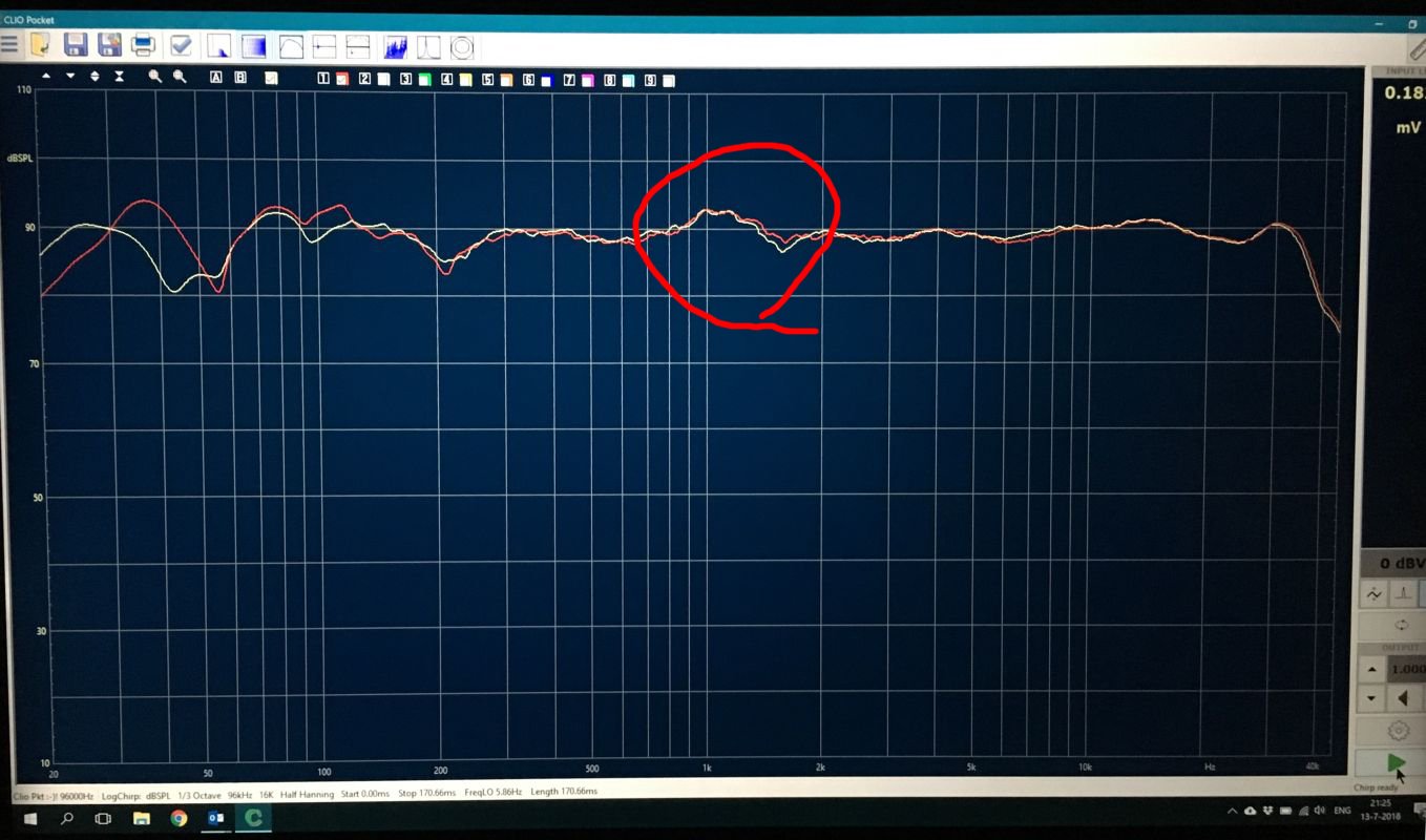

The frequency response below is left and right in the room measured at 1 meter distance on tweeter height. The little bump at 1,1 kHz has always been present in both the large and 2 way speaker. It sonically never bothered as measured in the listening position it is gone. Something to do with the d'Appolito arrangement. The frequency has a wavelength of exactly the the distance of the two midrange units.
The dip at 230 Hz is the error of the mic being at tweeter position and is gone when the mic is placed between LF and MF.
Below 300 Hz the frequency response alters with every different setup, distance of walls and so on, and is therefor not Representative but it says something about how low this speaker goes.
Here the second graph tells something. This is a near field measurement as shown in a picture above. The mic a few cm from the cone. The top red curve is with just the 2nd order HP filter. The green lower graph is with a notch filter added to dampen the second resonance peak and this little tweak made the LF sound so much better. more control and it was as if it reached deeper.

Is that a resonance at around 1100-1200Hz?
I've had that in my speakers, before I found it with proper measurements, and I found it to make quite a difference in the sound - to the better - when removed😊

Looks very nice but hmm not looks very musical, almost +-3db nonlinearity at critical 1k-3k . the crossover at 200Hz is also not well done, -5db.
Do you have crossover phase chart?
Yes it puzzled me, and is a bump that only was measured at 1m on axis. On the listening position you do not see the bump. And I can assure you the sets sounds fantastic.

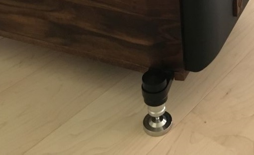

Hi clsidxxl,
I bought them on EBay, from a chinese seller called EicStore. (€950 for 24 pieces as we made 3 speaker sets, without the round base plates)
When I started my new design (see my new tread) I tried to buy them again as they are also part of my surround speakers, but they are not available anymore, and the seller can't get them.
So I designed a new feet/base construction.
Funny detail is that the new owner of these speakers likes my new feet/base construction that he asked me to change these speakers with the new base.
So I will have 8 of these feet available in a few months.
As you live in the Netherlands I could sell them if you are interested.
They will most likely end up on "Marktplaats"
