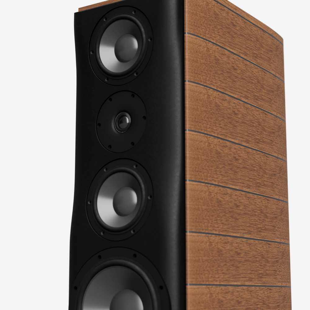

Building the best 3-way (NOT) full range speaker in the world
I do not know what a CLD construction is.
We did discuss that, but it has advantages (theoretical) and disadvantages (theoretical).
In my opinion a separate mid range unit decoupled form LF will not benefit from the sheer mass of the total enclosure.

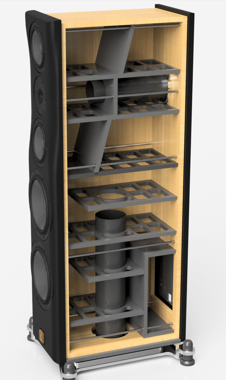

The best part of the original design (see link above) is its midrange. I think that next to great components it is the stability and mass of the total enclosure that helped making this stand out. The total speaker will also become larger. I know benefit from the space behind the midrange to be added to the LF volume.
CLD is constrained layer damping, arguably the best way to dampen panel resonances. I won't repeat what already has been written quite a few times. But take it that a small midrange unit with adequately damped separate enclosure walls is superior to integrating the midrange in the main enclosure. Main enclosure equals big panels equals much sound contribution from panel resonances. Just my 2ct.
why dont you make something like this
for the midrange and then the the "flower" cut out? Is such a big baffle for the midrange necessary? Mids would then even have more Air to breath.
Ahhhh yes I have looked into that a few times, and I have heard some nice demo's that proved it worked, but these were all fairly light constructions.
This speaker will weigh around 150kg
What you don't see in these renders is that we will use a rubber seal between aluminum and internal MDF structure (mainly to cope with stress on the rods if part of the structure expands/contracts more than others. The angled midplane that separates mid from LF will be strengthened and all panels will get lead bitumen layers and of course several forms of absorption layers like technocell.
In my experience mass will be equally or better than having a seperate fairly light structure holding mid.
And from the inside outward on the sides. Technocell, Lead bitumen, 15mm MDF, 13mm HDF, 18mm Walnut

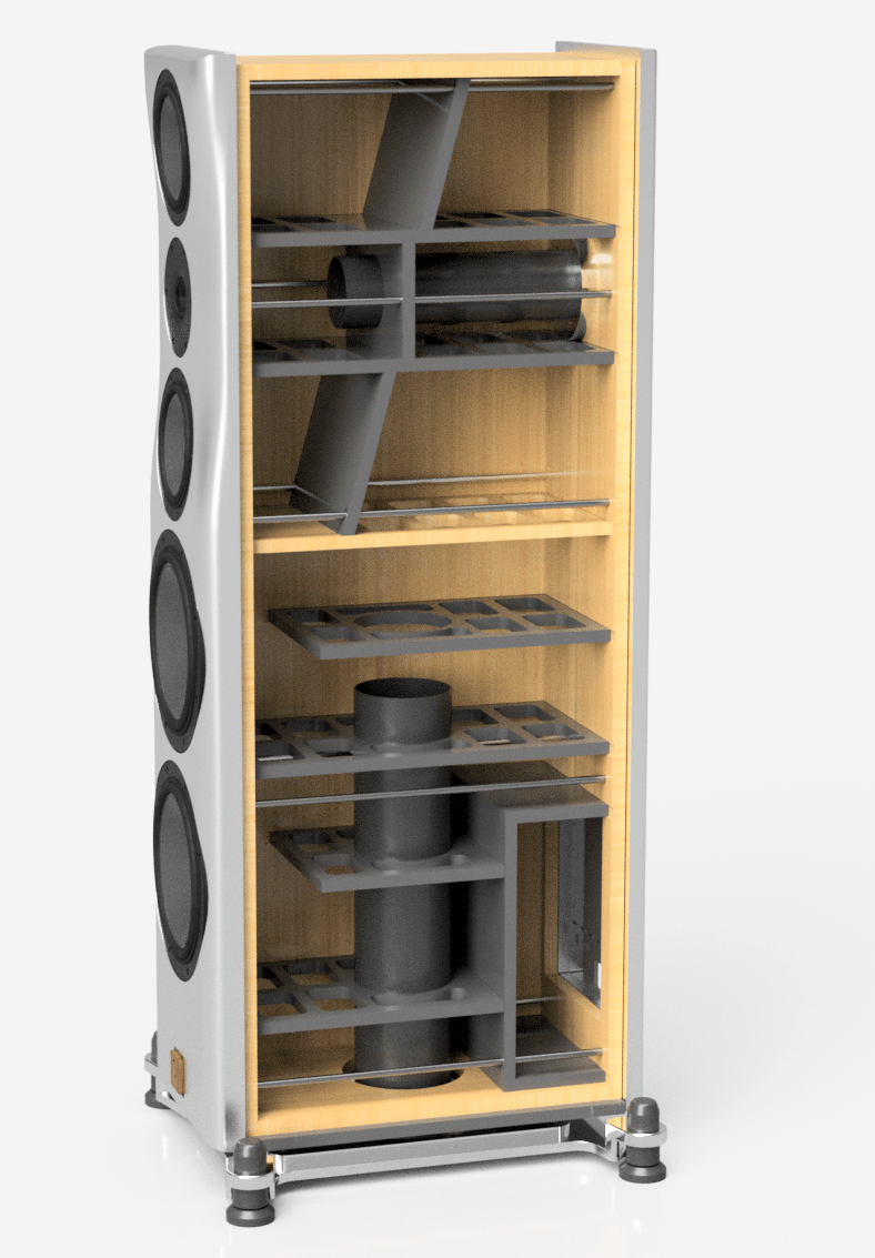

The length/diameter relationship makes this look flimsy, but with 10 pieces M8 bolts of normal length you probably wouldn't mention it. One M8 bolt can handle 2200 kg, that is 22.000 kg for 10 bolts. Sounds fine to me.
I agree the 10 rods have more than enough stiffness and strength for this application. My concern is the opposite... there is a risk of over-tightening the threaded connections and compressing the wood structure to failure. With 10 bolts, it would be very possible. Are you planning to use a torque wrench to control the level of pre-load applied to the rods? I would recommend that.
Another advantage to this design is being able to alter the preload on any given rod. This allows deal with cabinet resonances by tuning the cabinet stiffness to get the least possible resonance signature. Overall, it is a very robust and impressive cabinet design.
Reactions: PSchut
No it is absolutely fine, and if you go back to my original design (linked above) I did the same for an even larger design. The length/diameter relationship makes this look flimsy, but with 10 pieces M8 bolts of normal length you probably wouldn't mention it. One M8 bolt can handle 2200 kg, that is 22.000 kg for 10 bolts. Sounds fine to me.
The resonance remark is indeed something I am aware of, and solved in the Original design on a few places by placing a rubber piece between the housing and the rod. In 8 of the 10 places the rods pas a wall and that helps dampening it where I will have to apply a silicone type kit to close the hole.
Oh and I stole the idea from the original KEF reference introduced 8-10 years ago, not Magico. In the latest iteration of that design they removed the rods again.
Why do we need vertical bracing? I am not afraid of a resonance in these bracings,
These bracings have only one function, and that is to make sure the large side and in lesser degree front panels do not vibrate.
The front and back are extremely rigid and are joined together with the 10 steel rods.
The top and bottom also have some extra support.
So what they need to do is dampen predominantly the sidepanles that are constructed of 15mm MDF (550kg/m3) the 13mm HDF (1100kg/m3) and then 18mm solid Walnut (750kg/m3)
Also a rectangular hole leaves more horizontal wood as the connecting interfaces and are therefor stronger than round holes when you use the same surface size of the hole. And you need to make sure that the holes in the braces are open enough to make sure the speakers do not see a smaller volume because the connecting volume is limited by the holes connecting them. So my rule is to approach the volume of the cone area of the two woofers and then square holes leve more leave more connecting surfaces then round do.

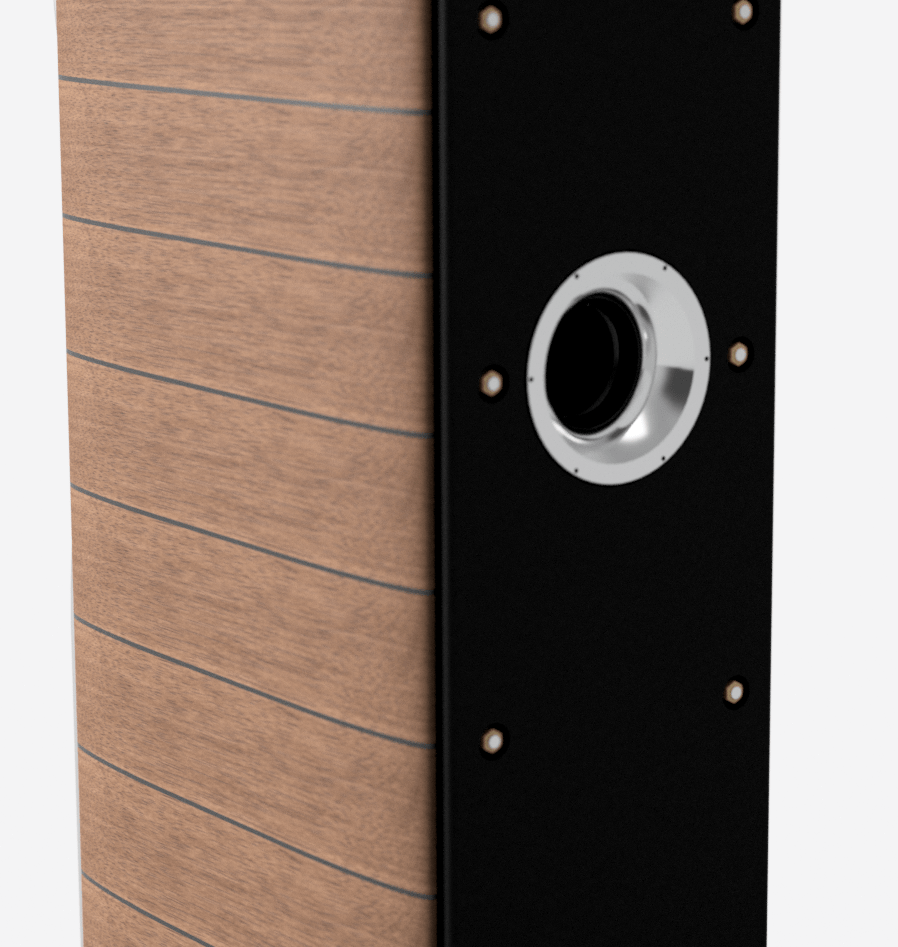

The internal angled panel for mid has been replaced by 3 panels to help with the construction and entrance of the mid reflex tube. Also all internal bracing is now made out of the 13mm HD instead of a mix as we needed an extra sheet of that material anyway.
I found a nice over the top midrange reflex port full aluminum Flange:
And I think I will try to glue the walnut sidepanels to the enclosure with 3mm spacers and than use a flexible kit to allow for expansion and contraction of the wood inspired by a teak boat deck
The aluminum base has been made slightly less organic to reduce CMC cost.
Some other improvements/features are: two banana plugs to make it easy to measure the voltage from the plate amp to the speaker (with respect to the high level input) and a small switch that we can use to have a small light behind the logo as an indication the amp is on, or hide that light (TBD)
The speaker terminal holes are now standard for a lot of brands of terminals including WBT and Dayton.
The first woodworking will start mid August with CNC work of all internal parts, and then we will also order the metal parts (Front, Back, Amp Plate and base)
