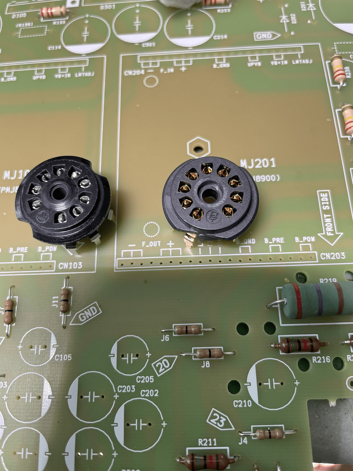

I just messed up my 300B sockets soldering and I was wondering if …

- Anyone has upgraded the stock 4 pin sockets? It seems there’s not much space between the board and the top plate so not sure if replacing those sockets is an easy task.
- Anyone knows if the Elekit 4 pin tube sockets can be purchased as spare parts. I asked Elekit and an European distributor about that but I had no response yet :/
Thanks a lot. Best regards.
Hello, @vkung .
I don’t want to replace them but I made some mistakes soldering them. Big solder drops melted inside the pin holes and I’ve been unable to perfectly desolder/clean them. Now the tubes do not fit in the socket holes :/ Rookie mistake.

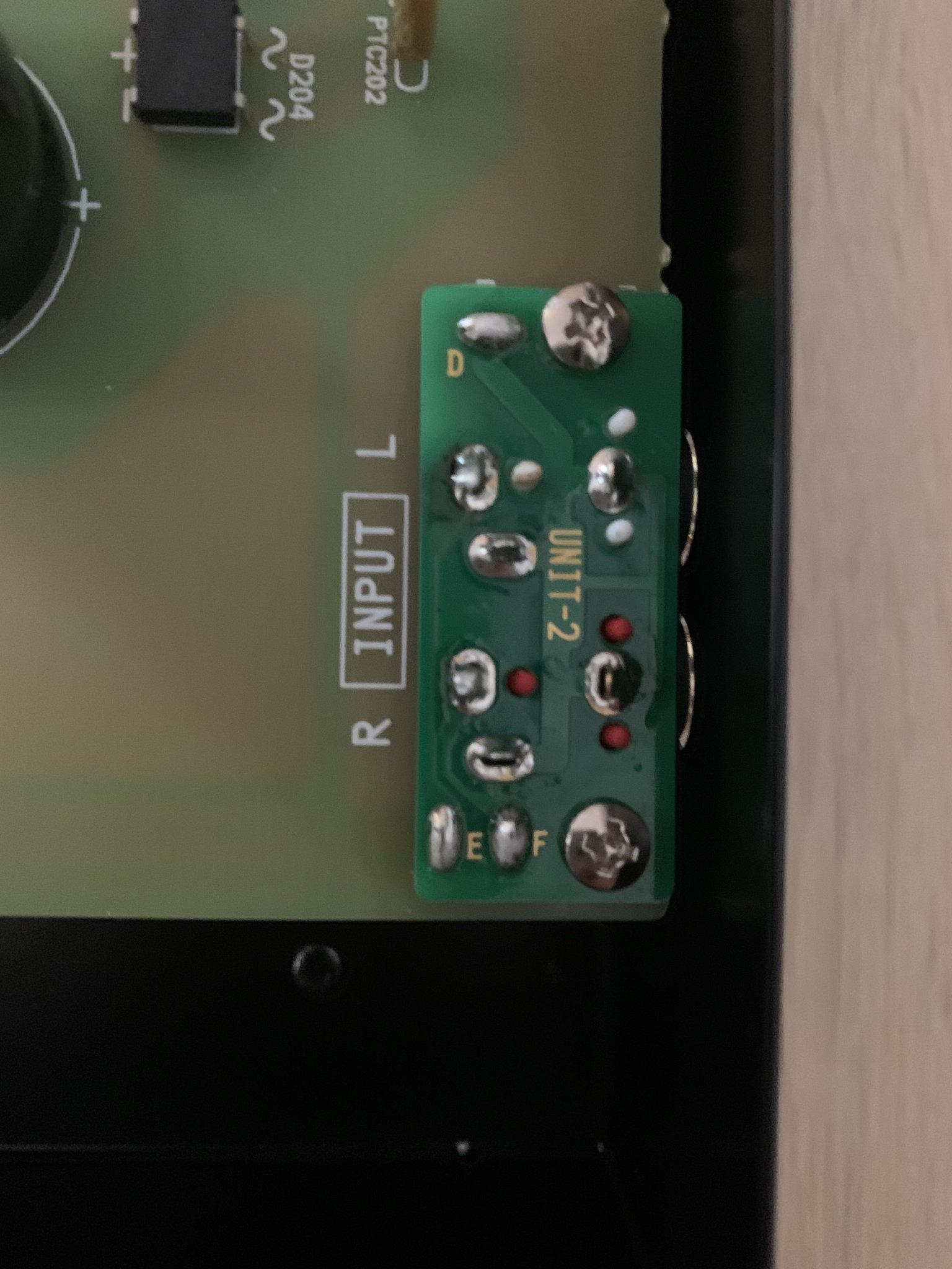

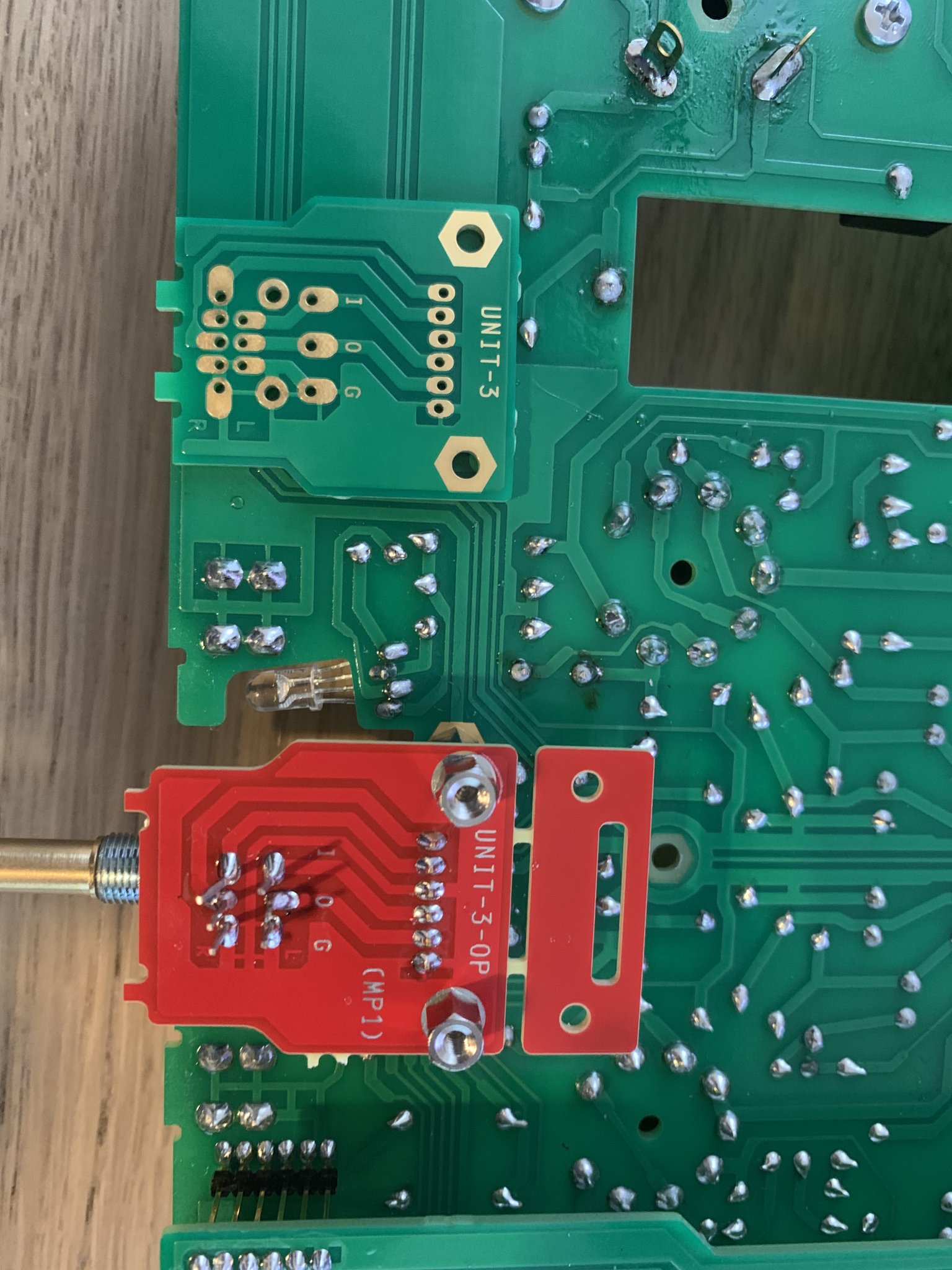

Hello, @findog3103.
I don’t think that is the correct volumen attenuator unit in a TU-8900 amplifier.
Mine is labelled as UNIT-3 instead of your UNIT-2. Also, the unit is not a square form like yours. It’s wider on the back of the unit exactly to avoid the issue you are facing.
See attached images of my UNIT-3 (volume attenuator) and UNIT-2 (RCA inputs).
Green UNIT-3 is the stock one. Red UNIT-3 is a mod I purchased in HiFiCollective.
Stock UNIT-2.
Hope it helps.

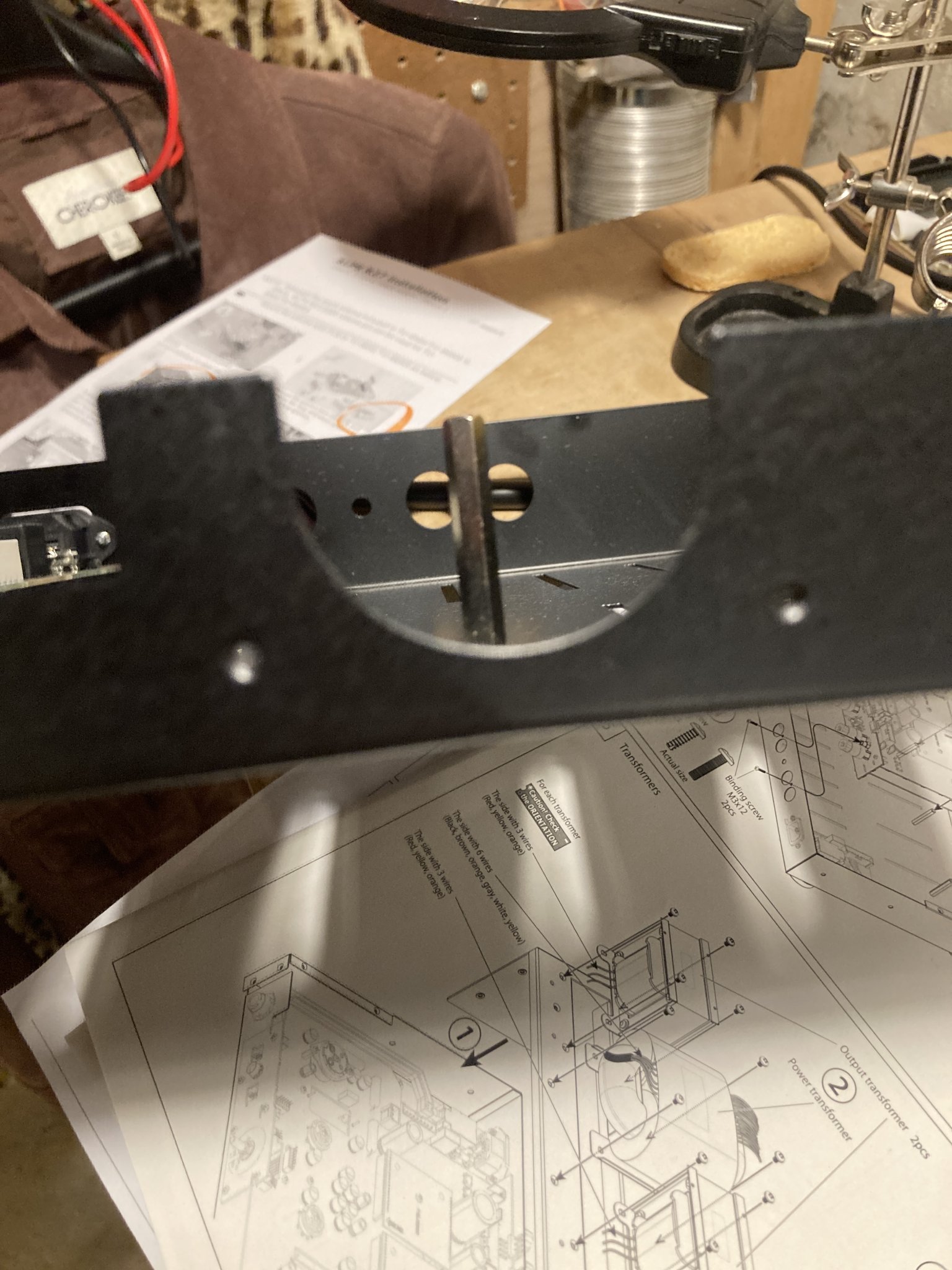

Fixed it. It just needed to be put on first before putting the volume plate on.Hello, @findog3103.
