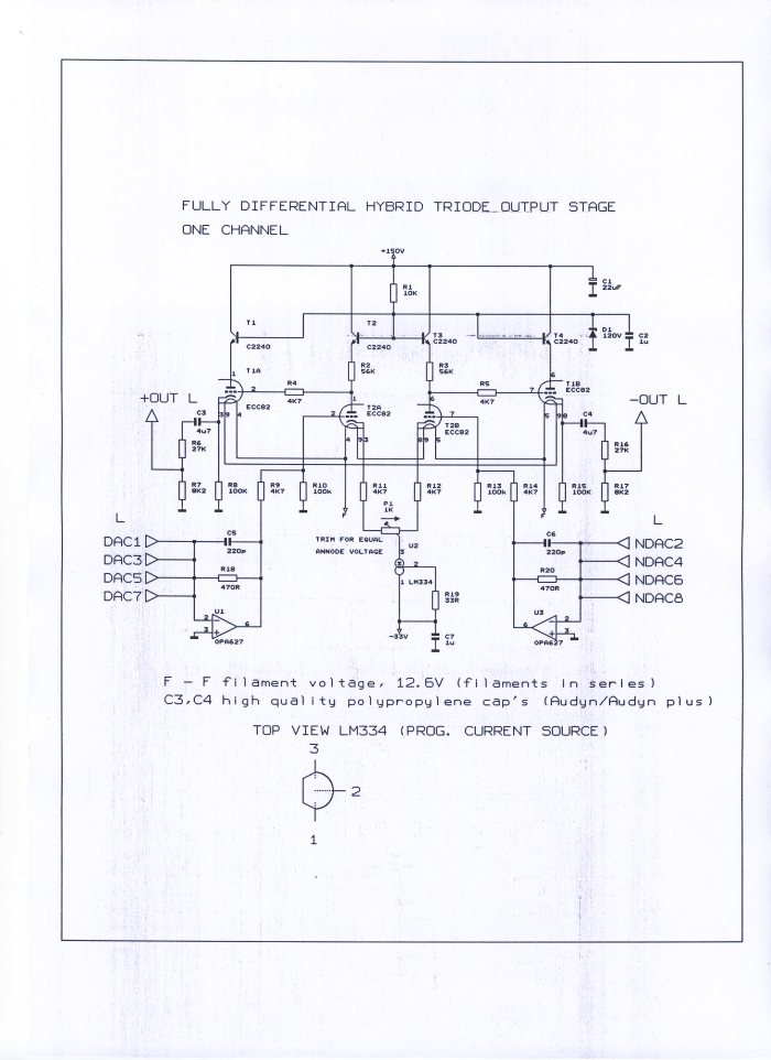

Differential hybrid output stage
Hi, all
When I started designing the output stage for the D-I DAC, I choose an all OP-amp design, with one of the best OP-amps available at this moment. But since High-end applications are often tube based, I wanted to give the tube output stage a chance. Personally I was very sceptic about this "obsolete" technology as (discrete) OP-amp specs are far superior according to their datasheets.
So here is what I did, I build both, a differential OP-amp output stage and a differential tube output stage, and connected them both to the octal D-I DAC. Making sure both output signals had the same amplitude, and oscillograms of the signal shapes looked the same. FFT scans looked similar as well. Now toggling between both during listening tests should solve the question, tube or "tubeless".
So the race was on, first the OP-amp (OPA627), sounded perfect to me, detail, midrange, bass all there in a perfect balance, open sound, what more do you want. Then I switched to the tube output stage
how could this be? The sound was even more open, midrange was warm, the sound was reproduced totally effortless, in fact I listened to it for the rest of the day, one CD after the other, without ever experiencing the slightest listening fatigue, in fact it is still playing right now.
The D-I DAC and the differential tube output stage seemed to be the perfect match. So for High-end audio applications, it seems the tube has caught up with the superfast semiconductor to put it in tubee's words. Is the OP-amp really that bad? no, the OPA627 comes very close to the tube sound, but just lacks that little extra, bass reproduction is slightly better (DC coupled). The tube output stage really brings music to life, so my choice is made. But since the differential OP-amp stage only uses 1 OP-amp, I am planning to put both in the octal D-I DAC, so it has the unique feature to toggle between both semiconductor and tube output stage.
I have added the schematic diagram of the differential hybrid tube output stage, so you can have a look at it. The transistors and zenerdiode are used to stabilize and isolate the annode voltages so the "hum" is deleted. The differential stage uses 2 triodes, connected to "buffers" (cathode followers). The LM334 current regulator fixes the current for the differential stage. The filaments are put in series (12.6V). As I mentioned before, the I/V stage still uses the OPA627. The output is fully differential! but if you don't need that, just leave-out the second cathode follower. The very high amplitude output signal is attenuated to reduce noise, together with cable capacitance it creates a perfect signal. Power consumption is very low. I am sure the schematic can be optimized / improved, but it sounds very good as it is now. For 2 channels you need 3 tubes ECC82 for normal output and 4 tubes ECC82 for differential output. Both C3 and C4 should be high quality polypropylene cap's (I used Audyn cap's). I am not happy with cap's in the signal path, but in this case I am willing to make an exeption 🙂.
WARNING: if you intend to experiment with this tube output stage, be very carefull with the high voltages. Always switch off and wait for C1 to decharge before working on the circuit (check with voltmeter). Also make sure there are no short circuits as this might damage the I/V stages.
Hi, all

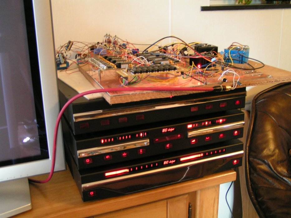

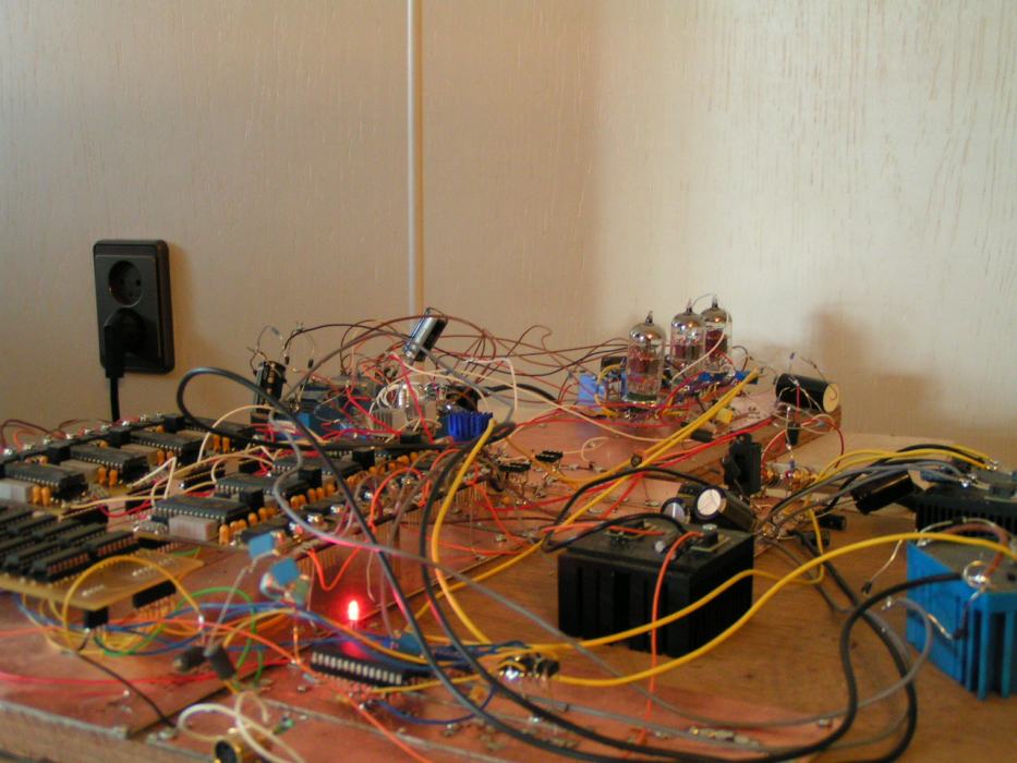

octal D-I DAC tube prototype
Hi, again
Well, this is called prototyping...As you can see it is time to develop both the main board and output stage REAL SOON as I am quickly running out of board space...🙂 . But this prototype has really fulfilled it's purpose. Now, just like me you must think there has to be a lot of crosstalk and interference with all those wires, well actually the output signal is kept very clean by using large amplitude signals that are attenuated at the output. (post#158). And where do these large amplitude signals come from? the dual 4 added DAC currents in combination with the OPA627 I/V converter stages, doubled by the differential amplifier!
Hi, again

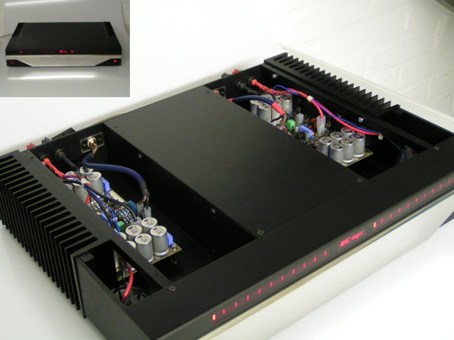

Photo cascode MOSFET power amp
Hi, MGH
Thanks for your reply,
I got the 74HCT161 from RS components, Farnell should have them too. The HC version is more difficult to find. If the project is fully completed, I will certainly use high quality boards as this D-I DAC really deserves them. Of course I will add a detailed step by step intruction of how to build this DAC.
I also added a photo of the cascode 2 X 70W rms MOSFET power amplifier that is placed in a black annodized aluminum housing with a 5mm thick high-gloss stainless steel front piece to match the design. I manufactured all housing parts myself (exept the stainless steel piece) with the aid of 2 computer controlled milling machines. The logo text is actually a circuit board being backlit by LED block's. The push buttons are made from red transparent plexiglass, the icons for the backlit power and light functions are also small circuit boards. The amplifier is virtually indestructible, it is designed to work without output relays or DC protection (so it can play the track "Bela Fleck, a Celtic medly" without the DC protection kicking in 🙂. It can be short circuited or the input plug can be pulled with full power. The photo isn't really good, but I hope you will get an impression of how the octal D-I DAC could look like. I am planning to put the 4 ECC82's on top and fully integrate them into the design, protected by aluminum or stainless steel plate construction. It would also get similar backlit push buttons for power, lighting, input selection and tube / semiconductor mode. If you switch to semiconductor mode, the tube output section will be shut down and the output is re-routed to the semiconductor stage with the push of a button.
Hi, MGH

I have added another picture of the octal D-I DAC prototype in "action"
Well, lets put it this way. If I am working on a project, I often forget about time and realize I worked trough all night.
Electronics can be so fascinating, electronics is all I got, it consumes all my time. It's a continuous learning process that is rewarded when things work out the way you planned. I am very gratefull of being in a situation to be able to do all this. By posting information about this project I want to share the thrill and exitement of electronics design.

Cool - the housing looks very professional and sturdy.
What's the difference between the 74HCT161 and 74HC161? Eitherway, HC version is very cheap (26 cents a piece) according to the site slimek provided.
BTW, will you be using the CS8414 or CS8412?

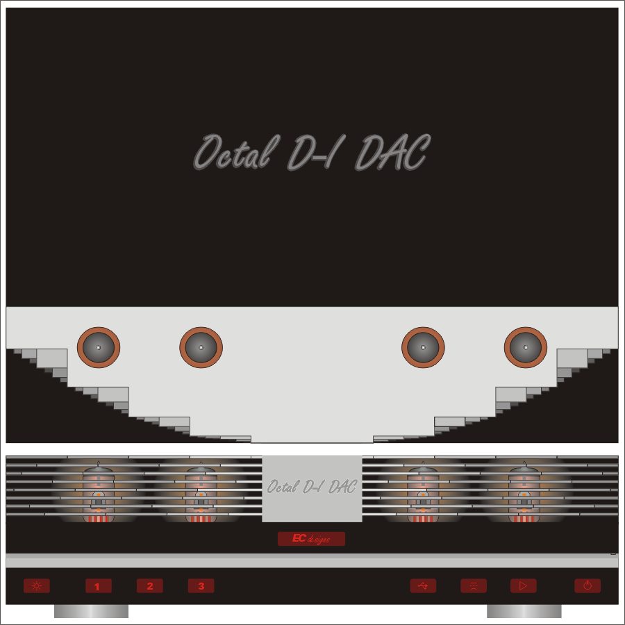

Housing / audio interface chip
Hi, MGH,
I already made some quick drawings of the octal D-I DAC housing, I will make a CAD drawing of it soon, so you get an impression. I need to do this now, so I can design the main board and addittional modules accordingly.
Basically the DAC is housed similar as the Power amplifier, but, on top it get's really different. I plan to make 8 half-sinewave shaped plates that look as a "low resolution" step signal. They are then arranged basicaslly in the same manner as the signals in the D-I DAC itself. So when looking at the top, you see a high resolution sinewave, sideways you see the coarse shaped sinewaves. These plates also function both, as protection and screening of the 4 tubes. When you look at the DAC from the front, you see the 4 tubes trough the 8 horizontal plates. In the centre of the sinewave shaped plates that extend over the entire width of the housing is the logo. The sinewave plates would look awesome when made out of thin high-gloss stainless steel plates. The housing itself has all the backlit switches, and status indicators. I also plan to use a stainless steel plate on the frontpanel (similar to the power amplifier) to match the design. On the rear there would be connections for power supply, differential L and R outputs, 4 differential SPDIF inputs (SVHS socket), 4 coax inputs, a USB input and a (differential) I2S input.
The HC question is already answered,
I use the Crystal CS8412 audio interface chip. But since the audio interface is modular, different chips can be used like CS8414 (adapter socket) or DIR1703 with twin PLL system. I tried the DIR1703 in the past, it had a very stable output signal, but it is very sensitive to interference signals (it would immediately lock-out).
Hi, MGH,

Octal D-I DAC sketches
Hi, MGH
Thanks for your reply [#219]
>The speed of logic circuitry becomes critical when the design is timing critical. In a critical design, these speed differences can cause circuitry to "trigger" at the wrong moment or causing erratic timing. BCK frequency is 2.8224 MHz / 354nS, a low or high level is 177ns. So if the logic used has equal then or more than 177ns you're in trouble. The HCT has a propagation delay of 20ns, the HC 15ns. So with both chips we are quite "safe".
>So why do I prefer higher speed? Suppose you have a slow logic circuitry in the SPDIF signal. Transients would look like ramp's rather than the ideal "vertical lines". Now suppose the SPDIF receiver schmitt trigger input circuitry threshold voltage varies a little bit, it then would trigger on different levels of the ramp shaped transient. So phase variation occurs, also called jitter. This is one of the things that is happening with optical SPDIF interfaces as they have lower speed / ramp shaped transients. So basically, slow ramp shaped transients are an invitation to jitter.
>Modern major brand power supply regulators, when used correctly, are not bad. They are cheap, produce a quite stable output voltage and by adding decoupling cap's of the right value close to the regulator you end up with a good power supply. Zener diodes are a bit of a problem (dissipation and power supply regulation) as TDA1541A supply currents can go up to 50mA. Bandgap reference diodes (LM336-5.0) are quite good but the maximum allowable current is only 10mA. So for the moment I will keep the existing regulators.
>The current DAC circuit board is designed with decoupling and suppressing interference in mind. Each DAC chip has it's own power supply, Each DAC chip has a separate analog and digital ground connection, tracks are kept very short. Analog main board design has to be done very carefully to get the lowest interference possible. I am also planning to put all digital modules on a separate digital mainboard. I use a dual stabilizing method (cascading regulators) for stable output voltages. For decoupling, tantalium cap's seem to do a good job in filtering out interference, ceramic SMD capacitors take care of the very high frequencies (tantalium cap's are horrible for analog audio applications, but quite good for power supply decoupling, and they remain stable over time). Even with the worst-case test setup I used, the output signal is very clean. The sound is so good, it is very difficult to "switch off the set" once you start listening, so that is one of the things I have been doing the past days, the other "thing" is attached to this post, hope you like.
The upper sketch is the top-view of the octal D-I DAC, showing how the 8 coarse protection and screening plates form a "smooth" half sinewave shape, reflecting the operating principle of the octal D-I dac in the housing design. Text is engraved in the aluminum plates.
The lower sketch is the front view, status indication is done trough orange LED's behind the 4 tubes. When warming-up the LED's flash, if the SPDIF signal is received correctly, the LED's spread a orange glow around the tubes. Using high-gloss stainless steel plates would give wonderful effect.
Hi, MGH
