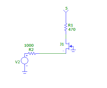

I will certainly try this super simple I/V, with digital volume control. With 2SK170-BL. There will always be enough current on the JFET if using digital volume. For example there will be 1mA if a peak reaches -6dBFS (this will rarely occur).
The current source I1 is just a representation of the DAC chip. Just connect the JFET source to the output pin of TDA1541, nothing else.
The advantage is constant current draw on the regulators, lower apparent R seen by the DAC (on the order of 40 ohms) and a slightly larger I/V resistor possible. The +5 is the signal ground now.
Since the output pin of TDA1541 can swing slightly more towards the positive than the negative without protection diodes conducting, the 200mV is no issue, it is actually closer to the "center" than 0V.

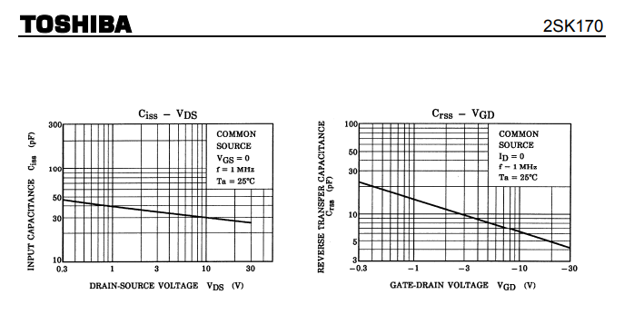

Even though the capacitances between source pin and grounded gate (roughly equal to Ciss below) and between drain and grounded gate (equal to Crss below) are variable (with signal), I believe their -3dB cut points will be well into the MHz range in this application. It certainly simultates a quite high bandwidth.
Final remarks. This is for use with digital volume only. Where the signal will rarely, or never, exceed -6dBFS. The signal ground is +5. Taken right from the terminals of the I/V resistor in an actual implementation. You don´t want to use 0V as your signal ground because the regulator+decoupling combo becomes your coupling capacitor.

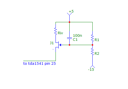

You may be right. See below, the fet gate is now tied to the true signal ground (+5V) by means of the 100nF cap, and it is possible to set the source to 0V, or slightly more if it gives a better result (the "center" for lowest distortion seems to be a bit above 0V).
The bias resistor suggested by triode_al is not needed if you are using digital volume control. For me the worst case signal peak would be -6dBFS or less, which leaves more than 1mA for the fet to operate (it doesn´t get close to pinch off).

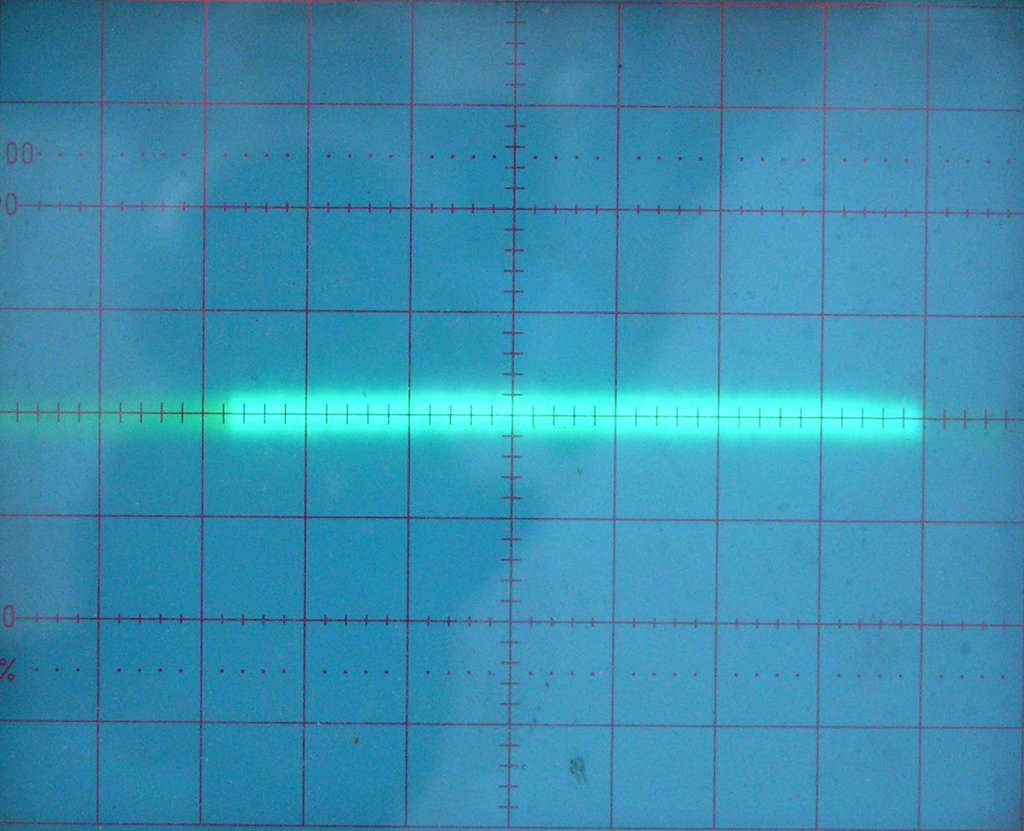

Hi esgigt,

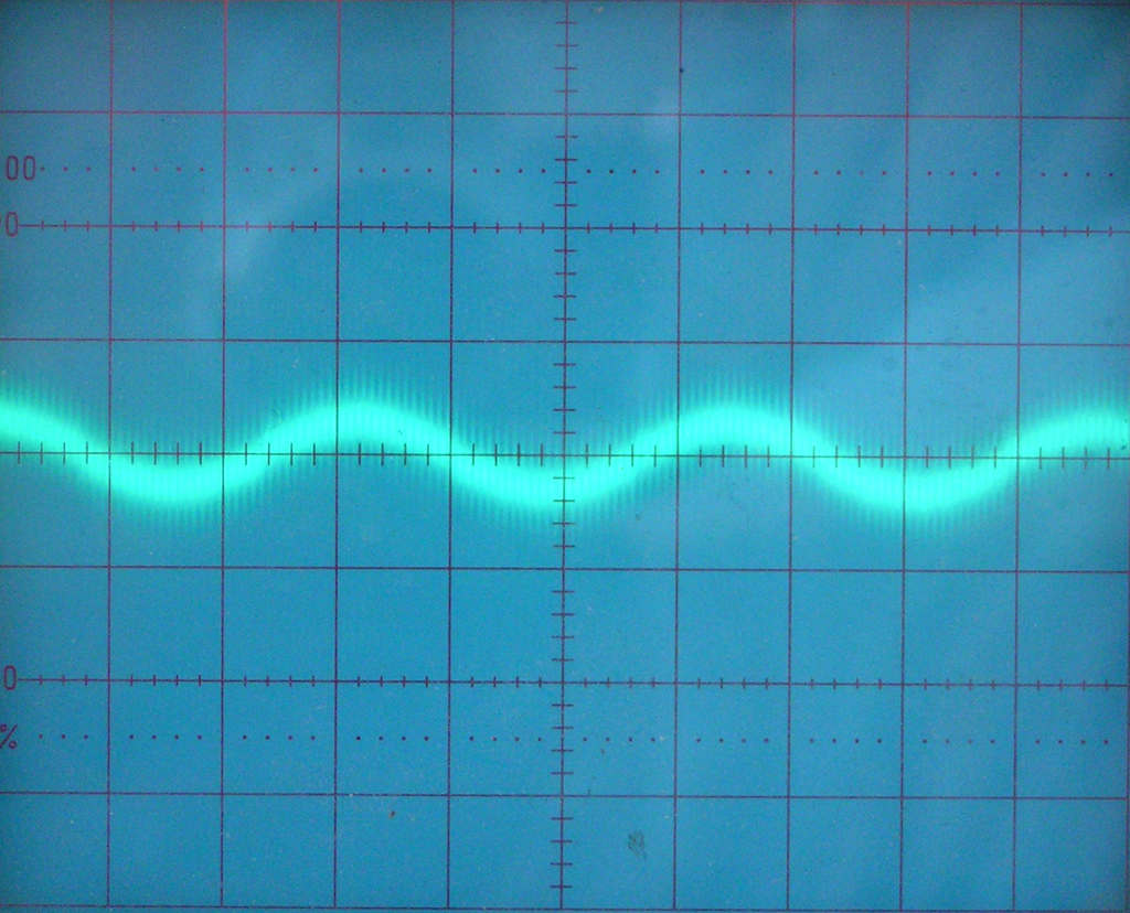

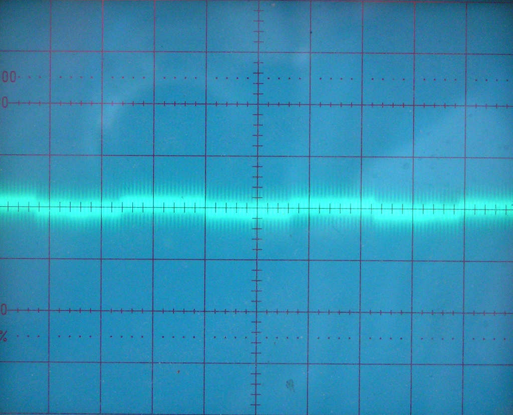

I attached oscillograms of a TDA1541A running in simultaneous mode (pin 27 tied to -5V) with 25% data density and 50Hz DEM, NOS (44.1 KHz, 16 bits). Passive output (150 Ohms I/V with 2K2 bias resistor connected to +5V) amplified by a simple pre-amp.
The output is unfiltered!
It is a worst case air wired setup that can be significantly improved when moving the parts to a decent PCB.
I use plain 78XX and 79XX voltage regulators so nothing special. DEM decoupling caps are 100uF/25V Nichicon UKA. DEM timing cap 1uF WIMA pitch = 2.5mm. Bias resistor between pin 15 and 17: 12K 1%. Plain-A chip. Attenuated digital interface signals (2.4Vpp), 1K series resistors on BCK and data signals to minimise ground-bounce.
Source: iMac running Swinsian (bit-perfect playback verified). Toslink interlink (1.5 meters), DIR9001 receiver (50ps intrinsic jitter), discrete protocol converter that converts 24 bit Left Justified to Simultaneous (same circuit as in my post).
Scope: Philips / Fluke PM3065, setting 2mV/div, probe 1:1.
First picture shows a -60dB, 1 KHz test signal.
Second picture shows a -70dB, 1 KHz test signal.
Third picture shows a -80dB, 1 KHz test signal.
Last picture shows -90dB, 1 KHz test signal (96dB is the limit for 16 bits). So the LSB is clearly resolved and remains above the noise floor!
There are tiny spikes visible on all signals, this is the 16 bit data burst followed by a 48 bit silence period of the protocol converter (unavoidable TDA1541A on-chip crosstalk). With I2S we would have continuous noise super imposed on the signal and the trace would appear 3 times wider on the scope because of this switching noise.
When viewing closely you can see slight MSB distortion (remember this is a plain A chip!) that will be inaudible under practical listening conditions.
One can argue about this and that, but these measurements speak for themselves.

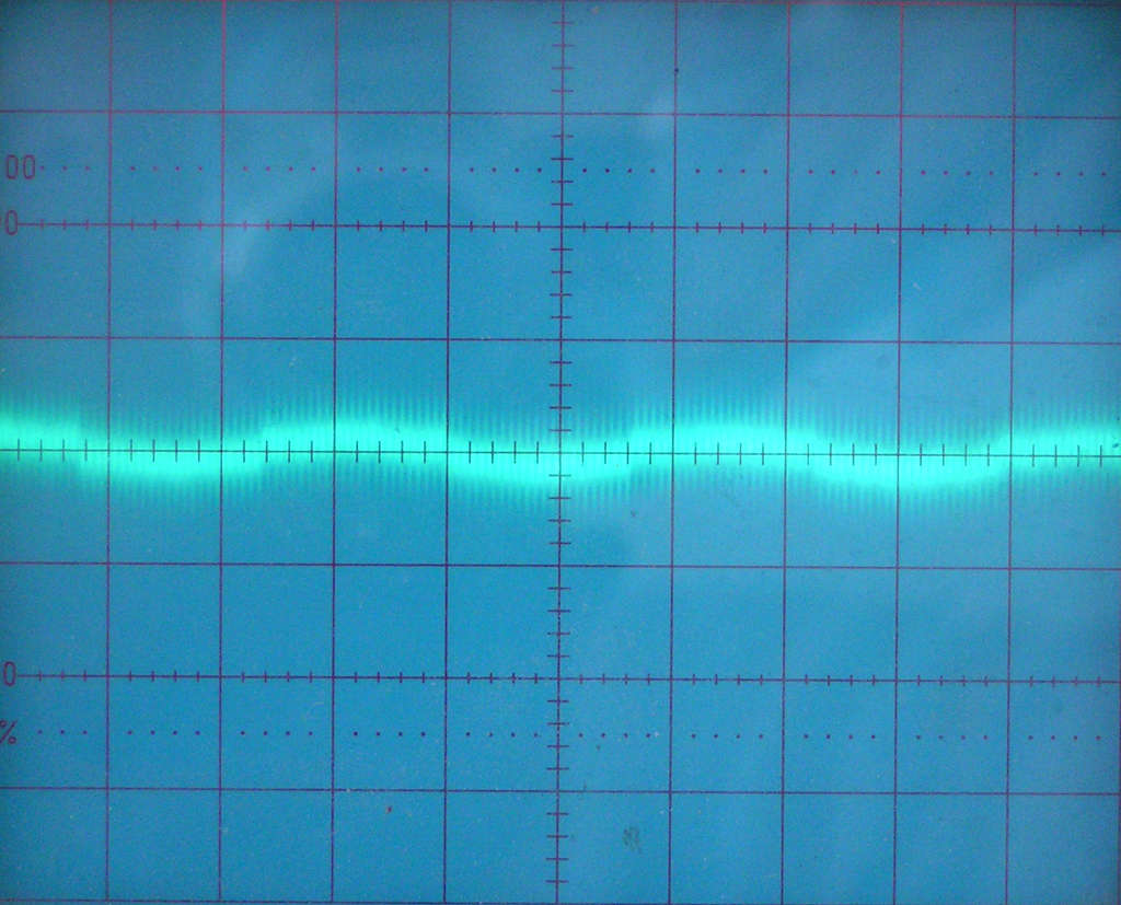

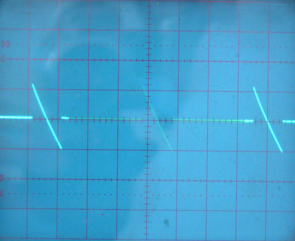

Hi esgigt,
And here are the oscillograms of the DEM clock (1V/div, 5ms/div) and 50Hz DEM ripple on one of the 14 active divider decoupling pins (2mV/div, 5ms/div).
The brightness fluctuations are caused by the low scope scanning frequency and the exposure time of the camera.
The DEM repetition rate is roughly 4 divisions, 4 * 5 = 20ms 1/0.02 = 50Hz.
Decoupling caps, 14 x 100uF/25V Nichicon UKA, plus connected to GND. DEM oscillator timing cap 1uF/50V WIMA r=2.5mm. Bias resistor 12K 1% between pins 15 and 17.
