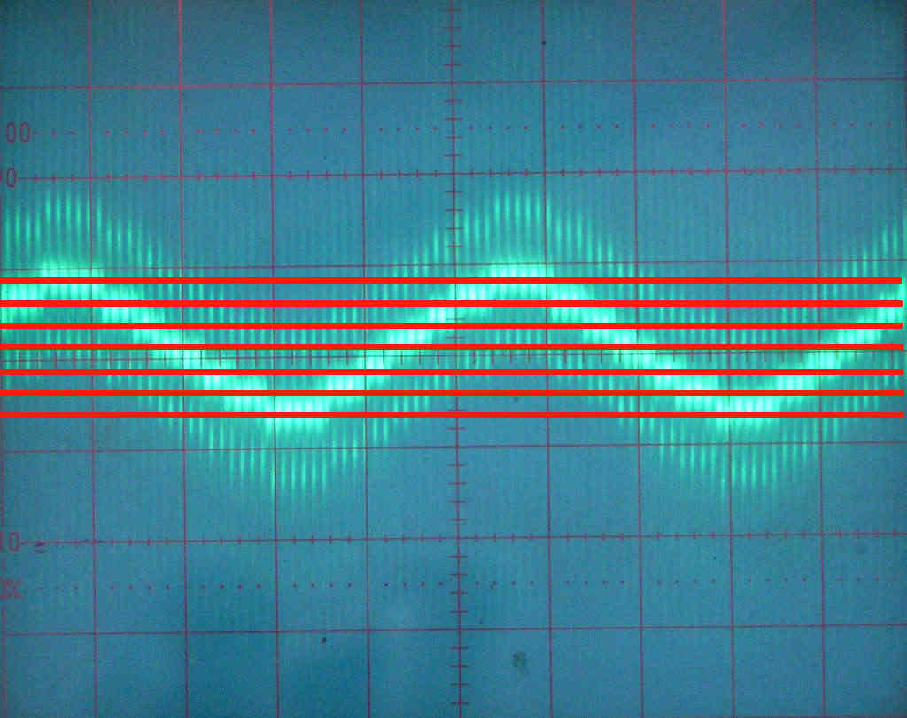

It can be seen from them that the 1541 responds confidently to the signal at the level of -80 dB. True, the sinusoid turned into a triangular saw.
There are only a few bits to reconstruct these very low level signals, then rounding errors will occur. The smaller the signal, the larger the rounding errors.
I have drawn some lines matching the 7 voltage levels that form the -80dB sine wave (or better a coarse approximation of it). I can see no disturbing linearity errors here. The signal passes a pre amp based on a single NJET hybrid semiconductor I developed. (I amplified the voltage across a 75 Ohms passive I/V resistor).
The shape of the signal is dictated by the audio file. It is rounded in a specific way, it could be rounded differently and this may or may not result in a better looking sine wave. But like I said, this is the -80dB signal generated by that test file.
When you look at the -80dB oscillogram (post #6098) from a conventional TDA1541A application with simultaneous interface we can clearly see linearity errors. These no longer occur with the segmented application using the same chip with the same tolerances. Both are running on a 50Hz DEM clock.

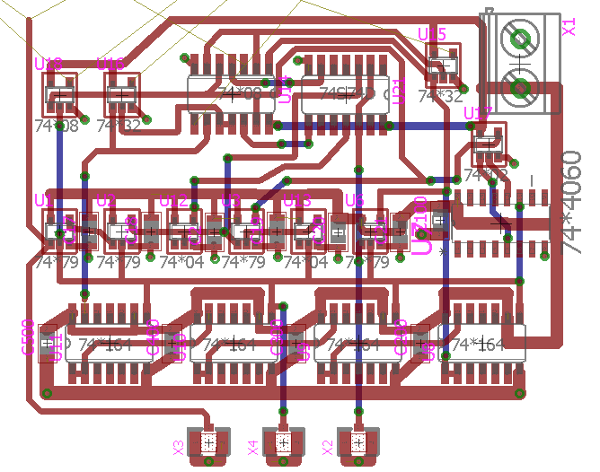

I2S-TDA Board
Here is the first draft of the I2S->TDA board based on the John's schema.
I would welcome any feedback and advices on the layot. I'm not a professional pcb designer and this is actually my first board of such complexity.
I'm not particullary happy with the top part of the board but it is the best I can do at the moment.
Thank you,
xaled

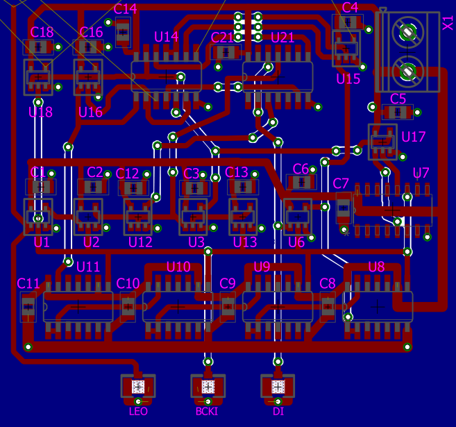

Hi xaled,
For a first PCB it looks very good. It is good to see that some DIY audio members take the initiative and design and build something.
Don't forget the ground plane.
The most difficult part of PCB routing is component placement. When the components are placed optimally you are already half way. Also place mounting holes before routing, these are often difficult to add after you have completed routing.
With more complex designs it helps to have the majority of traces on the component side running horizontally and have the majority of traces on the solder side running vertically.
You can also swap pins (gate inputs) to simplify routing. This in turn can have an effect on component placement.
Try to avoid running traces underneath decoupling caps. We usually need small (805 size or smaller) caps for effective RF decoupling. These are too small to run a trace between its pads.
Try to route the power supply traces first as these are most important. Think about where the (large) currents flow and what impact this will have on local supply voltages. It would be ideal to run the Vdd supply trace on one side and the Vss return trace on the other side underneath it. This way EM fields cancel and you get far less interference on the board. Again this is not always possible when routing a 2 layer PCB.
Continue with the signal traces. In this specific design the LE signal quality is of utmost importance as it controls sample timing (simultaneous interface). Try to keep it away from noisy signals like data and BCK for example.
After connecting all nets one can try to reduce via count (except for via's that are vital for correct operation). This will force one to reduce lay out to its most effective form.
The current divider in TDA1541 with the DEM generator turned off ensures the accuracy of division at 1-2%. On the oscilloscope screen, you can not see the non-linearity of about 1%, at best at 5-7%, usually at 10%. Therefore, your picture is completely useless for evaluating linearity. The spectral method is much more sensitive.

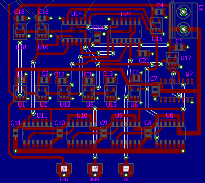

Thank you for the compliment. It is nice to know that even the initial draft is not so bad 🙂.
I updated the board as far as I could according to your comments. Ground plane was there already, but it did not show up for some reason in the first picture.
I would appreciate any further comments that would help improve the board.
