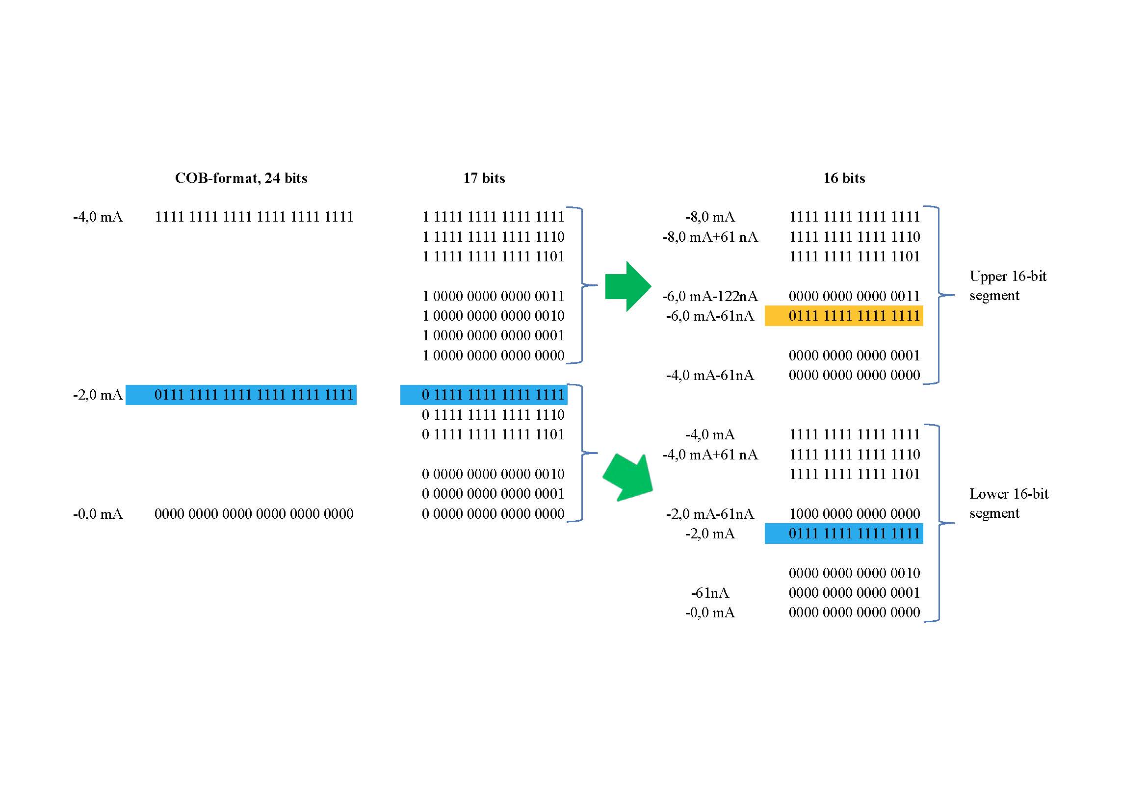

Hi everyone,
I thought about the 17-bit DAC at leisure and, I think, found a solution.
As I wrote to colleague Alexandre, the solution of the problem is not in the plane of the software solutions, but in the plane of the "iron".
It is necessary to add to the output current of the upper segment 4 mA (more precisely: 4 mA + 61 nA). This is the key moment!
Due to this, in both segments, the output current of the TDA1541 will oscillate with an amplitude of +/- 2 mA, and the total current of the two segments will vary from 0 to 8 mA. Moreover, the high-order bit is used to determine which segment to submit the input data, after which it is deleted and does not enter the input 1541. Thus, we use information from all 17 bits. But information from the MSB is used on the analog side.
In the picture I tried to schematically depict the conversion of the input 24-bit code. First, from the 24-bit input signal, 7 low-order bits are cut out. The MSB is then analyzed and deleted. The received 16-bit signal is fed to the TDA1541 of a particular segment (upper or lower), depending on the value of the remote MSB. To the output current of the TDA1541 of the upper segment, 4 mA (current shift) is added.
At whom what thoughts?
Regards
Serg
Serg, I stand by everything I posted. It is all correct.

Serg,
The problem needs to be solved in hardware. It is not solved purely by software.
If you want to take full advantage of the 17-bit segmented dac you need the combination of hardware and software. I am talking about the best solution here.
This is not very important. And then, dithering is more often used for ADCs.

Hi Alex,
Yes, you need to combine a software and hardware approach. But so far, a purely programmatic approach has been proposed, but it does not solve the problem.

You again offer a purely software solution. Nothing good will come of it.

The 17 bit segmented dac has always included glue logic, from the very first post by John.
Please indicate the message number where the current shift for the upper segment is proposed.
When John posted the segmented dac idea...
This is an old idea, long ago realized in such DACs as PCM1704 and others. John tried to mechanically transfer this idea to TDA1541, not understanding the limitations of this chip.
Serg, here it is.
Also, please take notice of the two zeros at bipolar zero. That is, one of the segments needs addition of 1 LSB, otherwise there will be a repeated code at the zero crossing. The logic has to take care of this.
The last detail is when the 17 bit input is all ones. The logic should not add one lsb to this particular code.
You demean the valuable and intelligent input of John and mine as well. Please stop doing this to your colleagues.

Actually I had already noticed the need for addition of 1 LSB to one of the segments
This is not about adding 1LSB, but about adding FS. And this addition needs to be done on the analog side, because there is no other way out.
And in my thoughts was not. I'm just trying to protect him from error.
Serg, you are wrong, the problem can be solved entirely in the glue logic that precedes and controls two TDA1541 channels.
On the analog side you just connect the two current output pins together and proceed as usual.
I will stop repeating myself now.
-Alex
It seems to me that your concern is not being able to HOLD one channel at the correct value while the other increases the count?
I assure you this is perfectly possible. These old school dacs have no internal processing of any kind, whatever code you input will be passed to the registers and DIRECTLY control each bit.
The original idea as posted by John is sound and valuable.
I´m fine Serg. A bit tired of repeating myself.
I use bold and uppercase to highlight the most important words. To make it clearer, better understood.
Do you understand now? You can hold one channel at zero, or -4mA, just by holding the code at the channel input. There is no need to do it on the analog side.
-Alex
I do not agree, Alex. Without adding 4 mA on the analog side, the upper and lower segments will change the output current in the range 0 ... -4 mA. But it is necessary, that the current of the upper segment change within the limits of -4 ...- 8 mA. After all, the segments work in turn.
